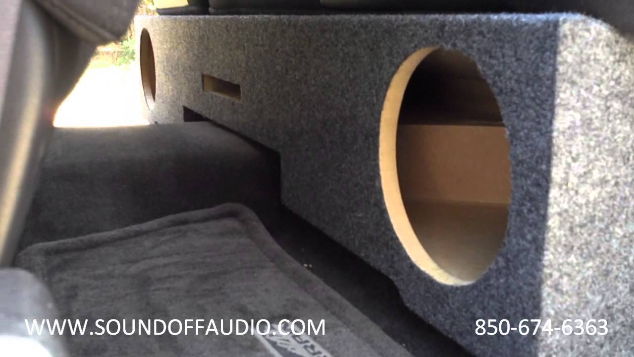

See here, the hump's height increases as well as its width.
See the inside of this box? That diagonal surface is to clear the hump.
Also see this for the bottom of the box.
Now, the 99 to 06 enclosures are not as bad. SOME companies make them the same, with a different front/vertical piece, as the newer models have a taller hump.
The hump height is about doubled in the 07 to 13s. But the fronts are about the same width.

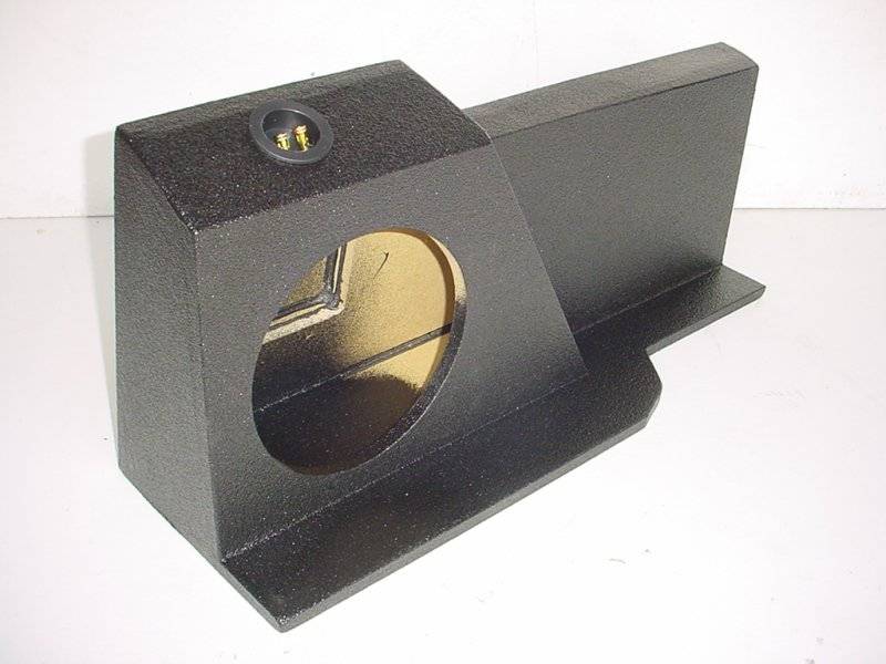

Heres a 99 to 06 box.
Doesnt need to clear that big hump.
