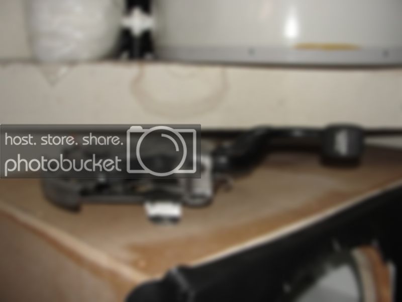

Not too much more but finally got the passenger horn about as good as it will get.
New mount

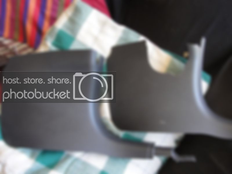

The kick panel needed to cut.. luckily I had an old one laying around..
It can't get too much further over... maybe .75" if I bend the connectors

I got around to finishing up the drivers side horn. I manned up and removed the parking brake. I thought it would be a lot worse than it was. It was just 3 bolts and a little bit of muslce to remove the cable from the unit. Sound stage seems immediately fixed, will update with how it is in a few days when I can drive around more. Didn't get many pics, camera was dead but here it is finished. This is the stronger mount to date for the horn, I could literally kick the horn hard and it wouldn't budge. Also I know for a fact I could go to full body horns... so that may be in my future.
