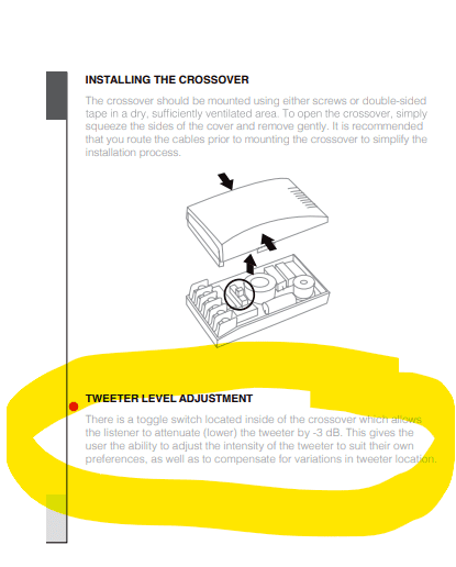

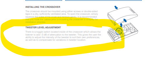

The reason I didn’t go with the X series and went with the V was because the former doesn’t have a tweeter adjustment in the passive crossover. My tweeters are mounted on the upper part of the door near the sail panels so I prefer a -3DB option since they are closer to my ears, than the mids. If you’re active, you don’t have more options
"X" series is adjustable-
As are the "V" series-
And if you're active, you are using an electronic/active crossover on the amp or DSP/EQ/Crossover and will have much greater control versus passive.
