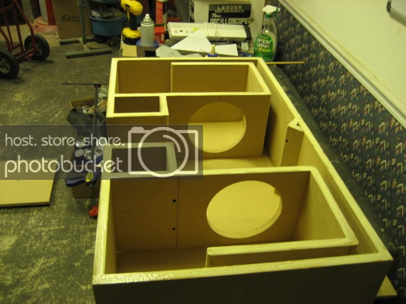

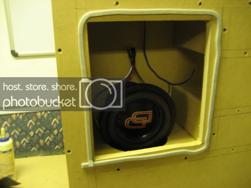

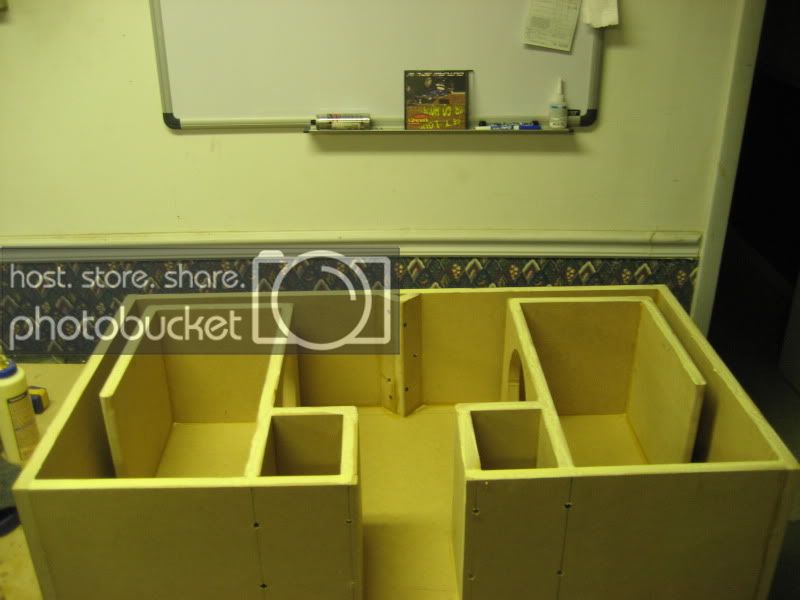

Here is a series tuned 6th order I designed and built for 2 DD1508's last week:
That's interesting to say the least. I'm a tad bit confused as to how it's a 6th order though. I usually picture 6th orders as a sub firing into two chambers, each with a port. This looks more like an 8th order? The one chamber's port actually fires into another ported chamber, that's an 8th order right?
