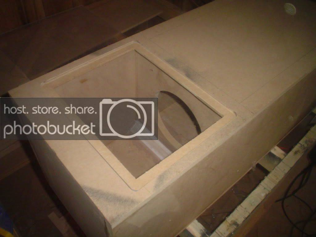

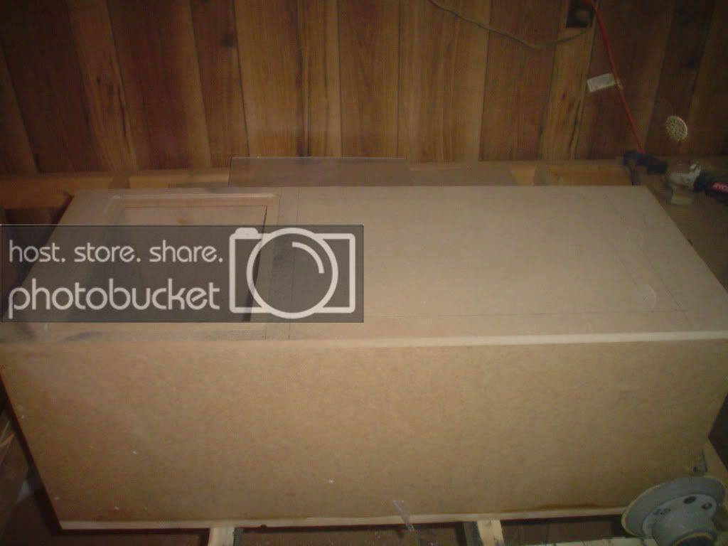

very nice building skills..it should workout well...but dam u got that box up quick..lol

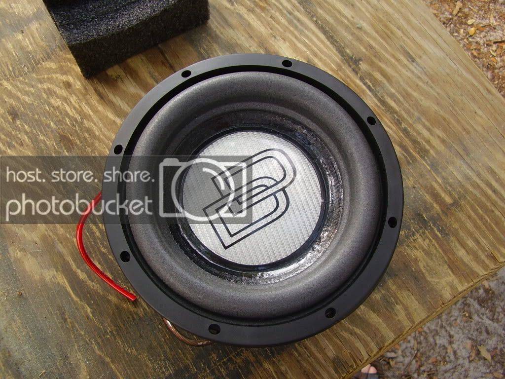

this is the sub thats going in this box
and it will be getting power from an mtx81000d.
iam into 1 sub, high output systems and this should deliver very well.//content.invisioncic.com/y282845/emoticons/smile.gif.1ebc41e1811405b213edfc4622c41e27.gif

tis for me, i took your suggestion, had 80 come up with a design and mr. ninja to do the build and i should get to enjoy it soon.//content.invisioncic.com/y282845/emoticons/biggrin.gif.d71a5d36fcbab170f2364c9f2e3946cb.gif
