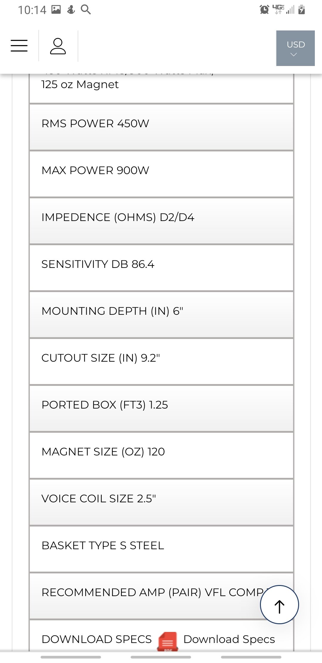

Well, I'm an AB fan. So, I just bought four of these for my standard cab Dodge. 600 rms, mounting depth of 5.4", and 120 oz. Magnets. The original VFL8's (yellow ones) sound really good as well.
Well, I'm an AB fan. So, I just bought four of these for my standard cab Dodge. 600 rms, mounting depth of 5.4", and 120 oz. Magnets. The original VFL8's (yellow ones) sound really good as well. View attachment 25696View attachment 25697
I wouldn't be able to run 4 of those 8s ported they need a .75cube each and I can only give them .5cube.
My box fell out awkward. 3 6.5 fit perfect but I cant stand dealing with ohm loads and multiples of 3.
1 8 has too much airspace and 2 not enough.
Even with the 28s sealed the box is a touch large but not by much, same with 2 6.5ported just a touch big but not by much

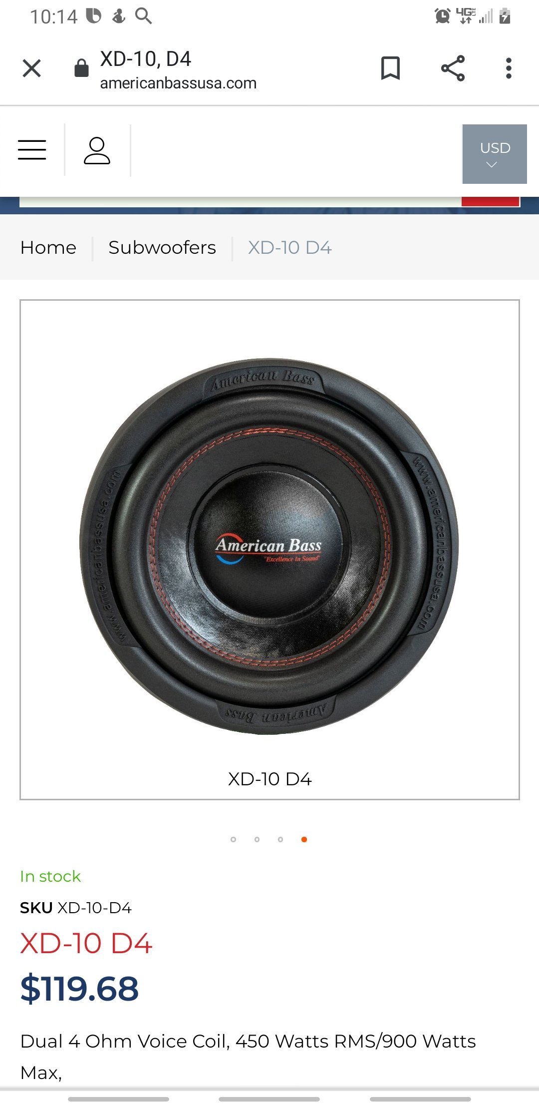

So, go with two 8's sealed and shrink the box slightly. Or, maybe one of these will work. Mounting depth is only 6".
View attachment 25698View attachment 25699
