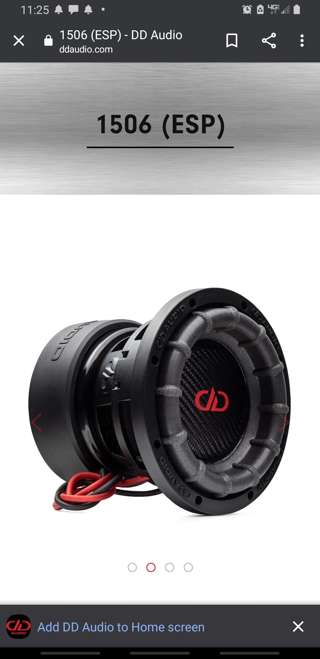

Yea I'm still looking for a dealer that has the dd1506 instock. I don't have the time to wait on them to ship. I do know where a few sundown sa6.5 are but iirc they were the wrong ohm load. And the sa are significantly less sub that the dd1506.

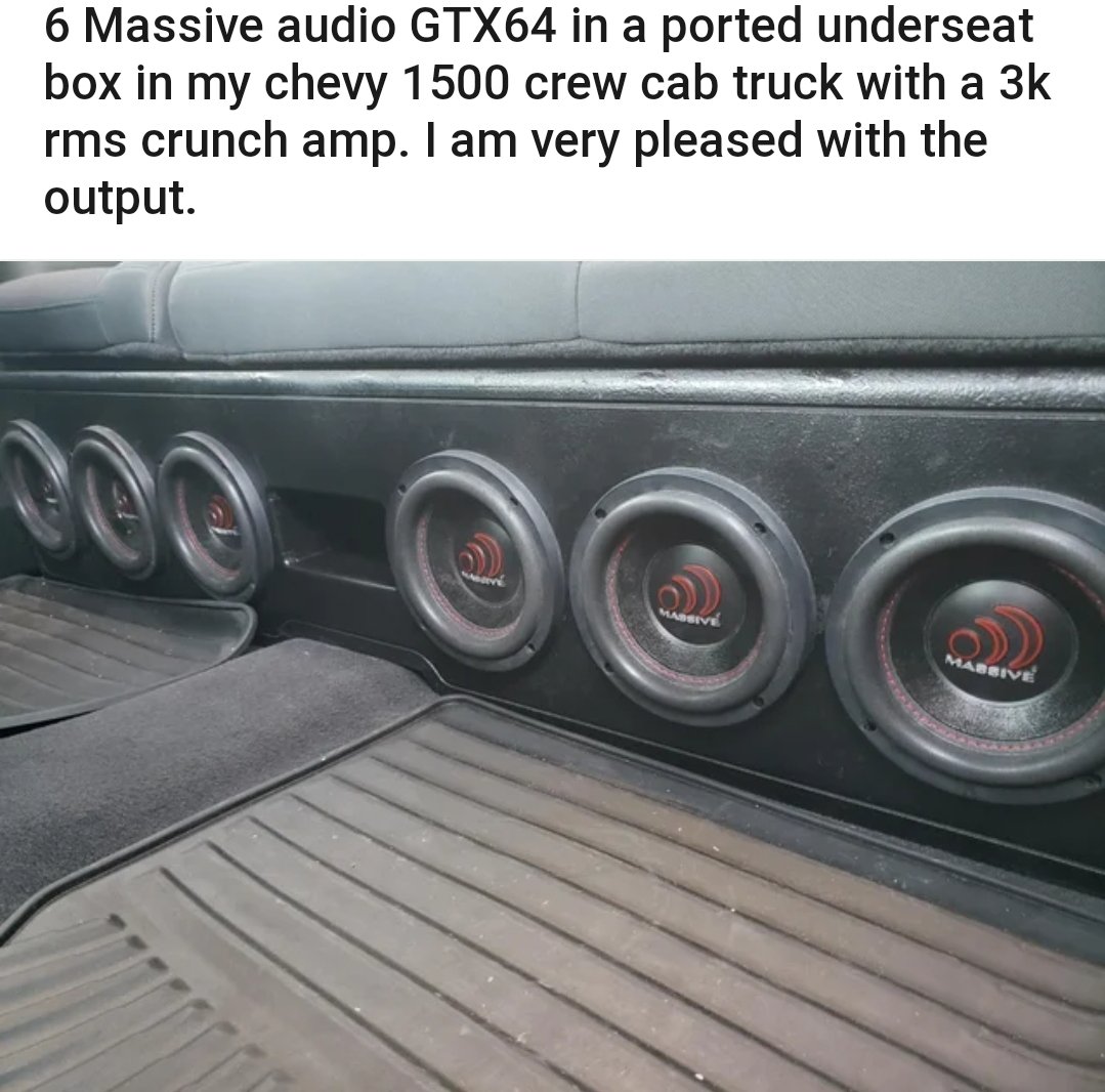

The ported DD 6.5s can be pretty impressive...I was running 4 in my Saleen Mustang on 1500rms and you couldn't hardly sit in the car . After I did demo's at a car stereo show with the whole car shaking during strong bass songs..I popped the truck to show off the setup and the expressions on peoples face were priceless ..one guy that sat in the car thought I was running a couple of 12s in the trunk ....he was really shocked ...to see 6.5s ...it makes me want to do something else with 6.5s again lol

These look pretty nasty, but might be too pricey.
DD1506, the box recommendation is .25-.75 ported.
They aren't pricey when you consider they are American made not made overseas.
