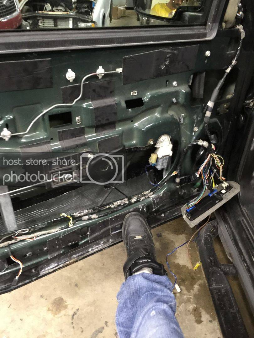

Id take off your door panels. Look at what you need to seal up. Deaden your doors first.
https://www.sounddeadenershowdown.com/
That site has all the info you need. Worth a read. They also have the best deadener around as well. Its been tested.

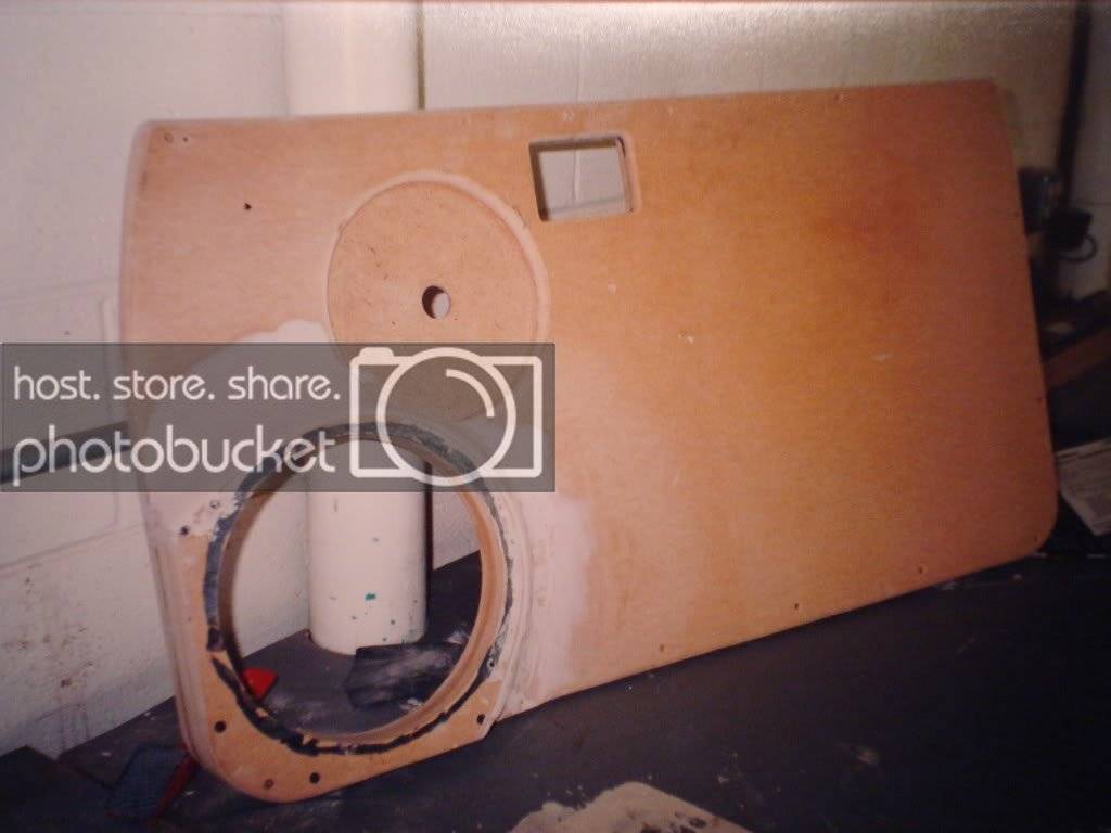

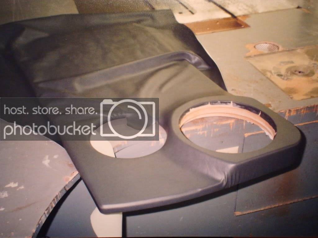

So say I go for 10s. How the hell do I get them to fit my doors correctly? Lol
It's a job, for sure. I have pictures somewhere. I completely removed the old door panel and made a new one from MDF, Bondo, vinyl, tweed, relocated the window track back by about an inch, etc... but you can also mod your existing door panels with fiberglass as mentioned. You can also make attempts to create a sealed or aperiodically damped enclosure so that you're not relying on the volume of the door and such.
Also, the head you have is fine for the job if you get creative and have amplifiers with decent crossover sections. It's an old school approach but I believe you could do it something like this; If you run the head in two-way mode you should be able to direct the "front" outputs to a set of components and highpass them with your amplifier/head as applicable. Send the "rear" outputs to the set of 8-10" in the door and bandpass those with your amplifier/head as applicable. Send the "sub" outs to the sub.
You can still do time alignment and EQ with the head but crossovers will be tricky. You'll need to see what your amp can do vs what your head can do and don't double up on that, use one or the other. I would shoot for crossover points in the neighborhood of below 40-63Hz for sub duty, bandpass your 8" or 10" using 40-63Hz through 200-300Hz, then hand off 200-300Hz and above to the set of components using the passive crossover between the tweeter and mid. A nice set of 4" - 5.25" coaxials would be the best in this situation.
I used to do this all the time and that was back when we didn't have much in the way of time alignment. Back then if you wanted imaging, you placed the drivers accordingly. lol
