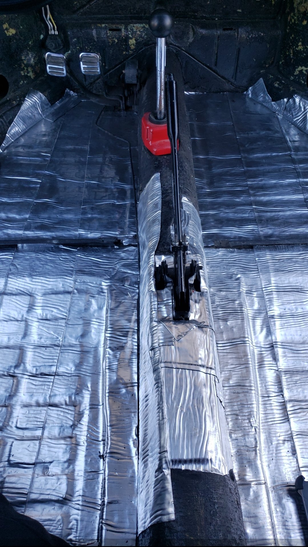

And, I never washed it. I always used the spray detailer stuff and wiped it off. It had a single 15" on a 3K and pounded. Sound deadened from floor to roof, and even the front hood. It was nasty for a car with a 95 amp alternator. Just sayin. I was proud of it.
