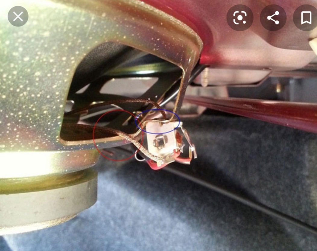

Are the rear speakers stock ...some corolla owners are having a problem in the picture where the rear
speaker wire is grounding to the basket bit id think they would quit playing also ...
