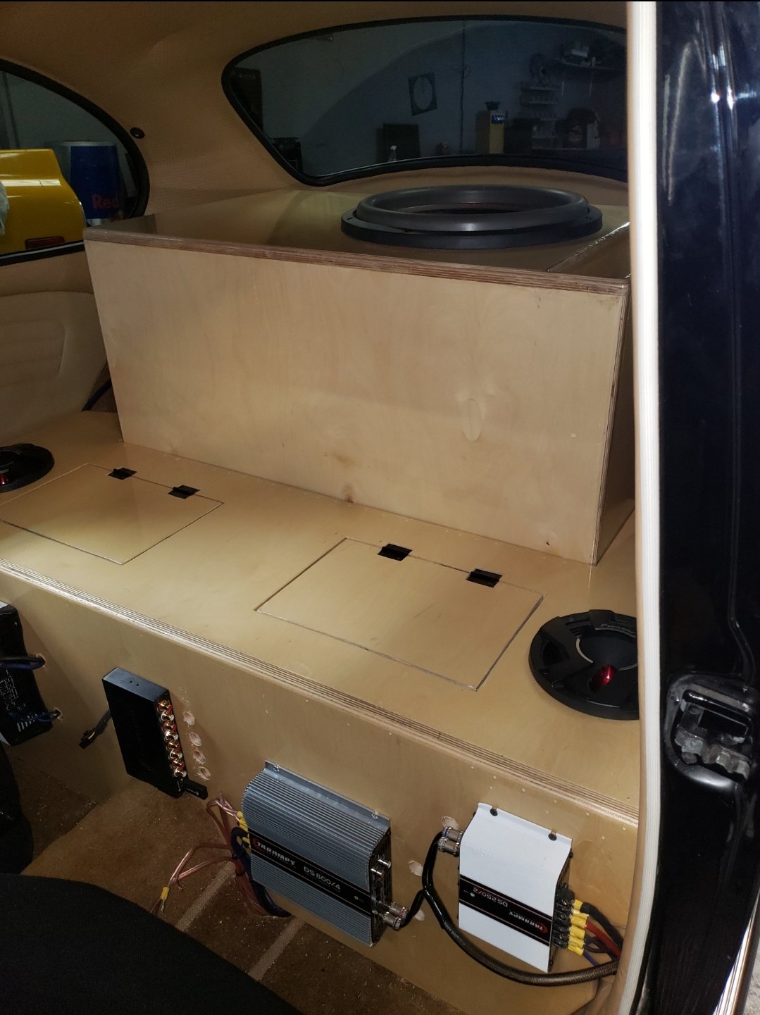

Too many people look down on you if you run an electronic crossover these days. I was running a four way crossover and people shiit on me. It was a tweeter, mid-range, mid-bass, and sub electronic crossover. I was running the Taramps four way crossover with a two channel amp, a four channel amp, and a mono amp for the bass. That pic was before I dumped the DSP for the electronic crossover.

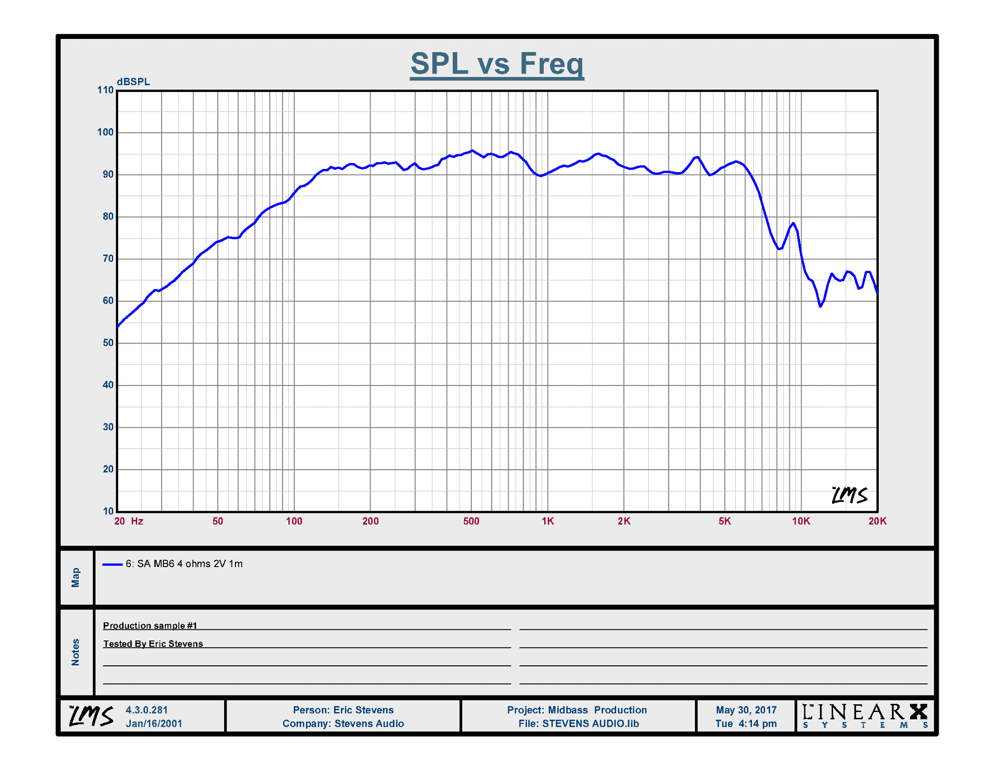

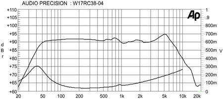

The Silver Flutes play pretty flat from 60hz to 3000hz.
The MB-6s decently flat from 125hz to 7000hz.
Those tweeters recommend a 4.5k crossover so I would do the Stevens MB-6s to pair with them.
