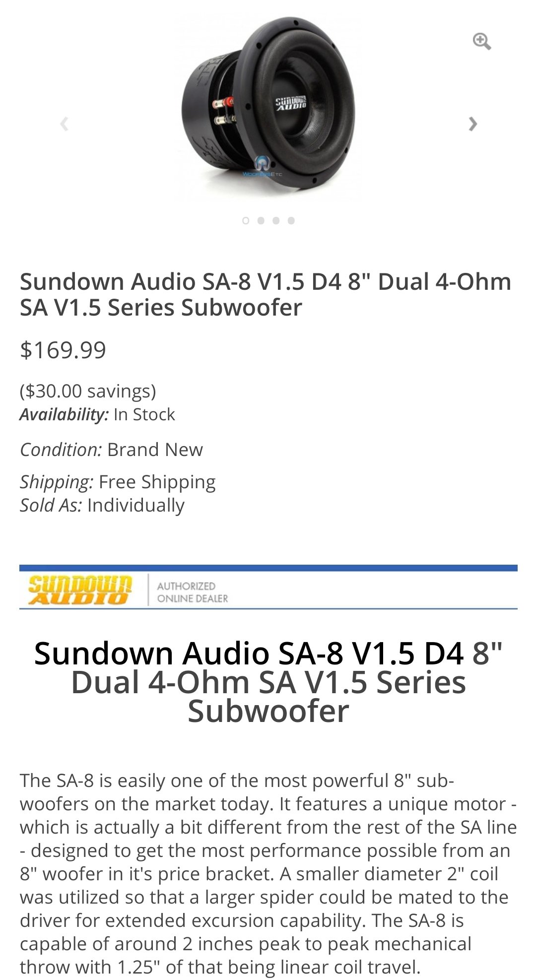

These! Fs is 41.6 and rms is 500.
So, one 12” (the Dayton UM) or a pair of 8’s( the sa’s Bobby linked), which I actually had looked at earlier? I’m down with either of the 2 brands. Wonder which would require a smaller box? Or even which would model best for a t-line.
The fs on those sundowns is a little higher then ideal for a t line but I had an SA 12 in a t line that sounded amazing so all depends on design
