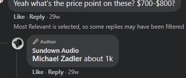

Contact Apex Audio they should have them and a price since they are in that building. And they get right back to you within a day sometimes within a hour or two. Just for the heck of it kinda thing, be nice to know what those are going for in case others want to know.
