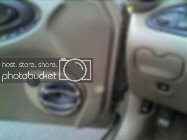

So I think I might get a toyota paseo. It was 6.5 speakers in the rear but in the front it only has 4inch speakers.
I plan to get 6.5's for the front and have the hole cut to make them fit. But being the jump is so big, what should I look out for? Is it smarter to maybe go with 5.25's? Is it possibly I might not be able to make them fit?
