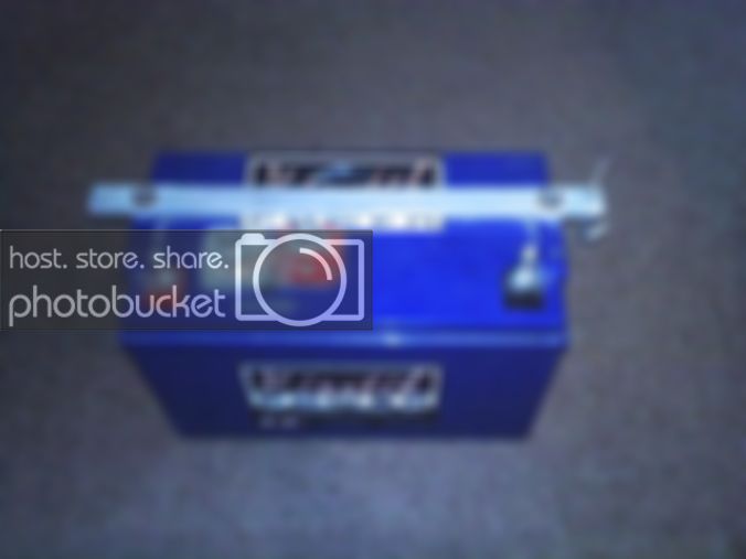

Im sorry, I misspoke, there should be 4 terminals on the batt. To run at 12v it should be jumpered like this:
What exactly are the voltages in the cells Holic? Also what is the jumper connecting? I assume it's probably changing how the cells are connected to each other (parallel/series)
