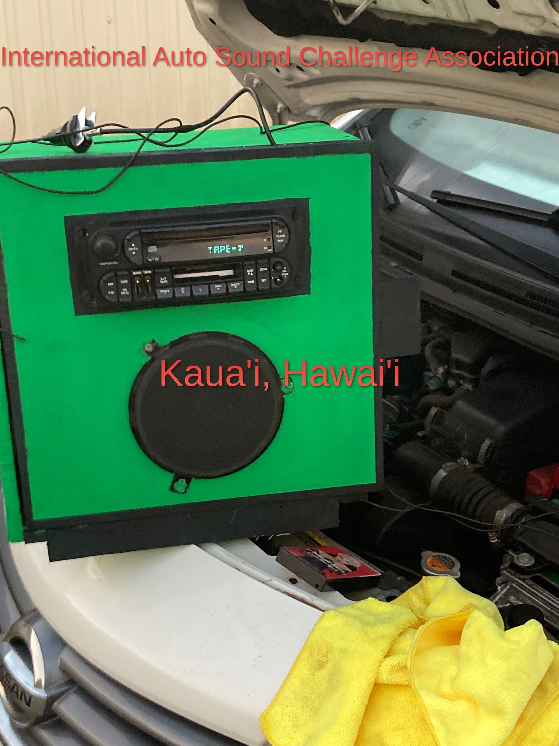

Nope. I never did add an amplifier to a BMW. But I did change a light bulb on a old Chevy, change a fuse on a multimeter, and install a door knob in a door when needed changing. So that's my experiences in technical issues around the house. Also, I 've made my own radio boom box from a car radio, hooked up from outside the car using two + and - alligator clips to hook up to the battery terminals. And I've also tried cutting two 4 DVD resistors to a Sony power circuit supply, and changing those resistors to similar ratings ones I bought from a electronic shop. See if that works. The DVD player. Home DVD player. So that's what I've done in experiences.
