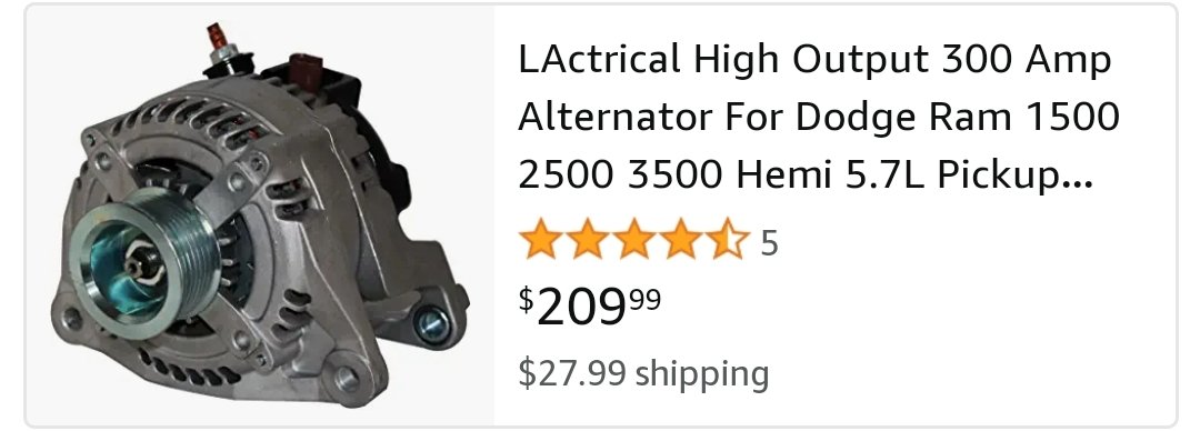

I know it's not a Mechman, but is this worth a shot?

I know it's not a Mechman, but is this worth a shot? View attachment 25849
I wouldn't even bother. I've never heard of a single person successfully runnning these common ebay style alts that claim same amperage as models 2.5-3x the price.
It's always the same story (cheap re-wound alt that runs hot, produces no where near the claimed amperage, and has awful idle output)
