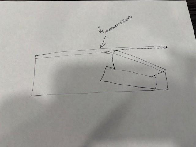

For my F150, I only ran one 10" sub, in a sealed box, and it sounded really good. It was a L7T. Another guy heard it and bought it off me. I just went and bought another sub, but now I have to build another box.
It slanted to the driver's side a little. It looked a little like the drawing below, but it didn't slant that much. I had the 1/4 masonite, on the top, for the sub to fire into. Therefore, the seat would not absorb any of the bass.
Truth be told, about bass, forward facing subs don't sound as loud as subs that bounce off a surface. with forward facing subs, the majority of the sound you hear is from the port. Firing a sub up or down against a hard surface will give you more sound than forward facing subs. A bigger sub will give you smoother and deeper bass. If your wife listens to rock music, then the 8's will work fine. Rap, EDM, and Hiphop will sound better with a larger sub.
