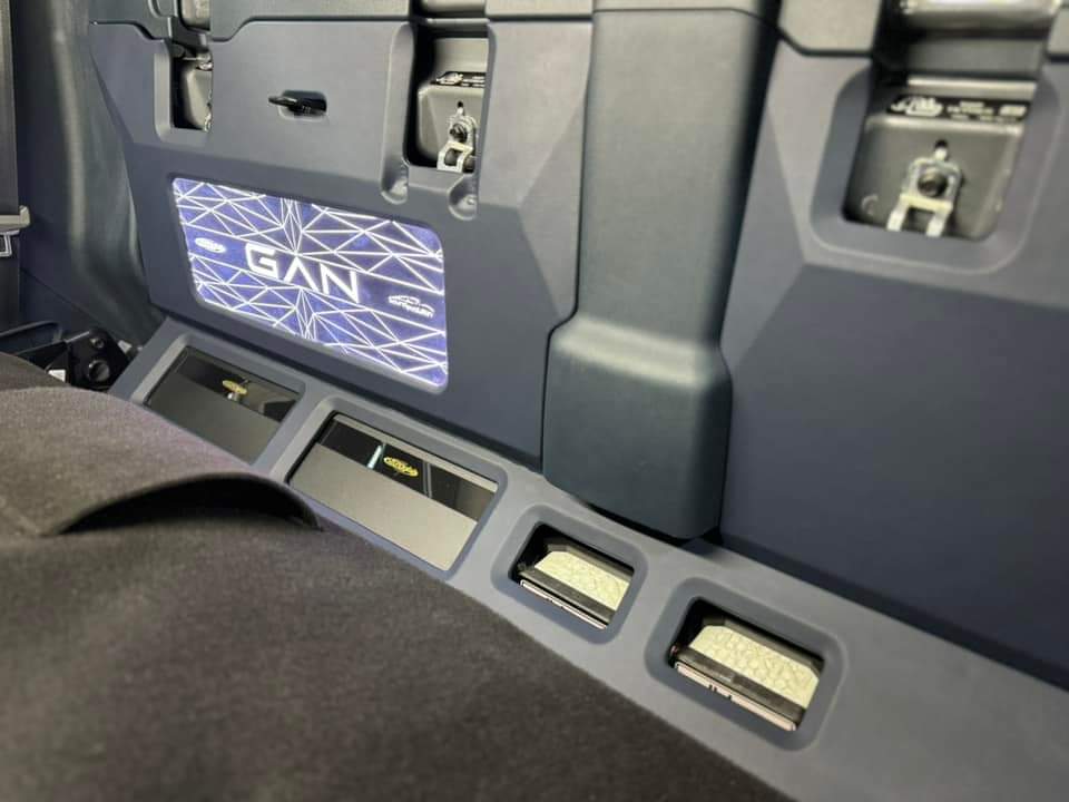

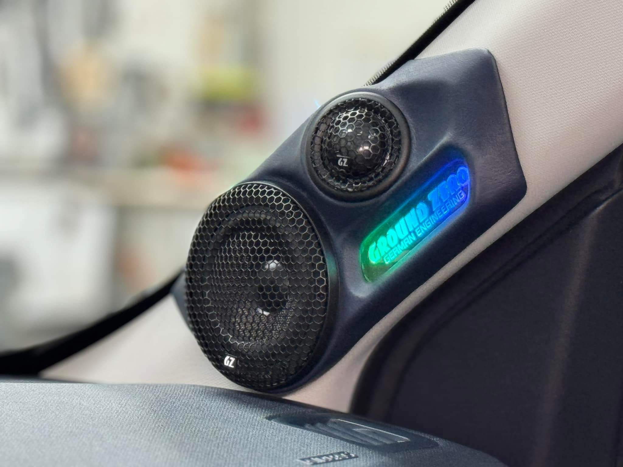

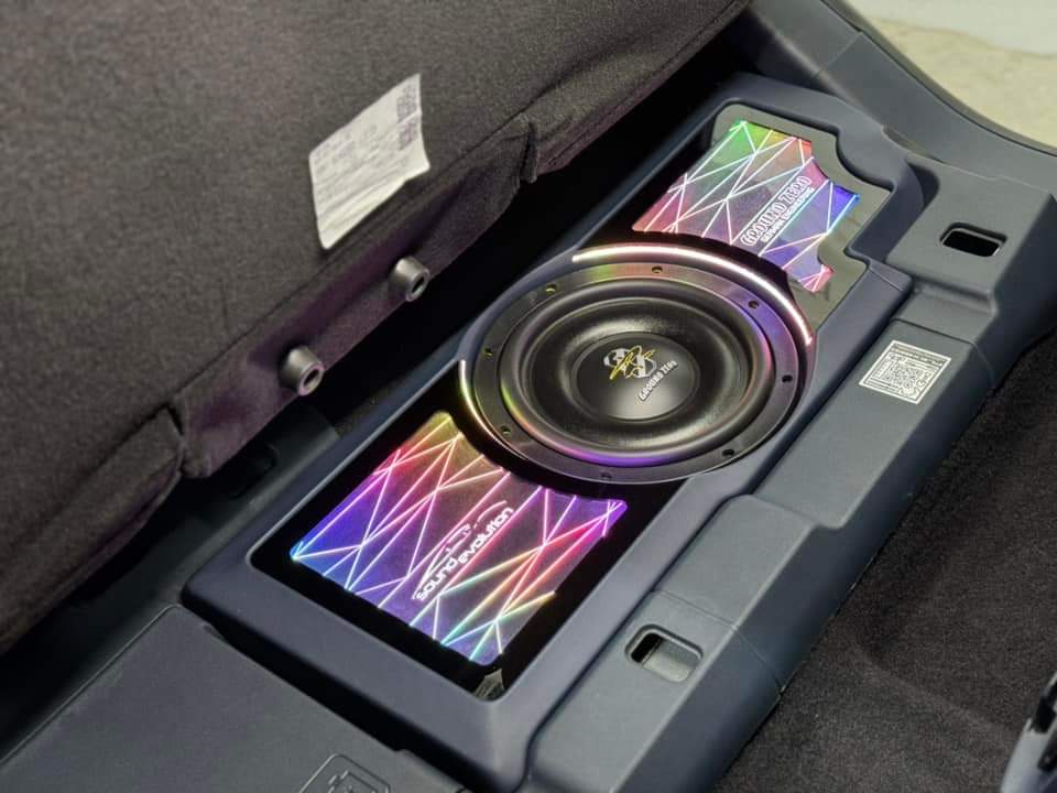

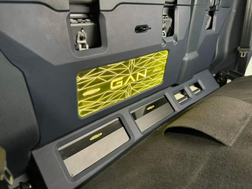

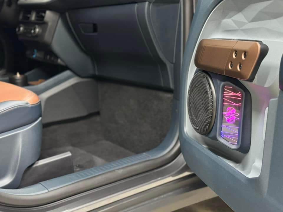

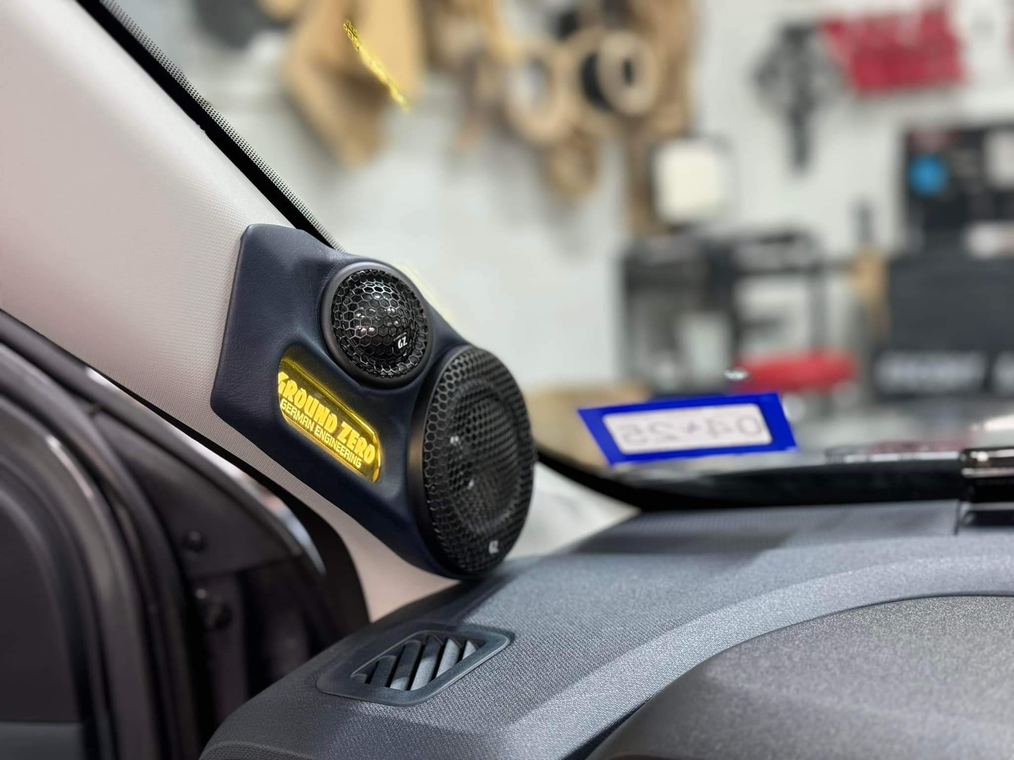

The setup is a 3 way active stage in the front with rear fill. A Flat SPL 10" sub is in a ported enclosure which was built into the Hybrid battery tray system under the rear seat, drivers side. There is another Flat SPL 8" sub that is in a stealth ported enclosure up & under the dash in the passenger foot well. The system has volume, clarity and is very impactful. The most important part, it's super fun to listen to!!

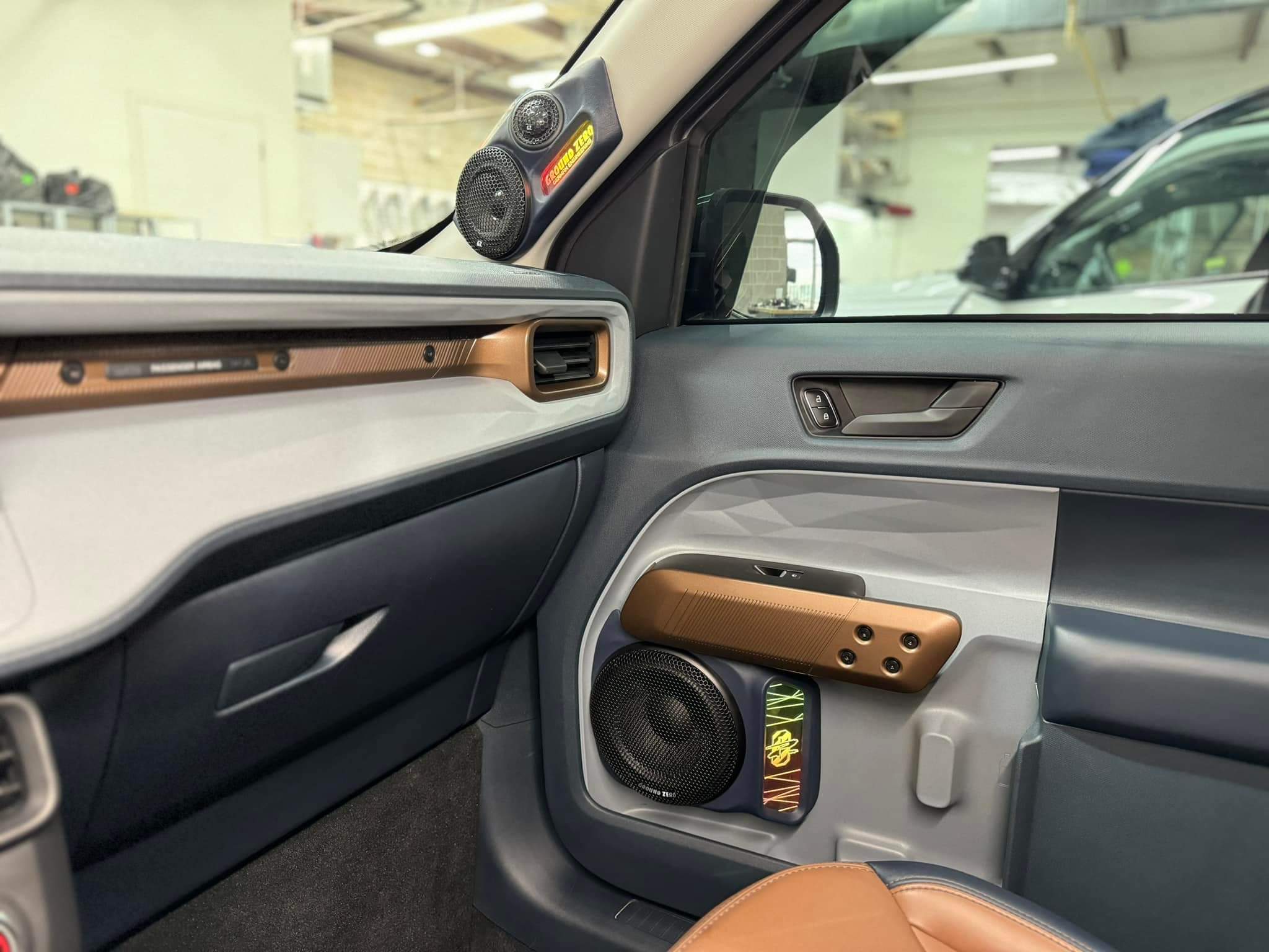

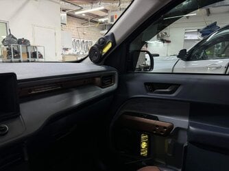

Current Mods: Black & Tan Leather w/ Custom Door Speaker Pods, A-Pillar Speaker Pods, Under & Behind Rear Seat Ported Box & Amp & LED Display, Passenger Footwell Stealth Ported Sub Box Vented through Dash, C-Pillar Stealth Speaker Pods

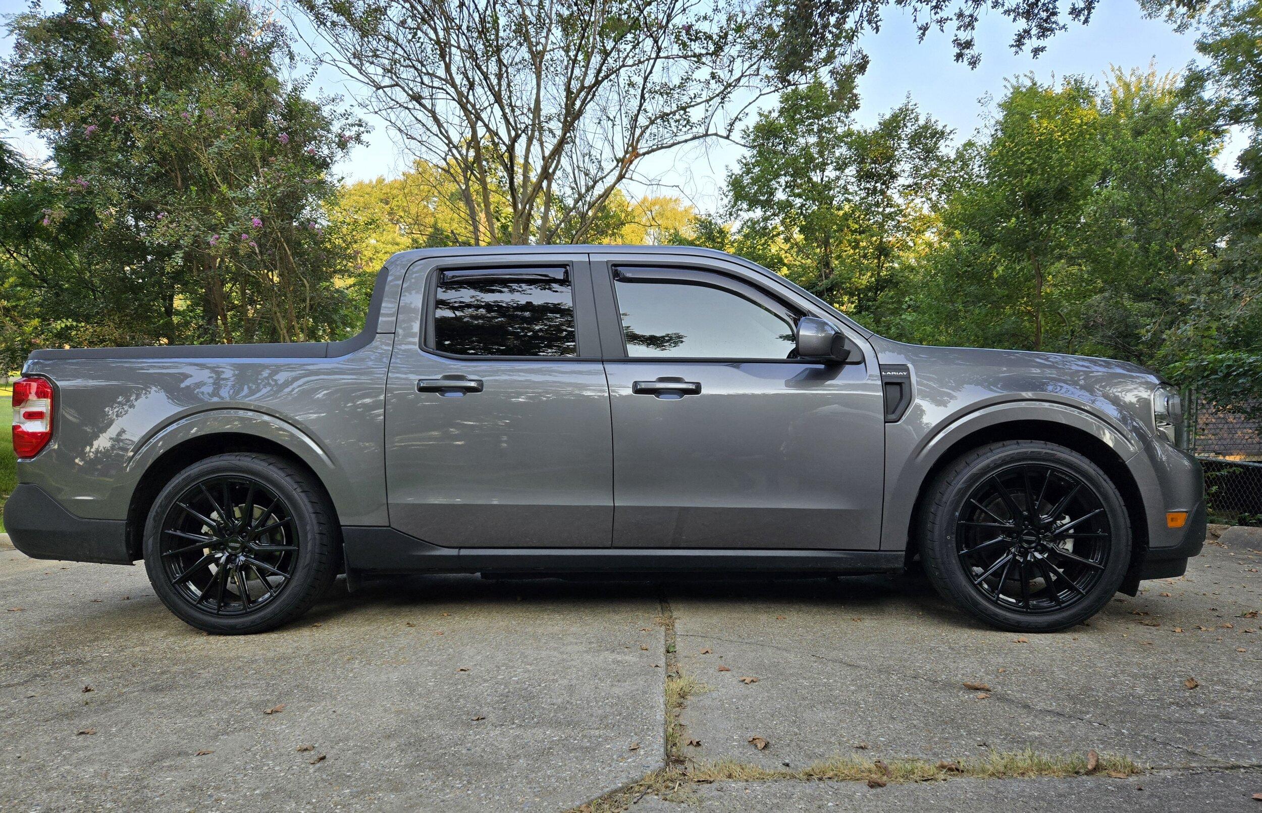

Current Mods: Ceramic Tint w/ 10% Back Glass & Rear Windows, 25% Front Windows & 20% Panoramic Sun & Moon Glass, ClimArt In-Channel Wind Deflectors, BakFlip Bed Cover, Spray In Bed Liner
Lighting
Current Mods: LED Audio System Lighting
Suspension
Current Mods: Eibach Lowering Springs (3.5" R/2.5" F)
Upcoming Mods: Full Airbag System
Wheel and Tires
Current Mods: 20" Vossen HF-4T on 255/45ZRx20 Nitto NT555 G2

Simply Space... it's a hybrid Maverick, so the battery is under the backseat on the passenger side. In order to utilize both of the 1000+W 5th channels on the GAN amps and to create a clean build without modifying or completely removing the battery & tool tray system. It was decided on 1 SPL Flat 10" to be built into the spare tire jack/tool compartment and the 1 SPL Flat 8" (per enclosure space requirements) fit perfectly under front passenger footwell that is ported under and through the dash.
