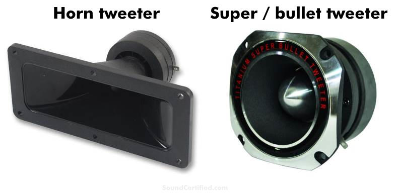

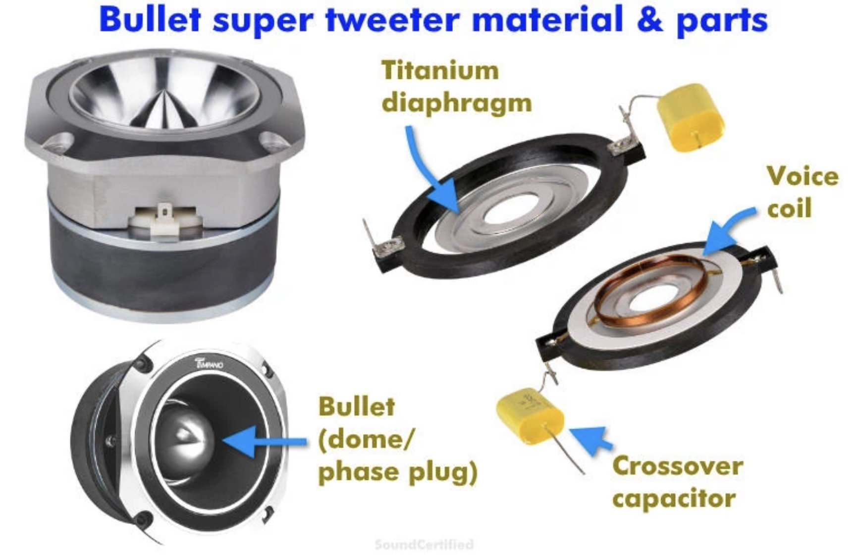

Yeah, they seem to be designed to get loud. Depends on the tweeter, but there’s angles and distances that apply to tweeter enclosures, because the bullet tweets seem to have some horn-style designs. 9000 Hz is only 1.5” wavelength for the full wave, so there’s resonances and angles that apply to the bullet and tiny horn-like structure on those. Any sort of enclosed tweeter can be really peaky; they tend to have that issue. I have heard a pair of bullet tweets in a loud wall that actually fit, but it was just 1 pair. They actually sounded pretty good iirc. I’ve heard horn tweets before under the dash. They made my ears bleed 🥲
But those shapes matter; cheap design and materials can be extremely peaky. A multi-band EQ would really help balance one of those out.

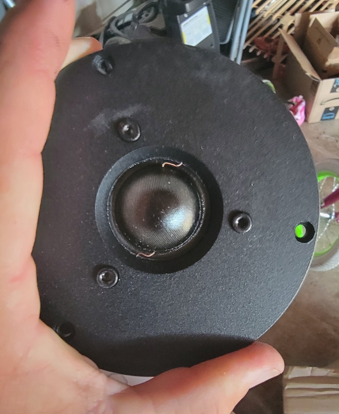

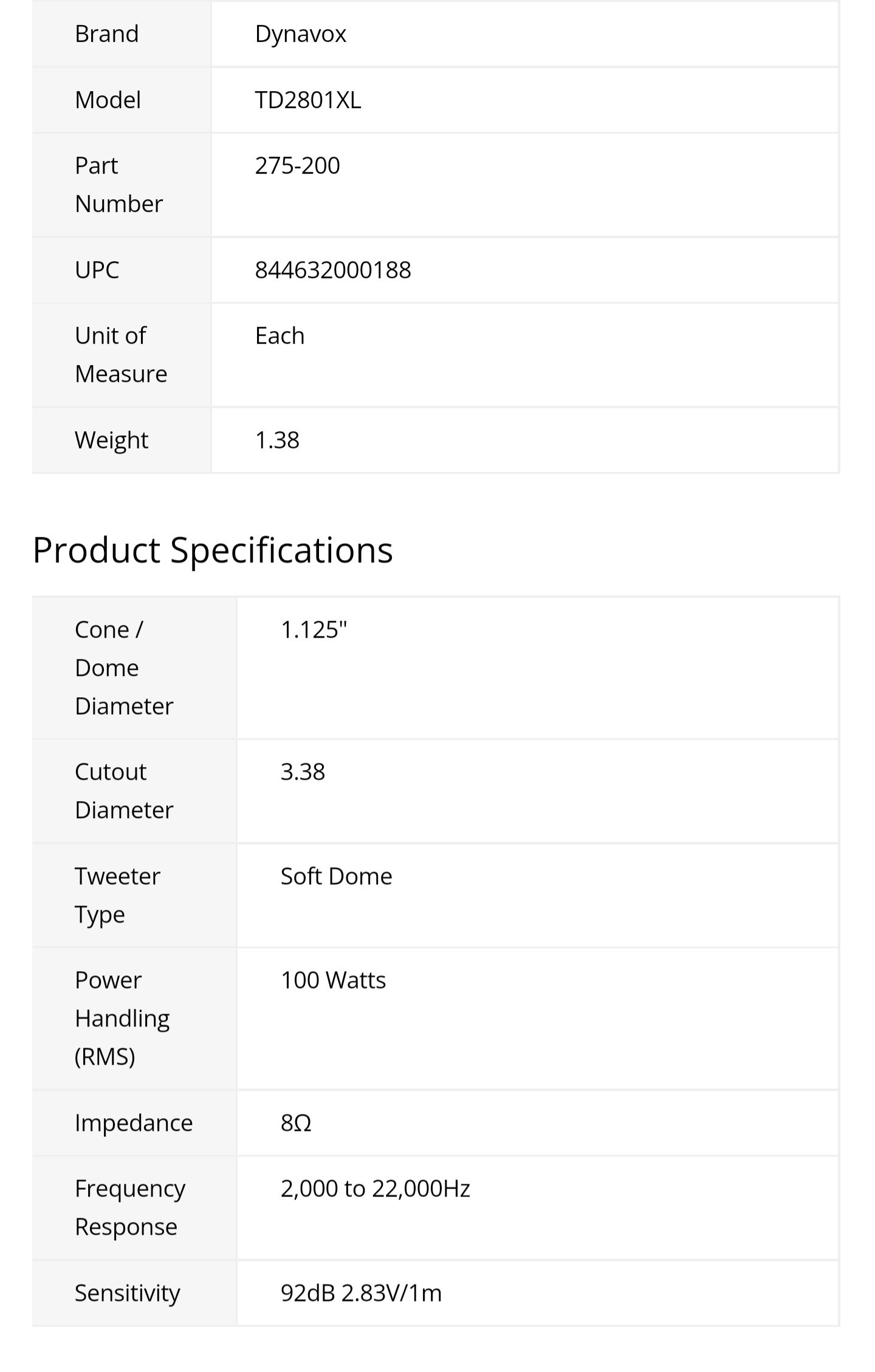

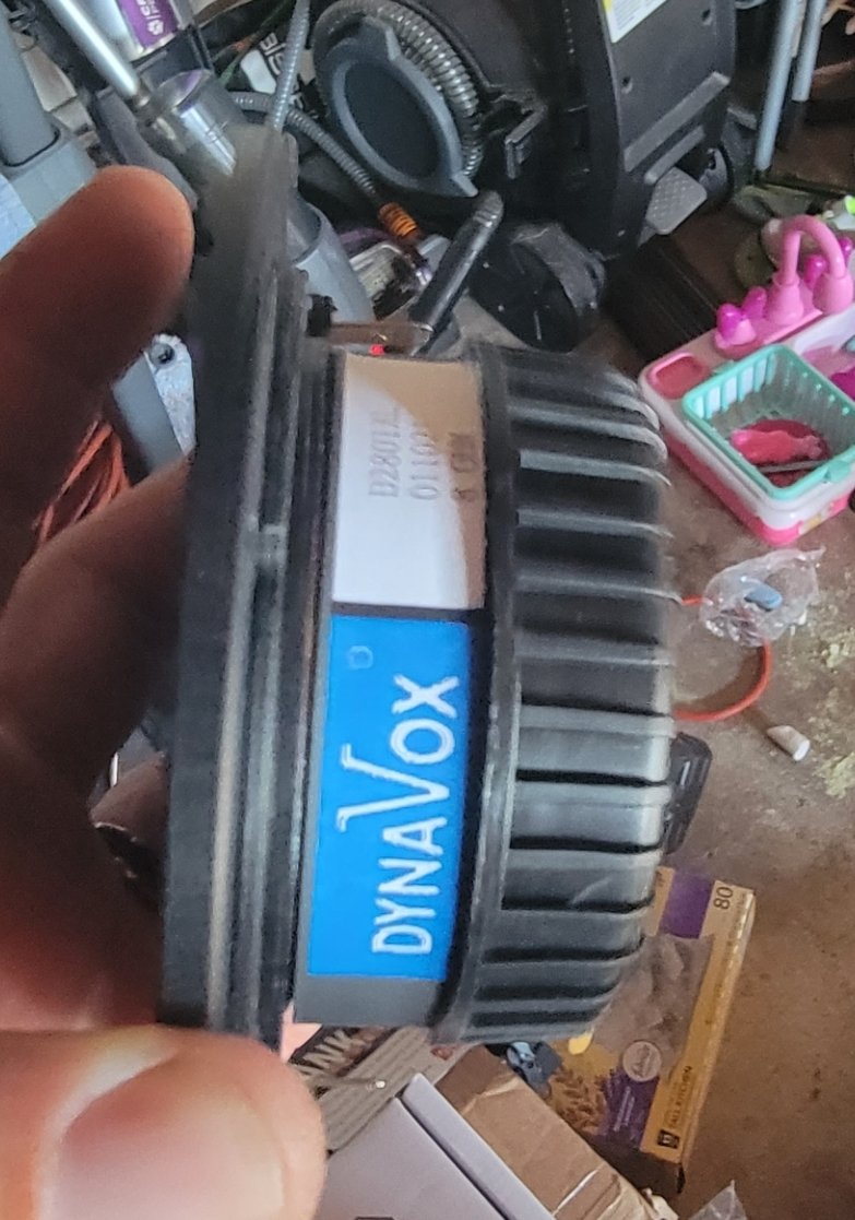

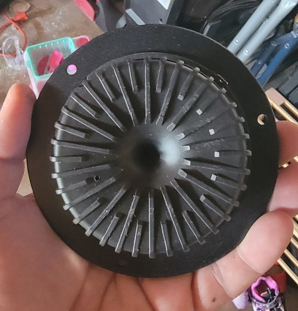

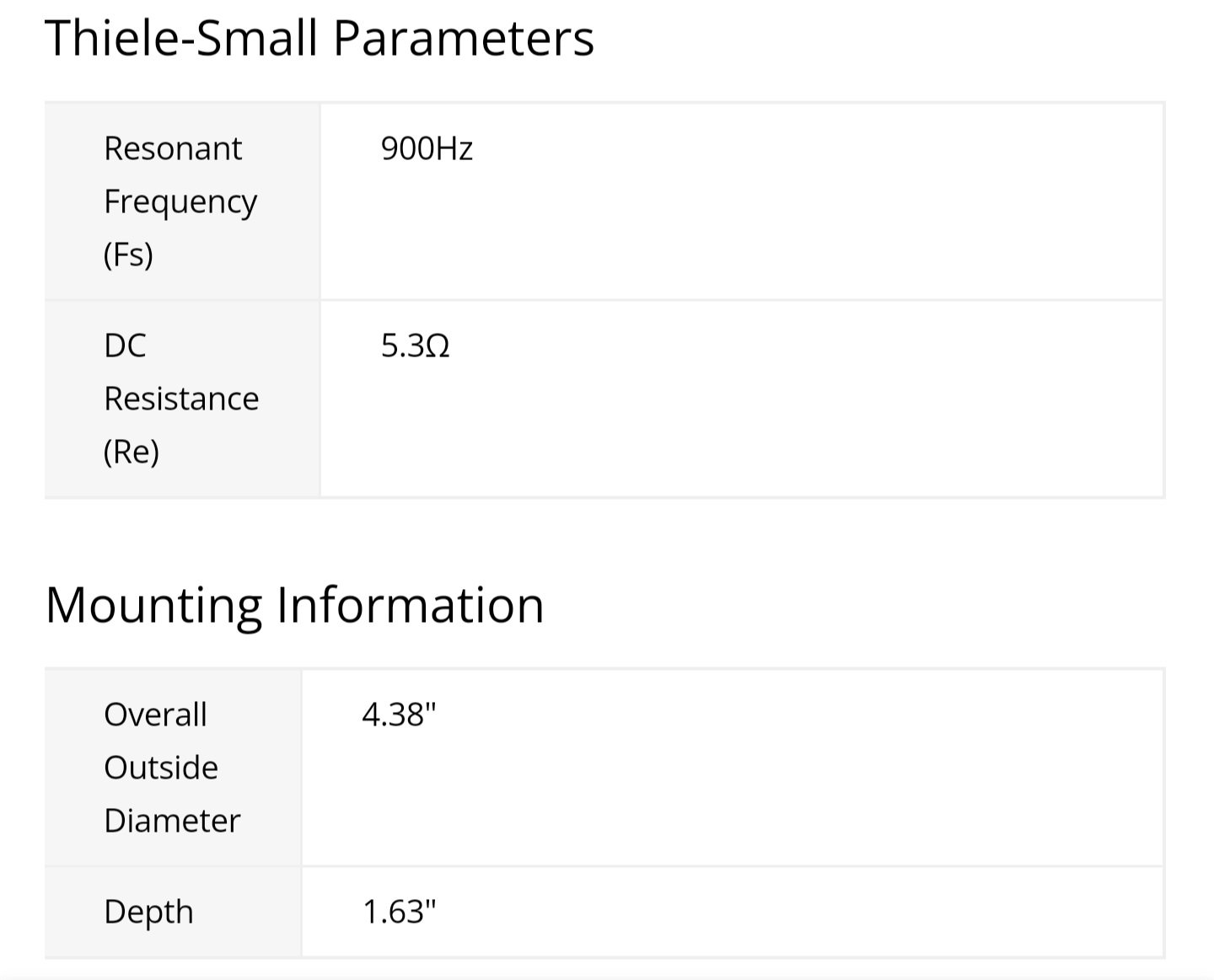

These are the tweeters in going to use in my truck. Beefy little guys just going by weight. Probably not the best for a car audio setup, but I'll make them work. They will be protected by a steel mesh screen as well
I will have a DSP, and I also have an Audio Control Three.2. Not really an EQ, but I have lightweight control. I will also have an in dash gain knob for the amplifier that will be running them (Cresendo s4), so I can turn them down as needed. We'll see if it works out.
