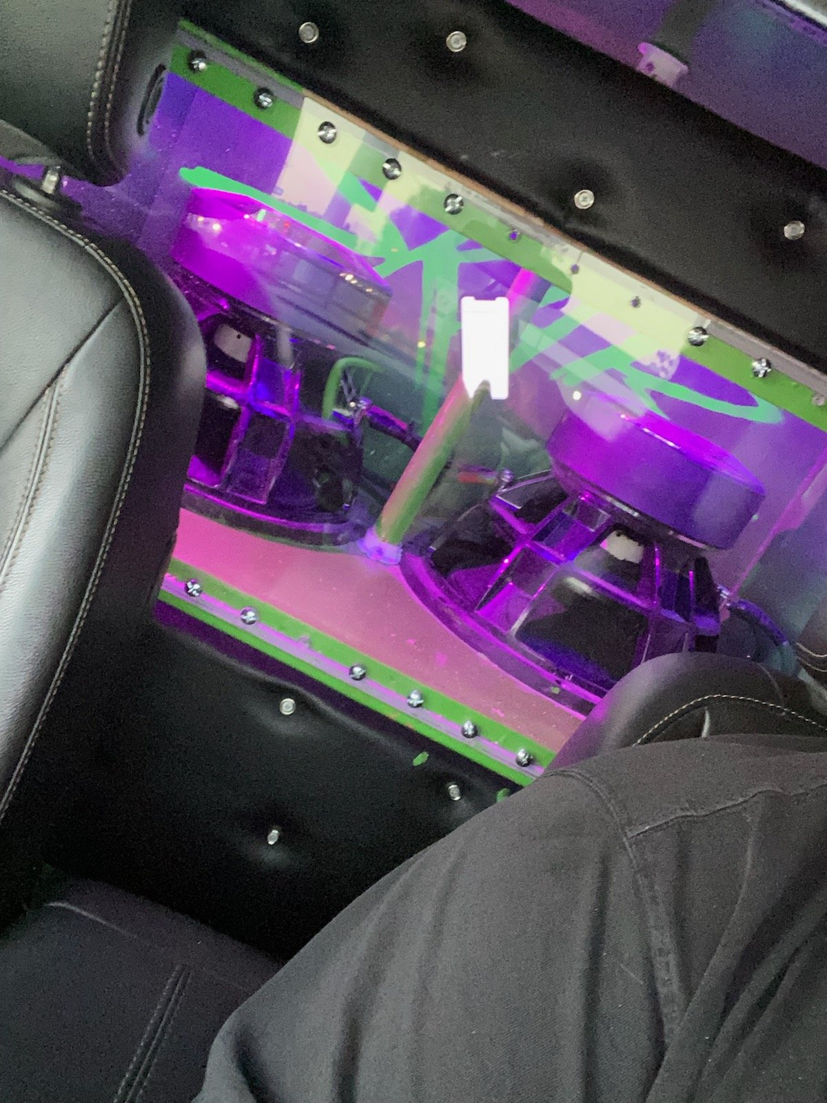

We weren't able to both work on the vehicle this last weekend because my buddy got covid and it's been kicking his butt. But he has been doing a little work himself when he can.
You can see in this picture, he put a little makeshift wooden dowel brace in. Once I talk to my welder, we'll get that replaced with a steel cross. To top bottom, back to front.
He also did some vinyl work. I like the crome buttons, and the pillow look, I just wish they where a bit more uniform in spacing... again though, that's my taste and this is his build. As long as he likes it, I'm happy.
He also installed the black light LED's. It actually looks pretty dope! That Skar logo on the back is actually invisible without the black light. It came out pretty damn sweet if you ask me
He also installed the black light LED's. It actually looks pretty dope! That Skar logo on the back is actually invisible without the black light. It came out pretty damn sweet if you ask meView attachment 40384
Looks Bad AZZ!!! Nice work man!! Looks like everyone involved has done a bit of customizing to the Install and it looks really good man. I hope your friend gets over that nasty virus and gets to feeling better for sure 👀 👀 👀 💩 (y)
Thanks man! It's coming along and looking pretty decent in the process
That purple and green is wild with that black! There’s definitely another round of covid going around, so definitely take care of yourselves. Do you like those tweeters?
Thanks man! Yeah, it seems like everyone around me is getting it. I haven't gotten it yet. I accredit that to the fact I work outside, in the streets of nasty *ss San Francisco lol. I think at this point, I've been exposed to everything and am immune🤣. No, in all seriousness, I'm sure sooner or later I'll get it. Hopefully it doesn't kick my *ss too bad.
Do I like those tweeters? No. I haven't liked any bullet tweeters I've heard so far. They all seem too harsh for my taste. They're loud though! They are responsive, and aren't too muddy and they are crisp. Just... too crisp for my taste....i guess you could say. I don't know. Once I heard silk dome tweeters, I fell in love. The 4 tweeters that are going in each door in my build are all silk dome. I'd like to hear a ribbon tweeter.
