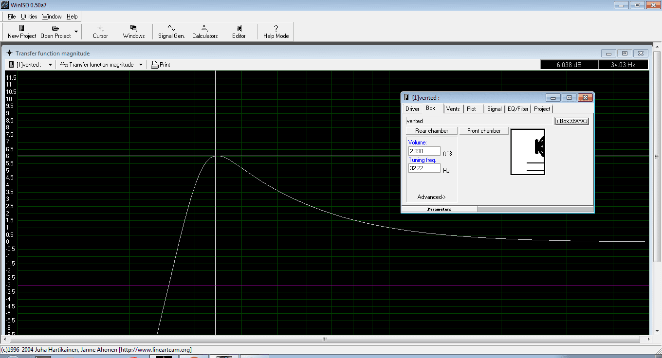

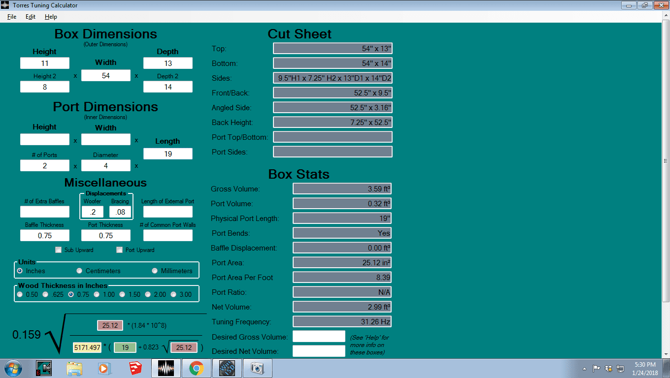

Is there any foam under the carpet that might compress with the seat down?.. I was told it fit well... it was 11" in front, 8" in back 56" wide...
I raked the baffle slightly so it would fit under the seat lip better... magnet clears and it goes low and loud according to him... he had a CAB at 1/2 ohm on it so I ported it for +2000 watts
With 2” lift I can do the 11” front, 8” back, I don’t mind the 56” it’ll stick out a inch on each end.
