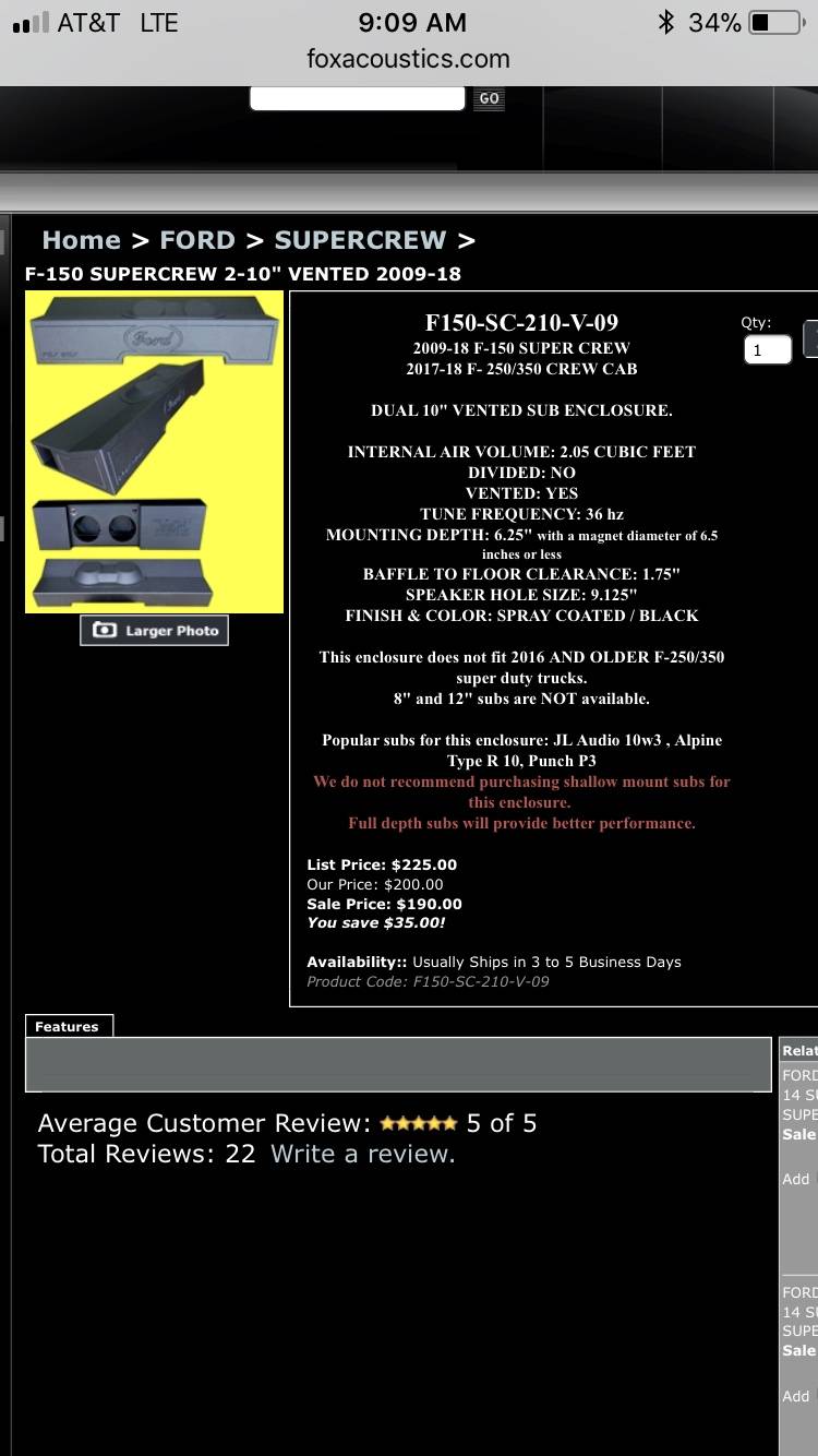

What you think about this box for 2 sa10’s? @shredder how many watts would you feed em max rms each sub in that box?
Subs rated for 1-1.25ft^3 each, displacement is 0.11ft^3 each, depth is 6”
Box 2.05ft^3, depth 6.25”
After displacement subs have 0.925ft^3 a lil under the 1ft^3 minimum. Box also 1hz higher than the 35hz on Sa10 specs.
Ya'... that's all good... but they don't really deliver good sound or great output... IDK maybe if a different driver is used?.. IIRC the last guy had nothing but complaints about frequencies and output with his foxbox... that 36hz tune will change drastically once you install the subs and IDK how it's ported. Without me saying it's garbage why don't you ask around or something... I have ZERO experience with Foxboxes... I always build my own... lol... and with a proper airspace and tune for the power used.

I just read the thread on the sa10s in the foxbox, it’s ****. I don’t want to waste my money I did build a 5 cube ported box for sa12s before. If u give me the same design on the f 150 will I need the 2” seat lift??
Yes... it's needed
