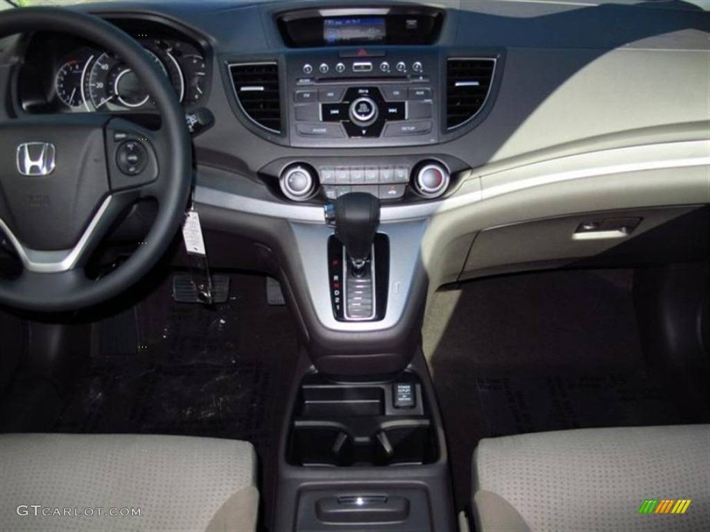

This isn't mine but it's the exact same.
