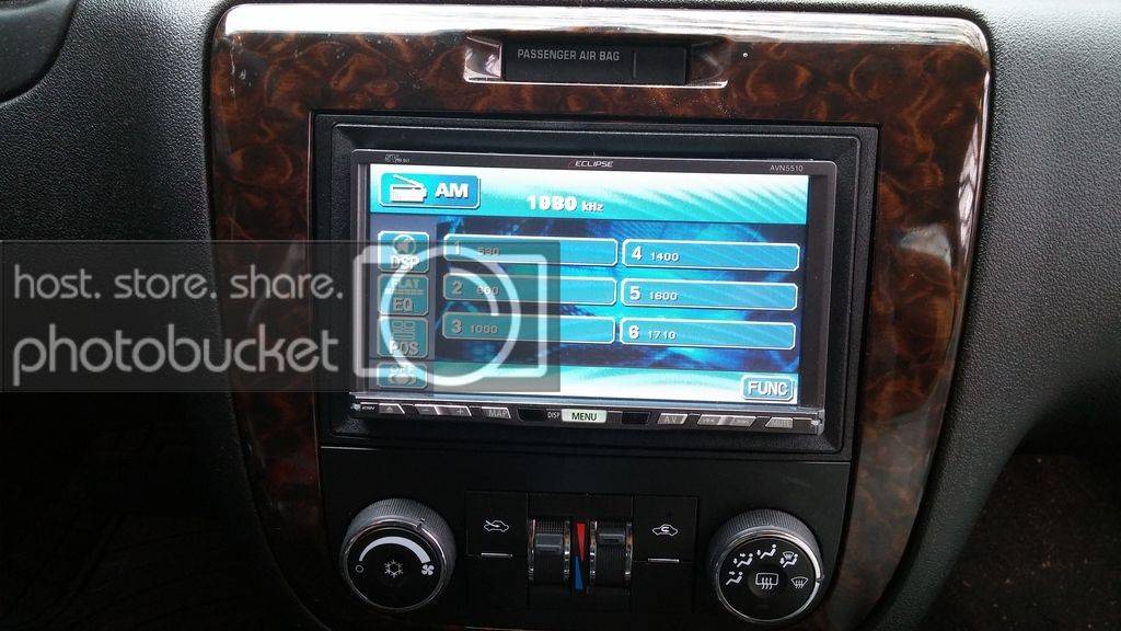

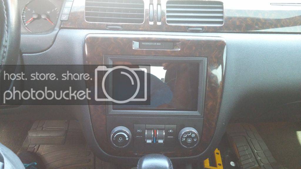

Why do these look so fucked up to me? Lol.

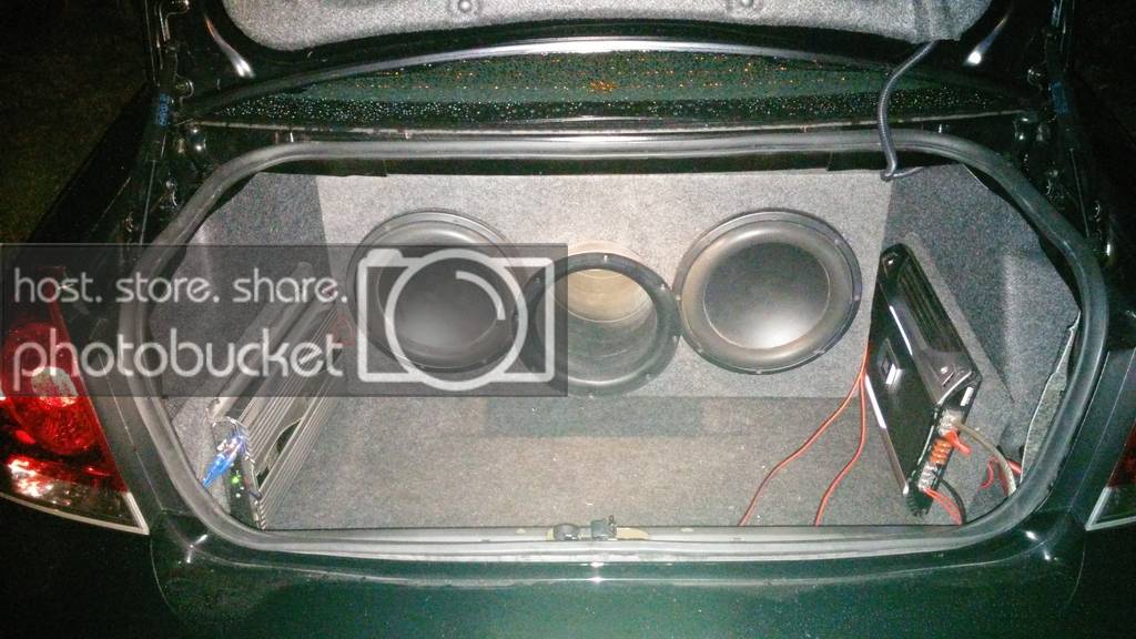

But I like the dash install. I'll be going with an 80PRS for sure, but that does sort of give me an idea or two. Not sure how much stuff is the same after the vehicle redesign, but much of it does look the same. How badly does your trunk rattle? And where did you ground your amps?

i think its at a angle. i too thought thet they were offset lmao i was like what in the ****

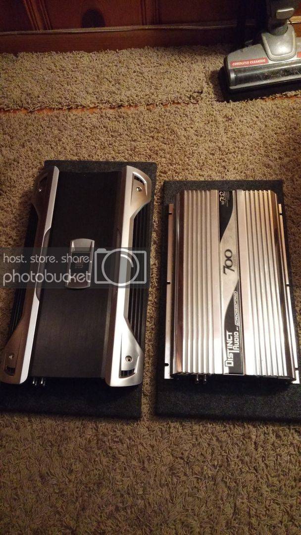

Old school ppi. Set was like $600 back in 02. I got them brand new in box. Also I have a dedicated ground run from the front.

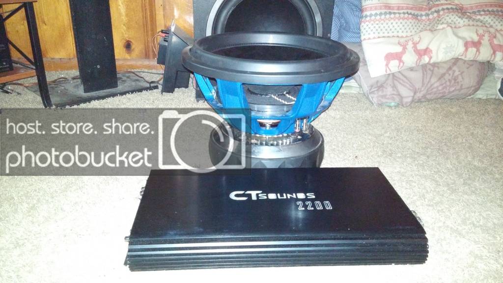

With 4 batts. No big 3 and no ho alt. I don't drop below 13.4 full tilt with the ct 2200.1

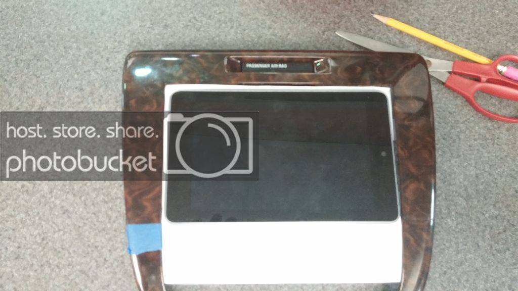

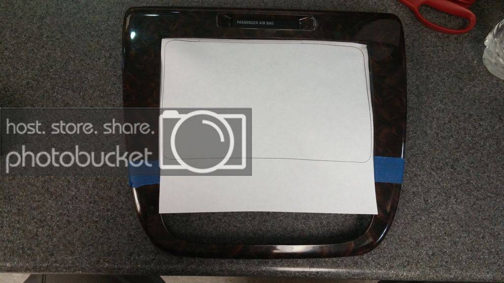

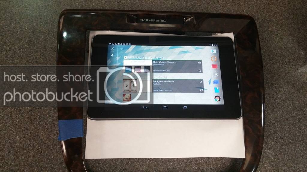

Got Noico deadener and CCF, 100ft of 12ga wire, T-nuts, and some random install goodies. Oh, and the sheet of plastic I was waiting for. So I was able to make this for the dash kit:
I'm putting a voltage/ammeter, PAC LC-1, mic for the HU for calls, and two switches (one for amp lights and one for amp fans) there.
