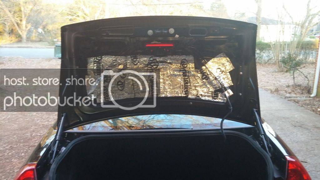

Just ordered a bunch of small random stuff from Parts Express, and also got Noico treatment materials from Amazon. Got 54sq.ft. of their 80mil deadener, and 75sq.ft. of their CCF. Heard from a couple places it's good stuff, so I'm going to try it out.

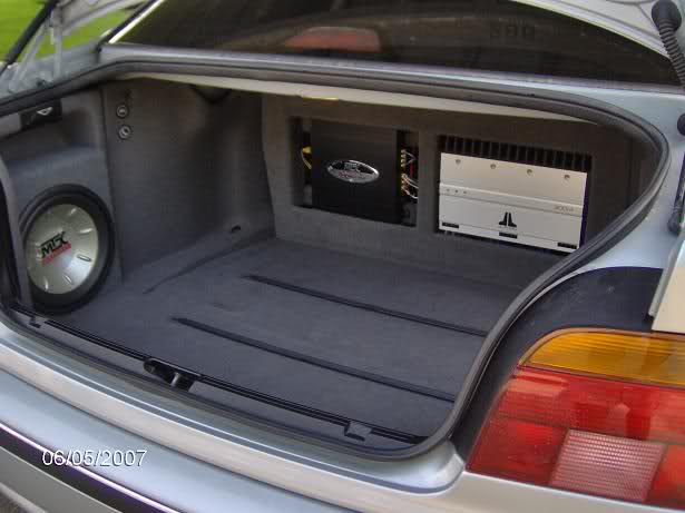

So I need a little help. I don't know how to design this amp rack. What I want is basically this (just pay attention to the amps, not subs):
I'm going to be building a box to hold the amps, and then the rear board (towards the trunk, so what you see) will also be a beauty panel and be wider than the rest of the amp box. I wanted to mount the amps to the rear board so that the guts are visible. More I think about it the more I don't think that's possible though.
I don't know how to secure the beauty panel to where it's removable, so that I can get to the amps, and still have a clean look on the outside. It's going to be 1/2" plywood, so I don't trust magnets to hold that on there if the amps are mounted to it.
Actually, just thought of this while I was typing, maybe I can do hinges on the bottom so it folds out/down, then magnets all along the sides and top. Could be those cupboard magnetic latches (like this: Liberty White Heavy Duty Magnetic Catch with Strike-C080X0C-W-P - The Home Depot). But then I wouldn't be able to mount the amps to the rear board, I would have to mount them to the opposite side (towards the front of the car), and then would only be able to display the top/chassis.
Who's got ideas?
Glue a board to the back seat or however you feel comfortable.
Then create the front face like that one. To make it easy add long brass studs so it can be bolted in place.
If not add door hinges on the top and add a small lock to the bottom so you can lift the face up to access amps.
