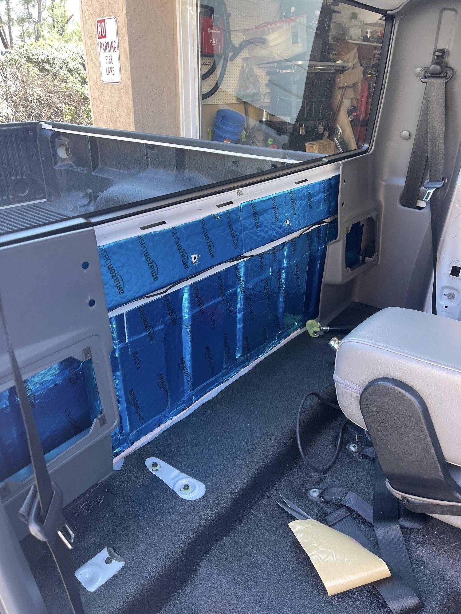

All the outer pieces were left whole, they were 10x15 sheets.
I Put the kid to work on this one, trying to get him to put in the work...
He seemed to enjoy it...
But then again I asked him if he wanted to do the door panels or should I get them done while he's gone to Arizona this weekend...
He quickly replied with, "go ahead & get it done"....

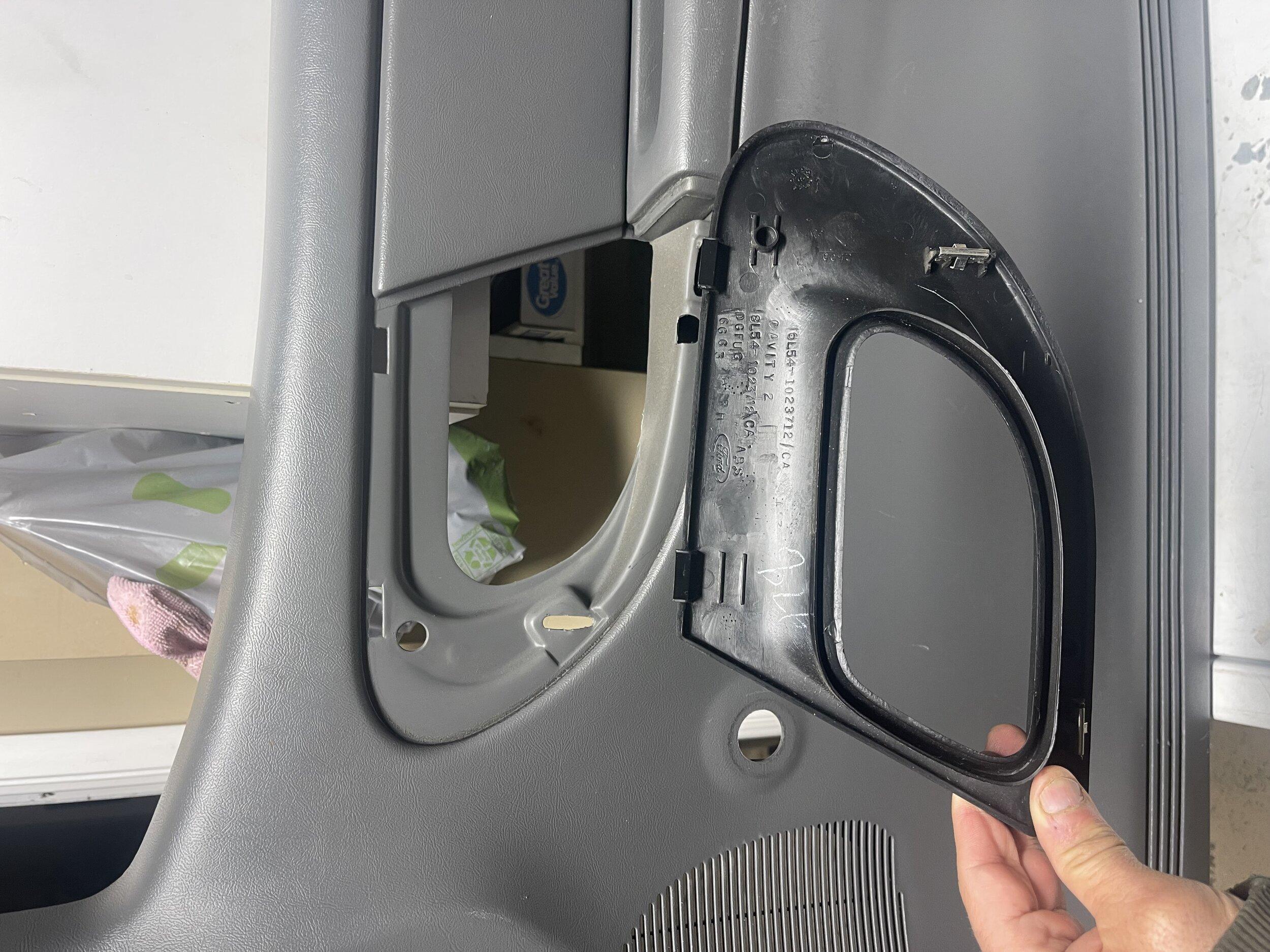

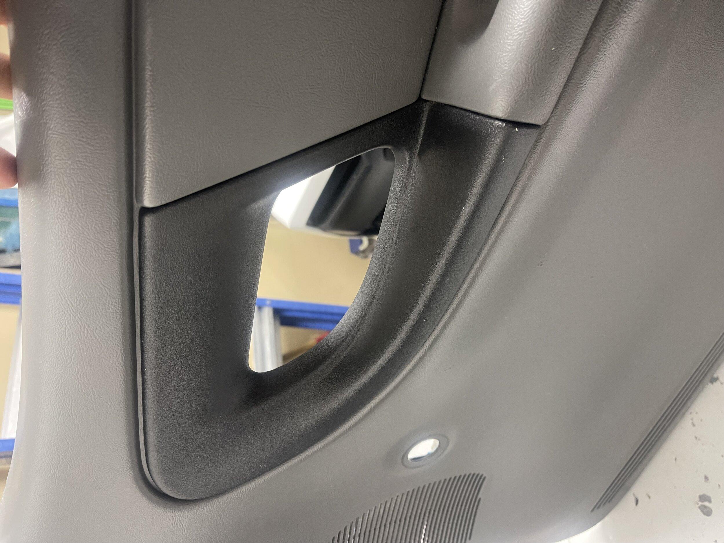

Where the black door handle bezel snaps into the door panel, I forsee a big rattle source! Going to take it apart but should I use Tessa tape to line both in that area, butyl rope, I also have some thinner foam matting I can use…
Don’t have butyl rope but can be easily sourced…
Thoughts?
Thoughts?

Rope or adhesive backed Neoprene.
going to tear it down tomorrow & see what the overlap looks like...
I do have Tessa tape, 157mil closed cell foam,
dont think the butyl foil will be a good idea as will be too thick & interfere with it securely snapping back together.
can easily cheaply source butyl rope or even some neoprene rubber...
Really think that are is going to be a rattle trap.
Also these door panels dont snap in place with traditional push pins.
They have big boxy hooks same material of the panel, probably wrap those with Tessa tape, maybe Tessa tape, closed cell foam & more tape, try to keep the bulk down,
Just dont want the panels to rattle!!!!

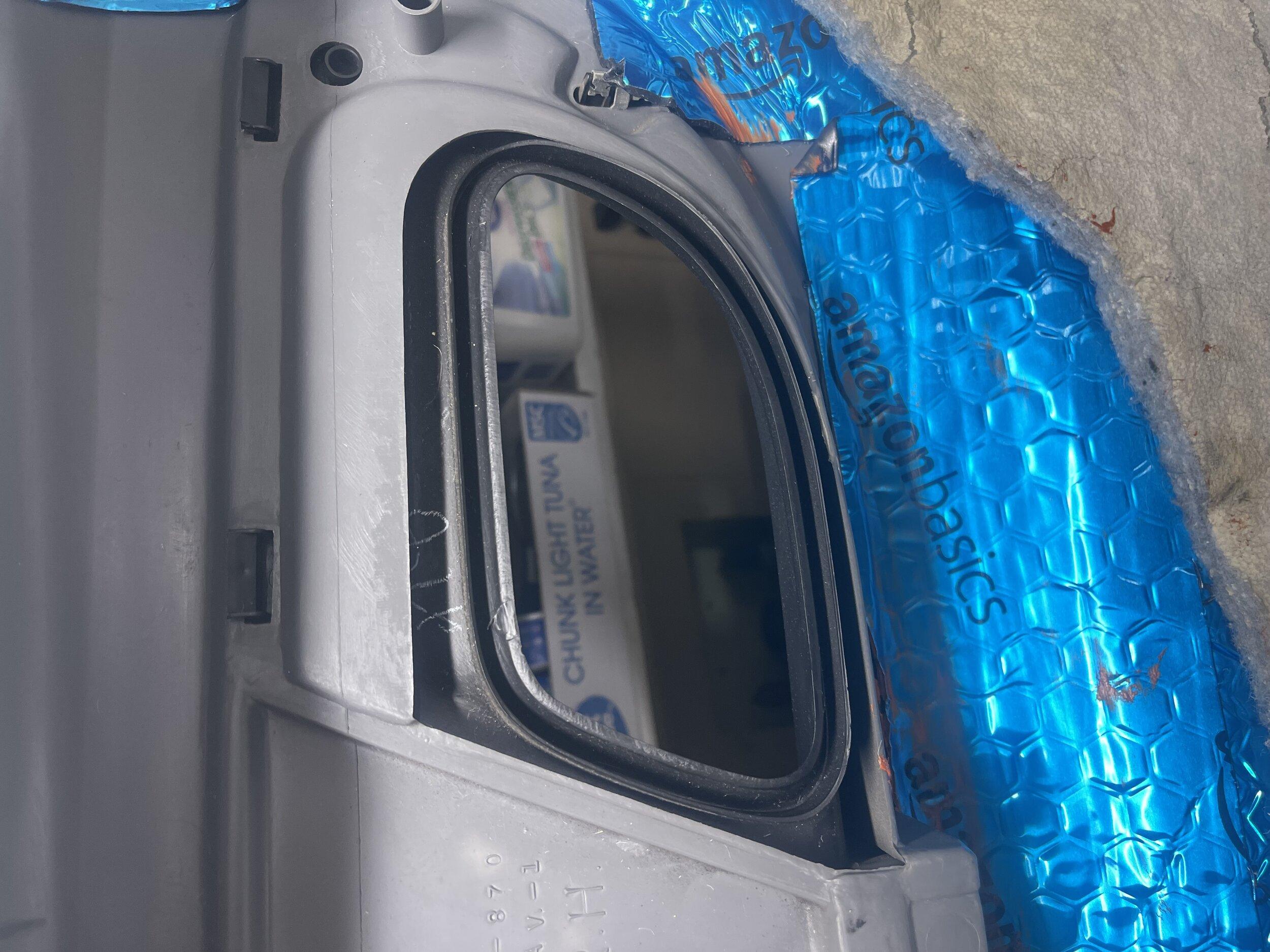

Finally able to post a pic...
Majority of the area is wide'ish..
I can to the sheets of closed cell foam I have...
Combination of butyl rope & matting of some sort....
Havent used butyl rope so no idea if it compresses / flattens over time & looses some of its effectiveness..
Yes overthinking, its what I do...
Lots of traffic at that area since its by the handle.
It's near impossible to get a rattle free door on the first try when you have a solid midbass driver.
