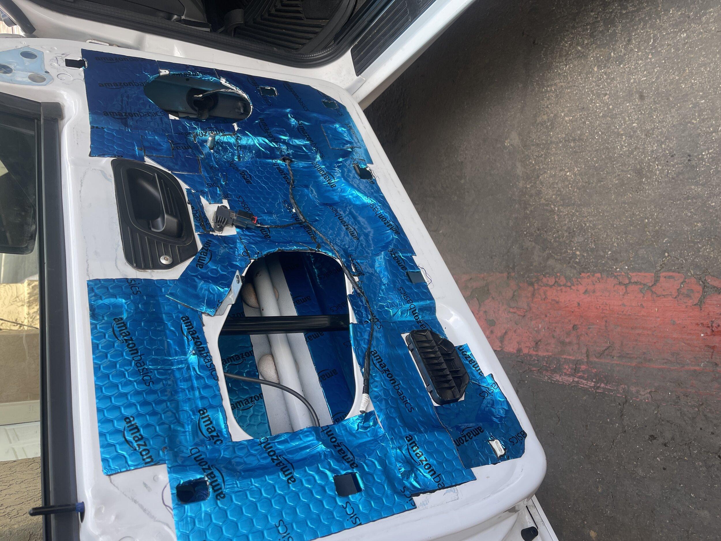

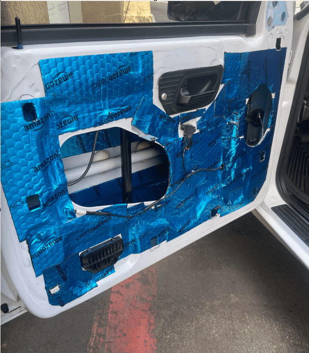

Used it on my 24 tacoma & now this ranger,
After I put it in-place, hit it really good with a heat gun & roll it,
Doesnt seem like it's going anyplace to me.
As stated cant compare it to anything, passes the thud test, seems to do what it's suppose to do.
Think its on of the most budget / value options out there...

Ive gone through 3 large boxes at this point between 2 vehicles.

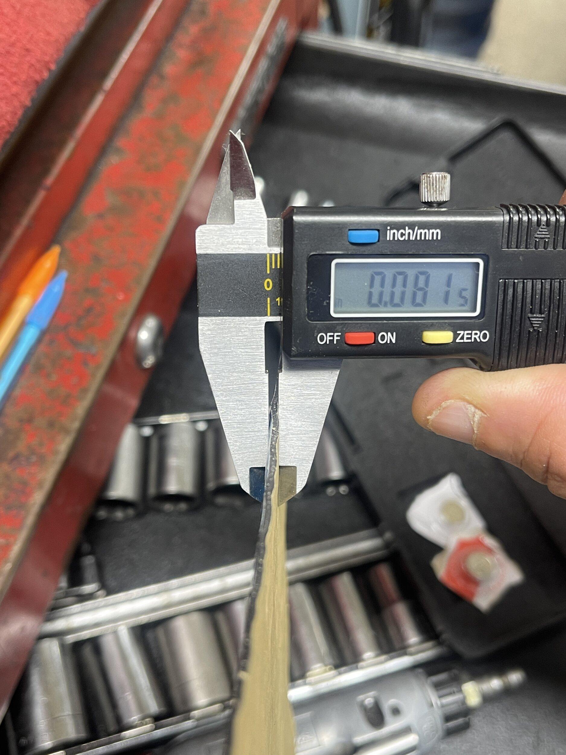

Inregards to it being thinner than it was at time of that documented testing that was done, I saw nicks video…..
Here’s a sheet from box I got last week, 80mil…
But at the time they did the testing, its documented to be 90mil but nobody can actually verify if it was actually measured or just going off what the specs / description say...
But agree, better options, but I went with what I know & seems to work just fine...

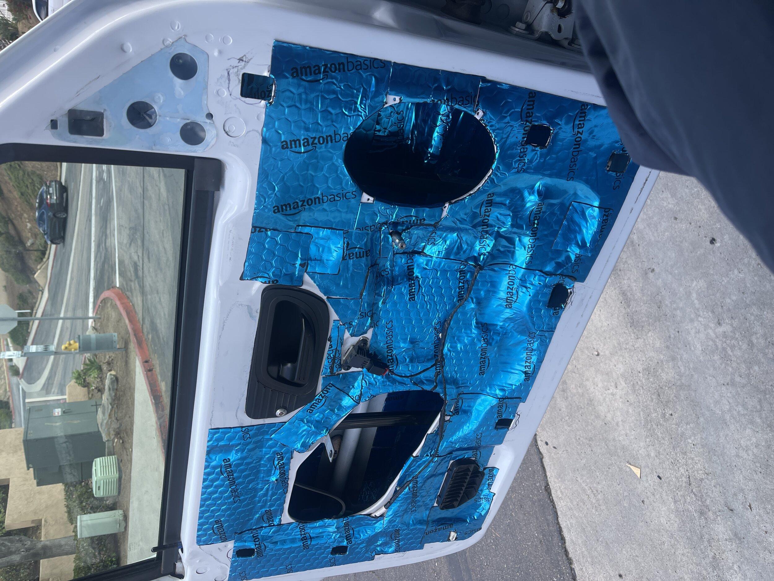

Driver side seat is raised to accommodate the large amp….
Depending on what the builder decides on the box, may just make a small rack & mount the amp vertically on the side of the rear pillar. Tucks in there nicely once the plastics are trimmed…
