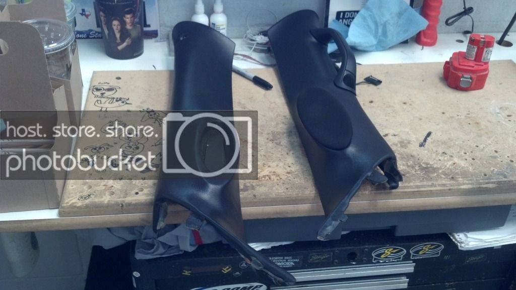

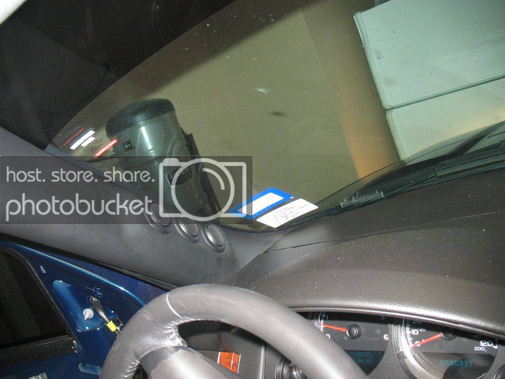

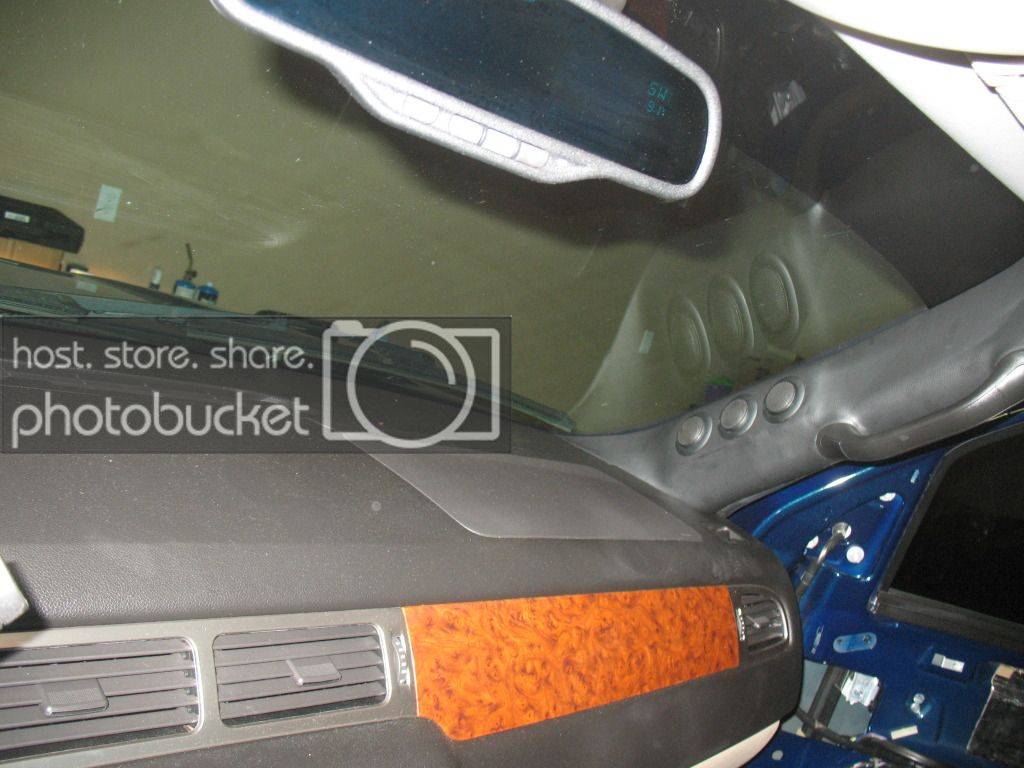

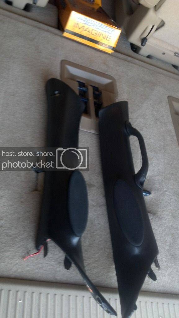

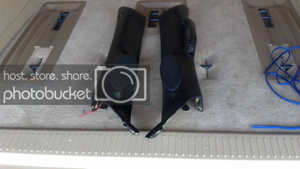

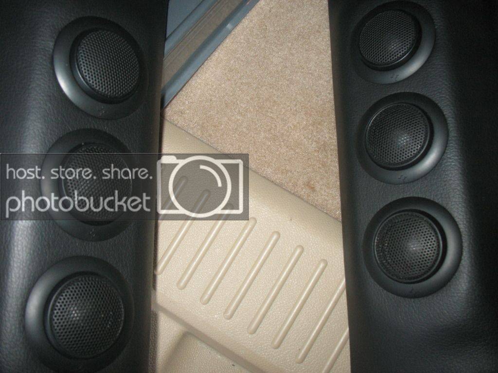

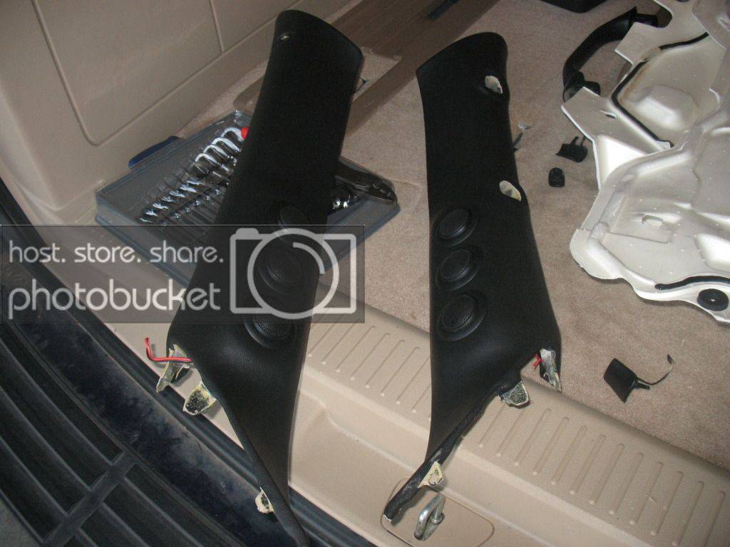

Decided to change the A Pillars up a bit, here is the final results. Also working on the door panels.

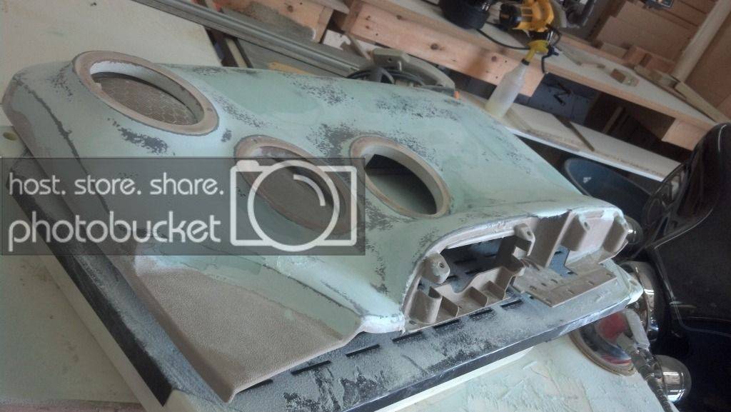

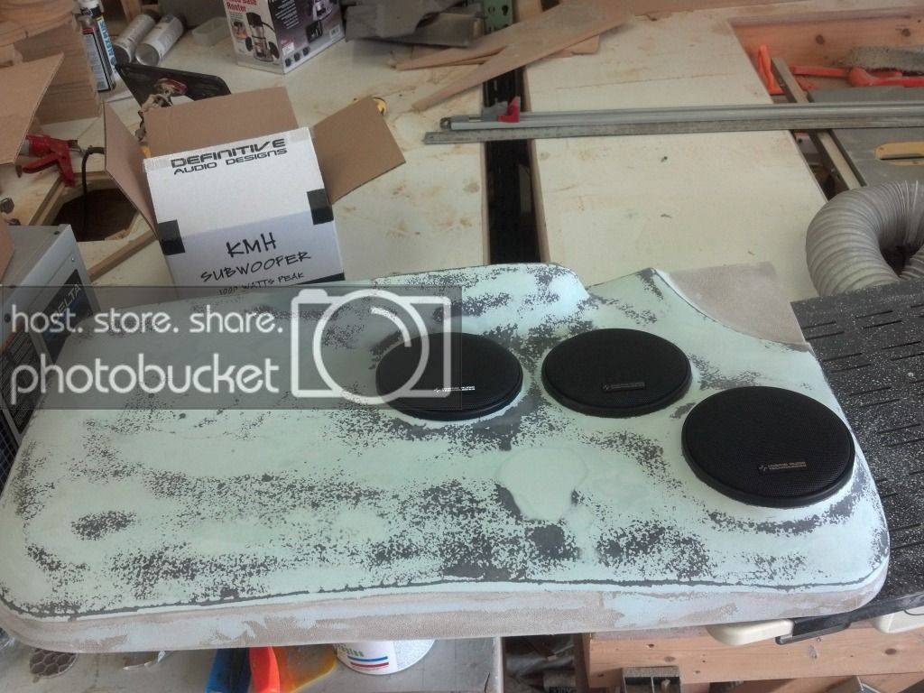

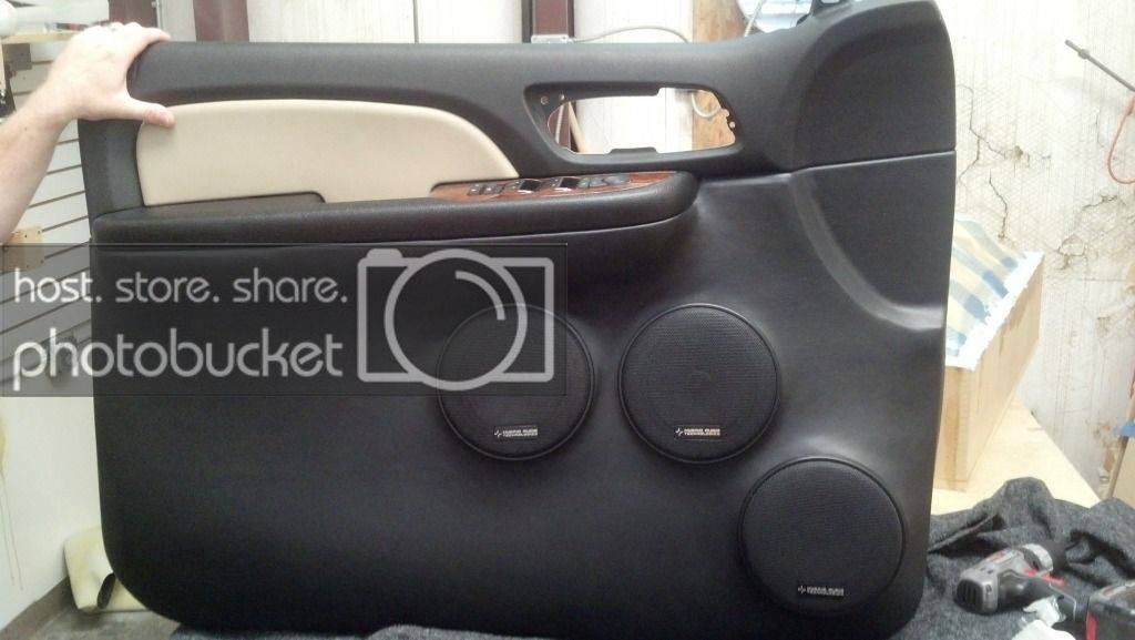

So got one panel ready today to be wrapped. Talk about alot of sanding, took me all day for this one panel.

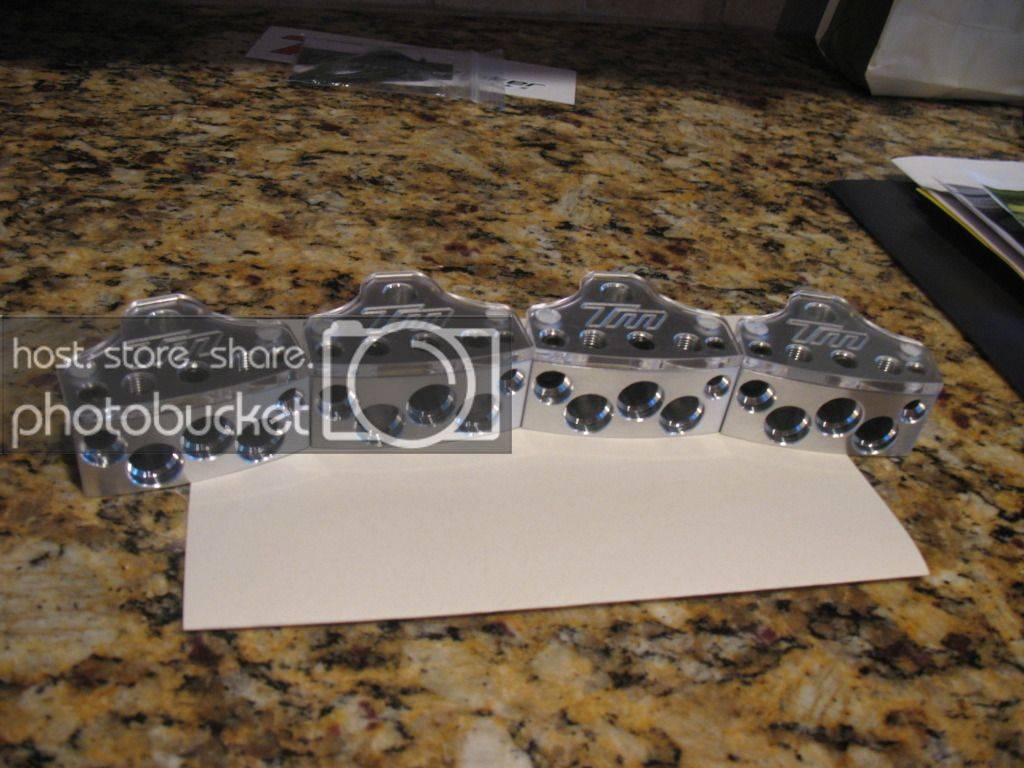

Got me some goodies today! Thanks again Toolmaker!!

Final drive door finished, should have the passenger finished up tomorrow.

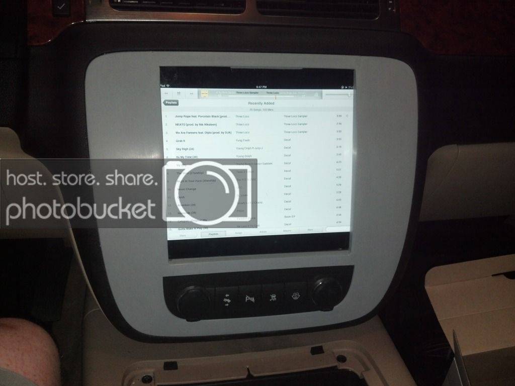

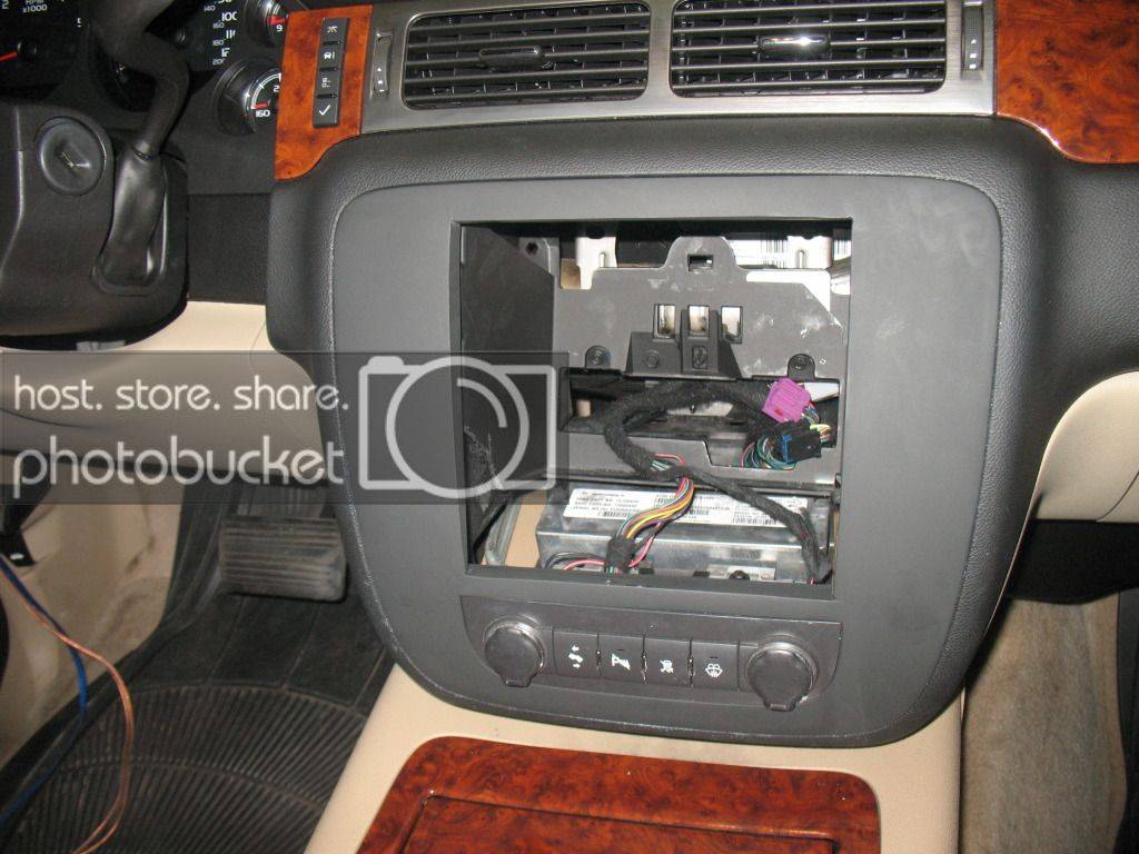

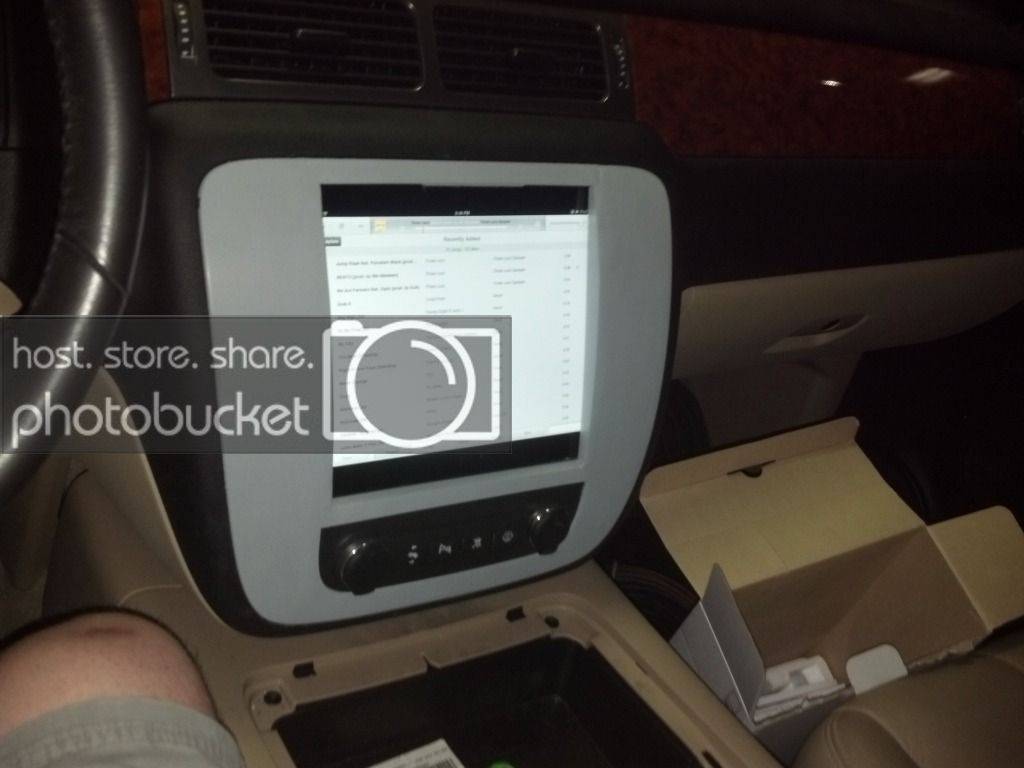

Got around to getting the Ipad installed in the Tahoe. All that is left is some finishing sanding and have it hydro dipped to match the rest of the wood trim.
Tons of sanding to make this thing next to perfect.

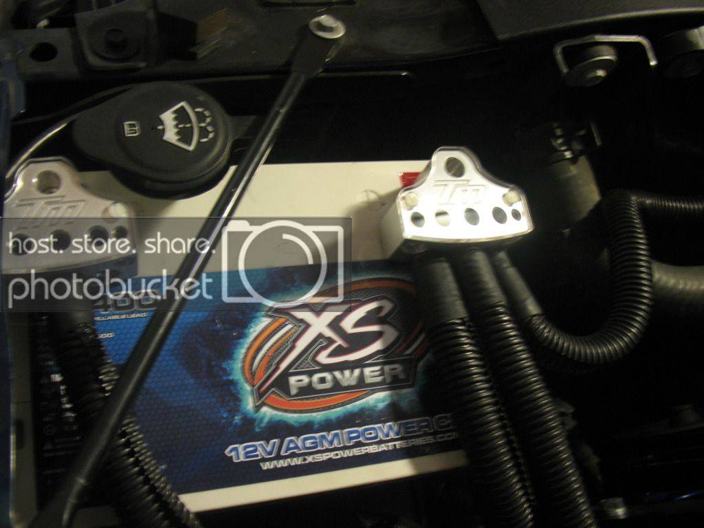

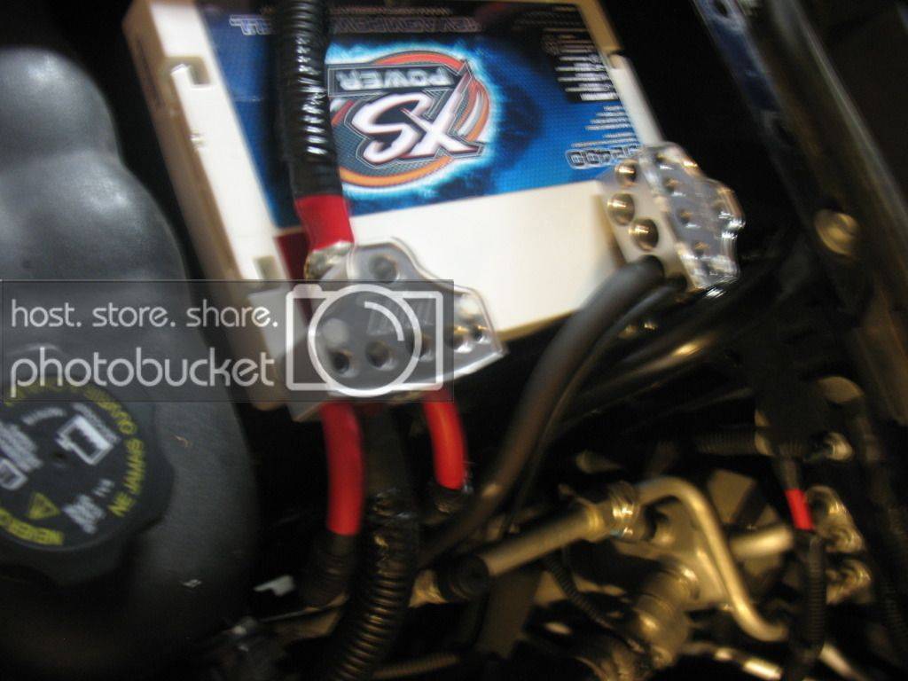

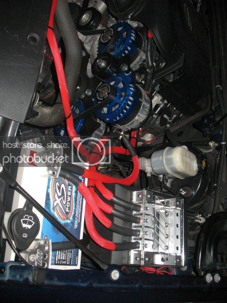

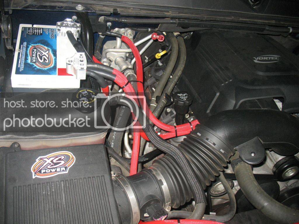

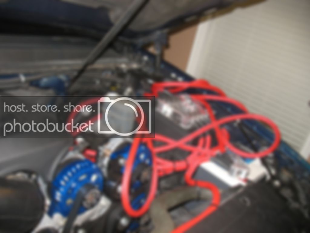

Decided to get fancy with the wiring just for that clean look and should add a bit of protection to the wire, black looms were just kind of meh.

how do you get to the iPad home button?
You don't it stays on while I am in the vehicle and gets pulled out when I get out. If I feel I ever need a button I can add a push button on a spring pretty easy. The top of the trim panel is held on my neo magnets and the bottom retained the factory clips so It is very easy to take it in and out. Also the Ipad uses this for charging and connection to the 80PRS. Composite A/V Cables for Mobile Video Systems
