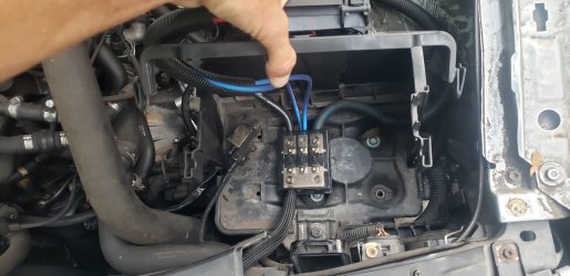

Managed to get the wiring under the hood done and added the fuse in the cabin. So now I just need the alternator and I should be ready to go.

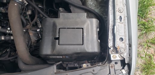

Airbox is still out of the car, but once it's in you shouldn't be able to see the main power wire going to the battery.

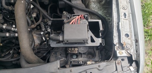

Factory fuse panel still in stock location. I couldn't fit a 0 gauge ring terminal on it, so I smashed a pair of 8ga wires into a 4ga terminal. The run is only like 10 inches and it's fused for 100a.
New fuse block from knukonceptz. 200a for the starter, 100a for the factory charging lead/fuse panel, and 300a for the run to the back.
I may end up needing to switch the position of the main power wire to the shared block and add an in-line fuse holder if I pop a 300a fuse. If I start blowing 300a fuses I'll have to look into adding a second run of 1/0 to the back for the battery. I'm fairly sure the knukonceptz 1/0 is good for 450a at 15' and I believe my run is just under 12', but I'd rather be on the safe side.

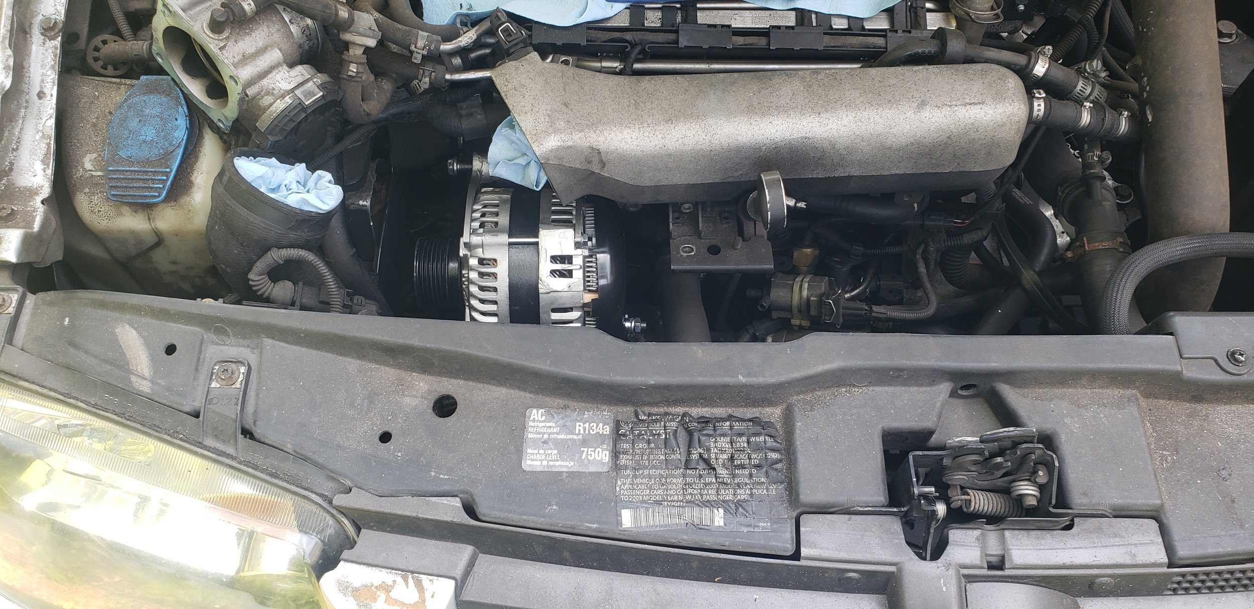

Alt is in, I had to take off the throttle body and inlet hose to get it in place, lol. Hopefully I'll get the amp "rack" wired up on Tuesday and move on to getting both subs installed.
