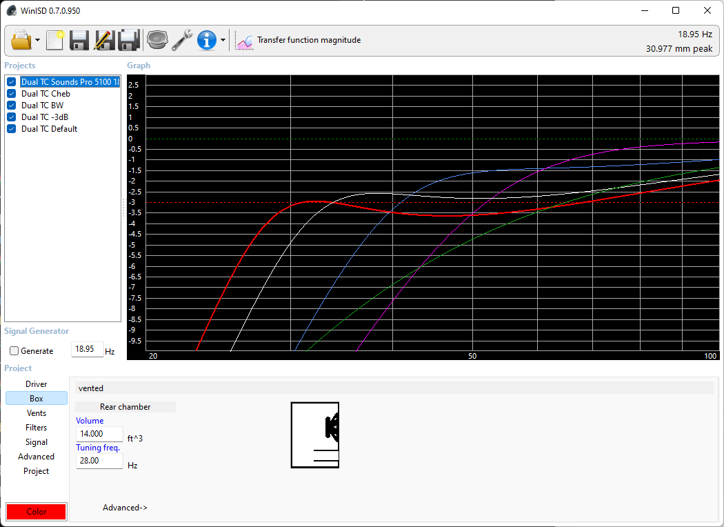

I had someone much smarter than I am do a few plots on a pair of these in 14 cubes. Funny thing is, these subs appear to want a small enclosure and LOTS of power. For example here are 5 different plots, 2 of the pro 5100s on 3k for each. None of these come anywhere close to Xmax, and the 14 cube enclosure still doesn't reach Xmax until damn near 15k with a proper subsonic.
Red = 14 @ 28Hz
White = 10.7 @ 31
Blue = 6.6 @ 37
Pink = 3.8 @ 41
Green = 4.6 @ 27
Doing some figuring, but this may end up being almost a home-theater type enclosure with how the driver behaves. Should have a cabin resonance plot done today and then the real work can get done.
Red = 14 @ 28Hz
White = 10.7 @ 31
Blue = 6.6 @ 37
Pink = 3.8 @ 41
Green = 4.6 @ 27

Port area is going to be HEAVILY dependent on tuning and power. So far it's looking like 100 square inches is good for the 28hz tune on my power. If I decide to throw a SALT12k or something on it, I can only fit 170 square inches, but my port noise is minimal.
I don't trust WinISD, so take those numbers with a grain.

With that size box and that much cone area, I’d want to at least double that to 200 sq in . I know it’s easier said then done lol. With the enclosure I did, I wanted 120 sq in but had to settle on 117 to comprise and get the tuning I wanted. You are dealing with an enclosure that is double the size tho lol.
