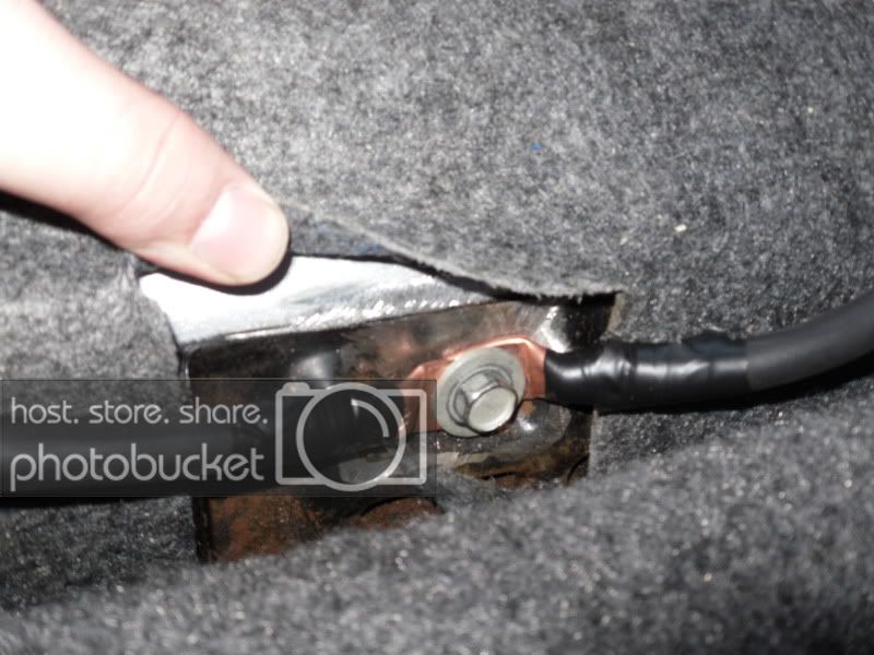

I sanded down the chassis and that bracket and got a good solid ground, and it's still doing it. I think im going to try one of those rca noise filters next, maybe that will work?

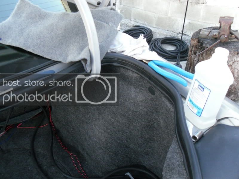

More pics will be up from todays work soon, they're uploading.

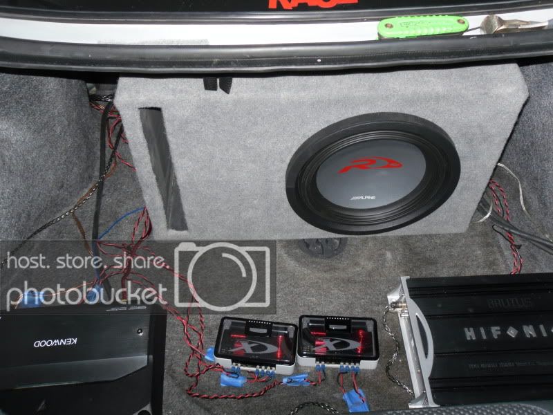

Did a little tidying today, along with sanding down the frame to make a solid ground. Still getting the speaker whine though, so i guess a RCA noise filter is next.

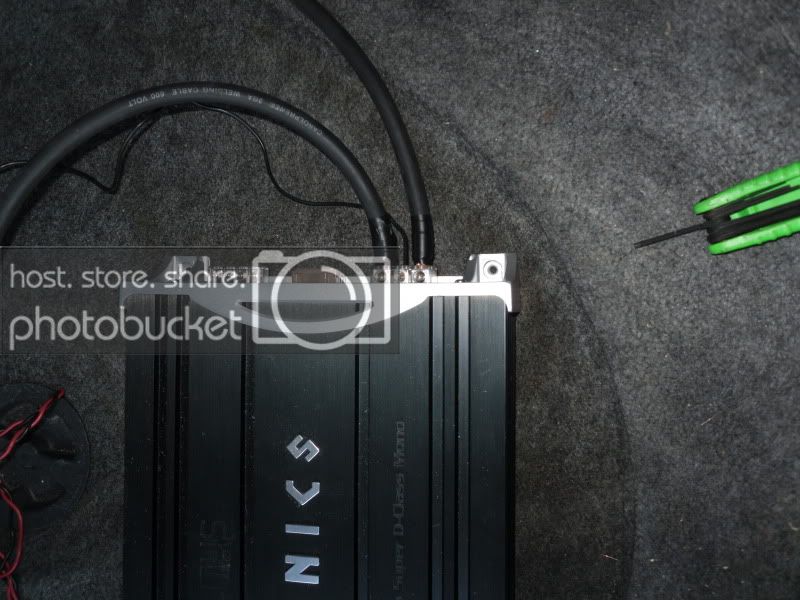

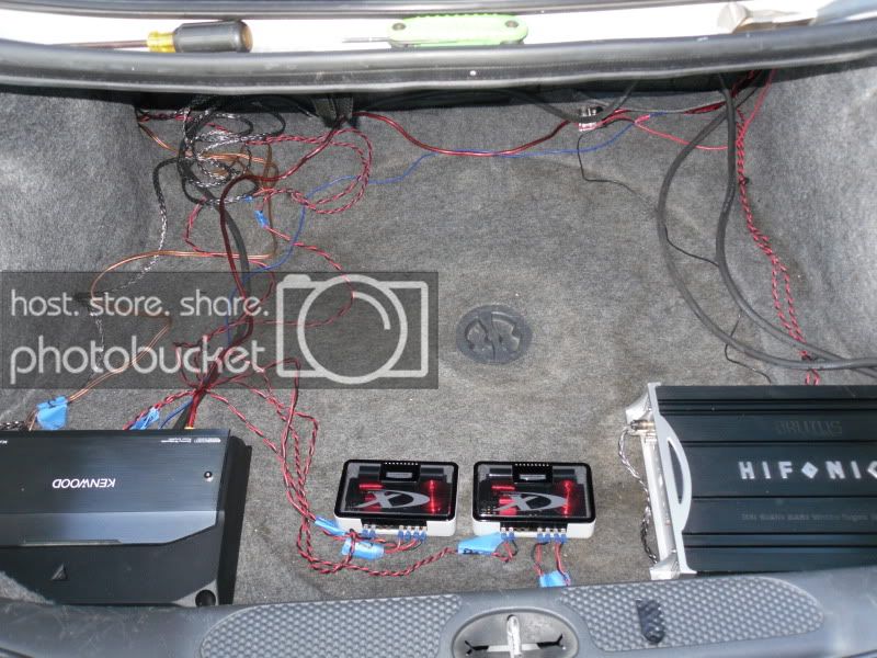

Cleaned up the connections a little
Grounds, maybe i'm doing it wrong?
Cleaned up a little

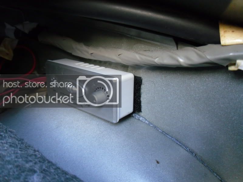

Controller for the LED's tucked away and Velcro'ed

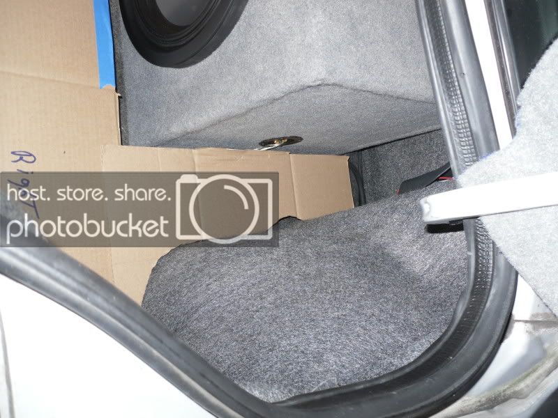

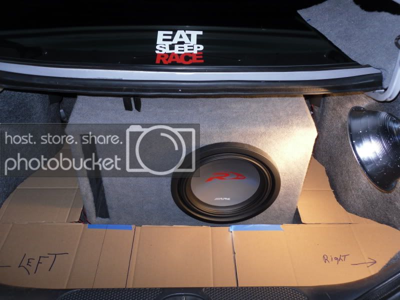

Box in

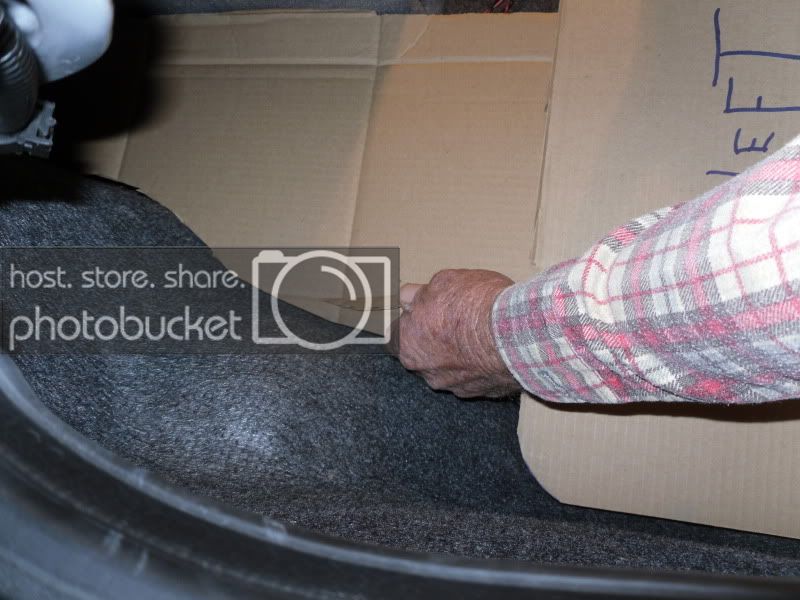

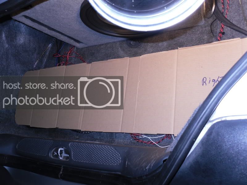

Cardboard for fitting the amp board and getting the proper corners
Grounds are right..what exactly is the noise? How loud and such is it..and what's your plans with the cardboard
The noise comes from mostly the tweets i think, when i turn the radio on (car off, or on doesnt make a difference) it sounds like your tuning an old dial radio, like you're trying to find the right frequency. And it just keeps doing it, when the music plays you can't hear it, but any soft spots in the music or when changing songs you can still hear it. not extremely loud, but you can hear it if you're not looking for it
The cardboard is just like a floor plan so i can get the right cuts when I do the plywood tomorrow. The plywood will be carpeted with cutout's above both amps and the x-overs with plexi glass on the bottom side so you can see the amps and x-overs, but all the wiring will be hidden. Just like a false floor.
