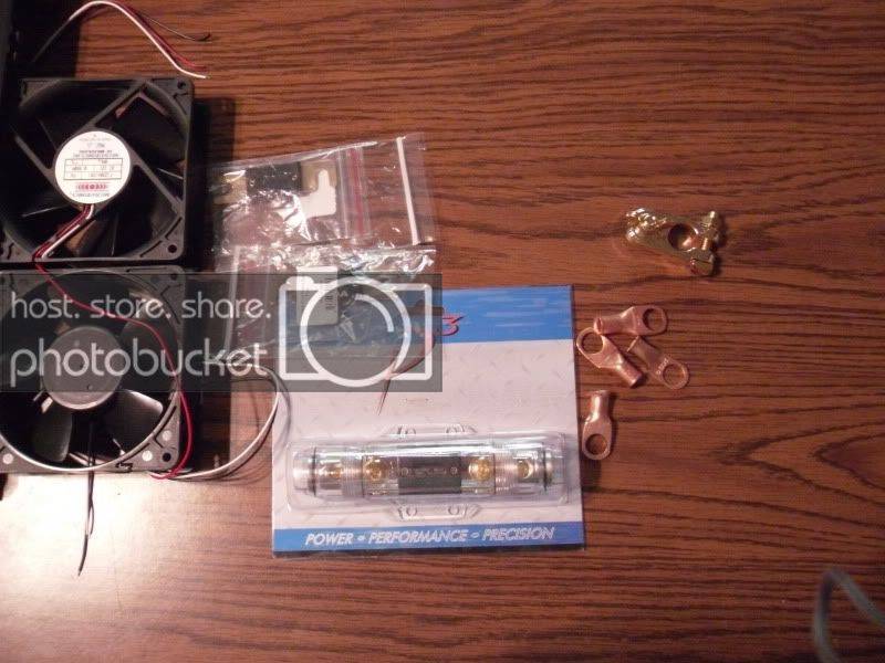

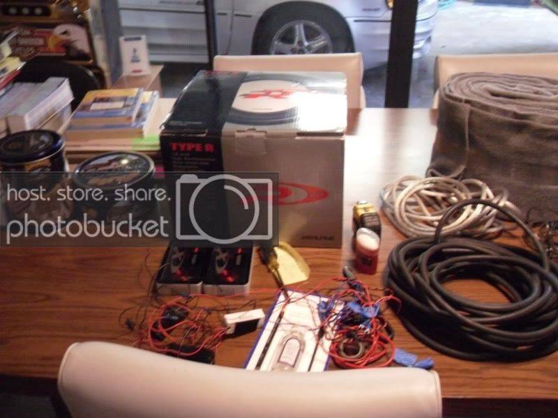

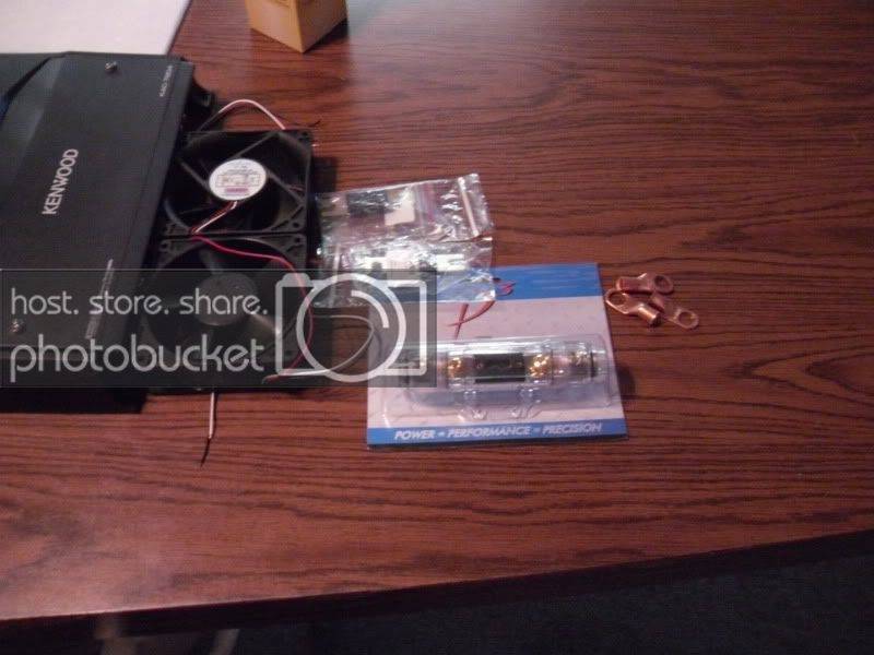

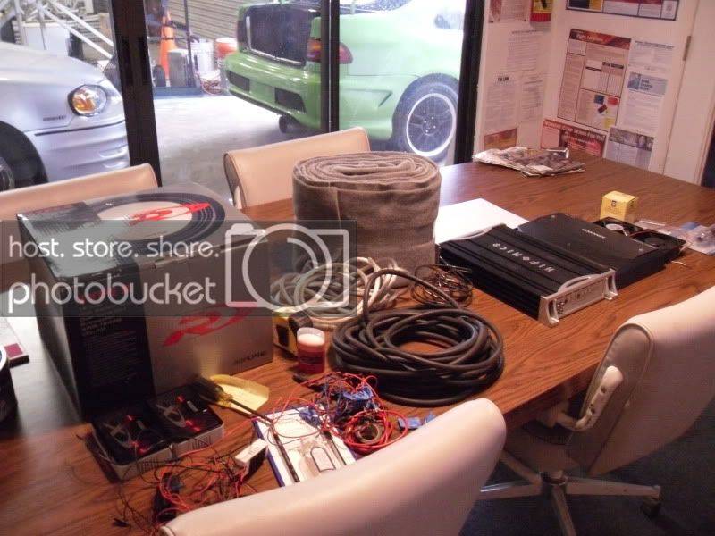

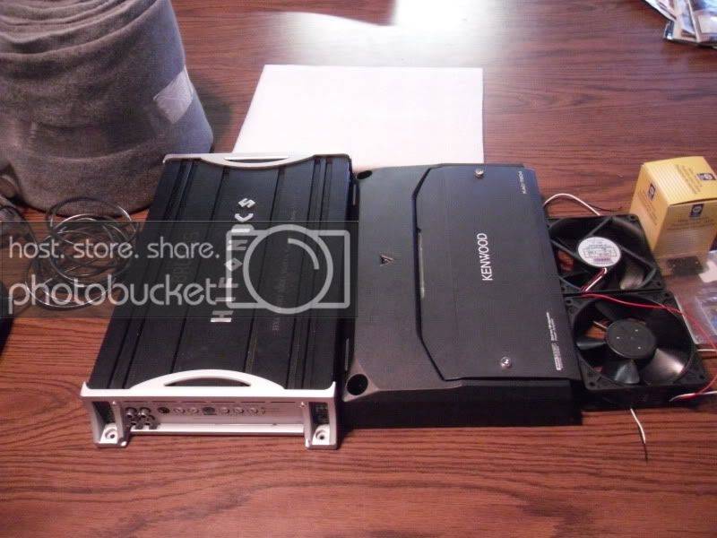

I took out the thunder and the MTX amp, put the Kenwood on the doors and picked up a Hifonics BXI 1610D and a 12" Type R.

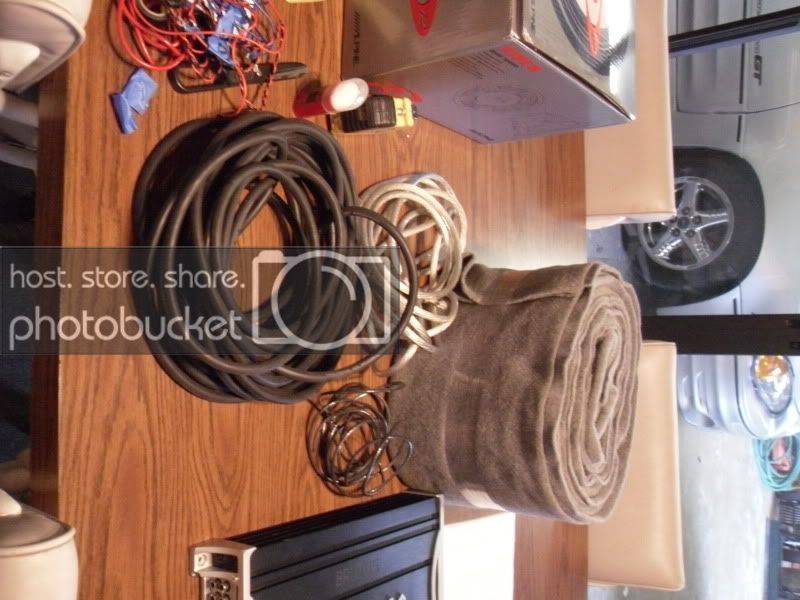

40ft of 2ga welding cable
3ydx40" of grey automotive carpet
150A 2ga ANL inline fuse
battery post terminals
2/0 ring terminals
10ga wire for the speakers
2x 120mm fans
some mdf
plexi glass
and some other stuff.

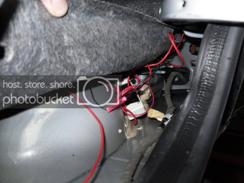

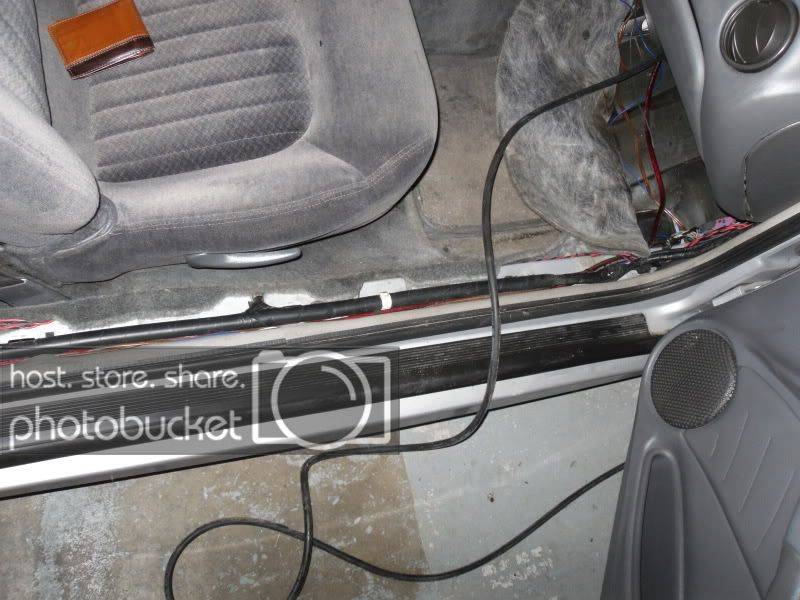

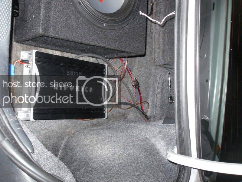

Nothing in the trunk, other than the wiring for the mids and the old 4ga wire thats now on the kenwood

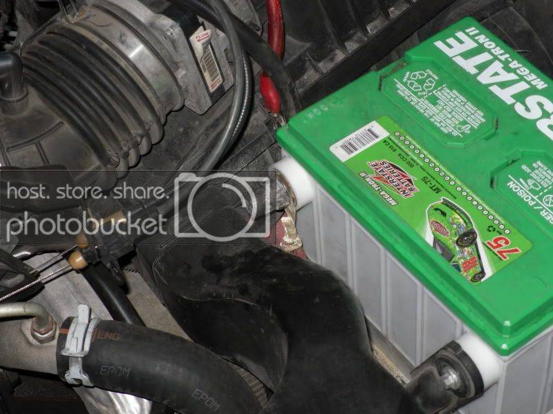

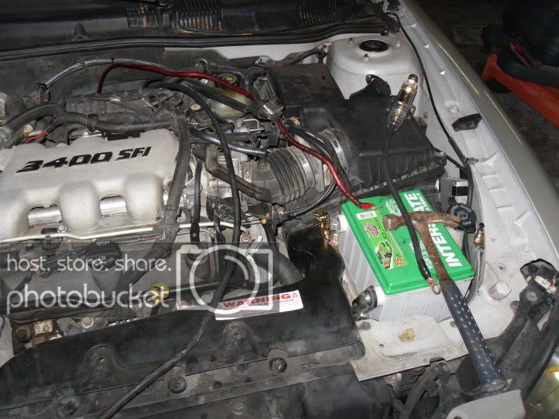

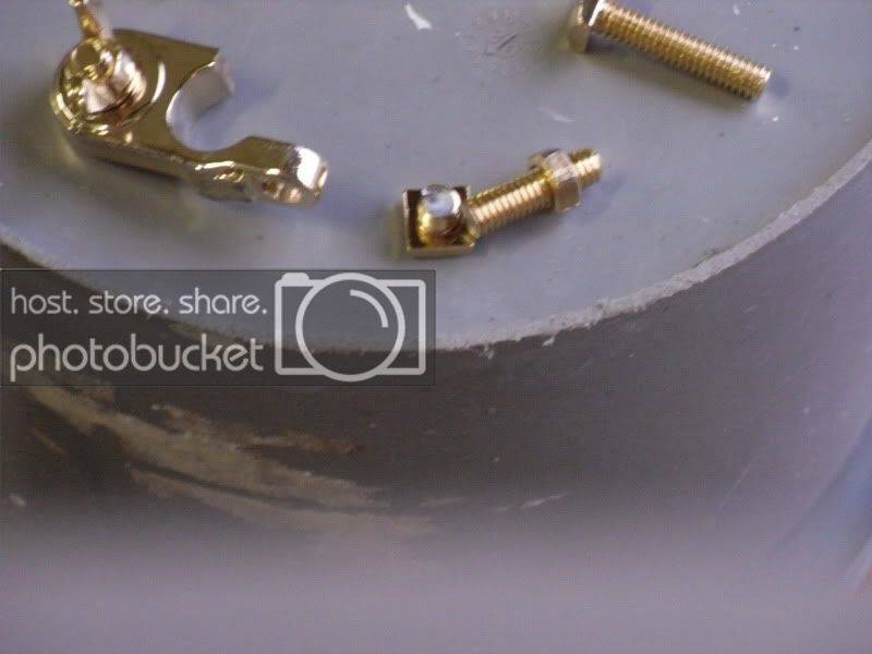

Lug on the side post battery, i bought battery post terminals then realized they wern't going to work so I went to my mechanic and he hooked me up with one of those battery lugs, worked like a charm.

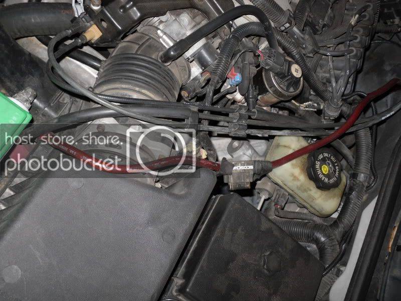

4ga with a maxi fuse

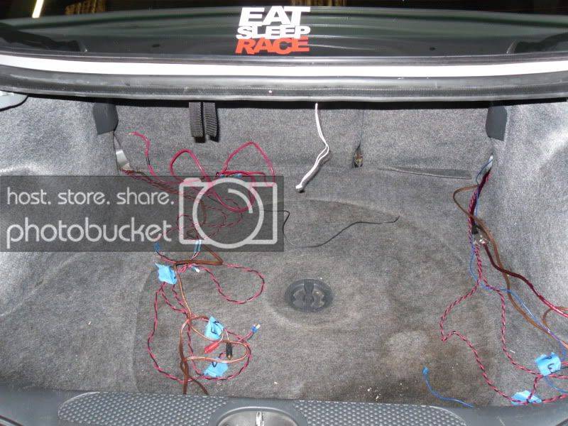

Nothing in the trunk but the speaker wire to the fronts RCA's and the 4ga for the kenwood

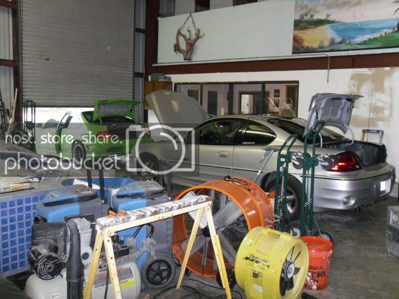

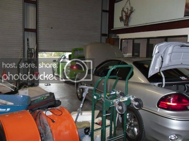

My friend's Honda and my GA in the shop because it was raining all day

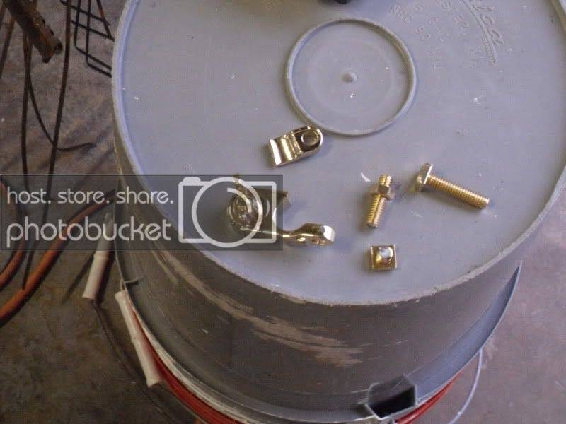

I tried to get the battery terminal to fit on the battery lug but even when i tightened as hard as i could it was still super loose so i put it in the vice and 2 rotations later i snapped the bolt in half. Then I took the vice and closed the end to make the hole smaller, but ended up over doing it so i tried to open it back up and the thing just cracked in half, i was pissed lol.

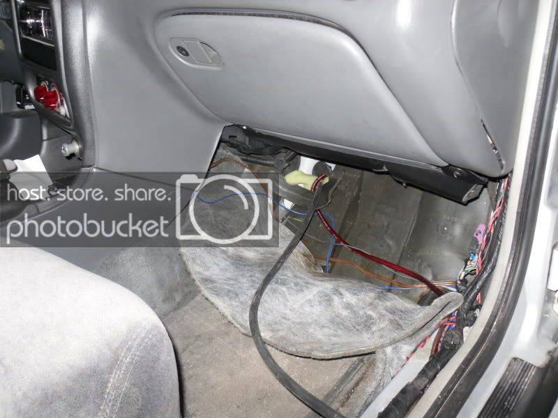

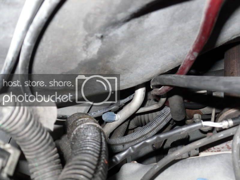

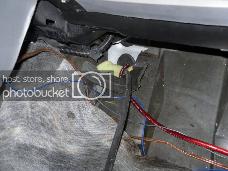

Power wire running through the firewall
Just wired everything up, the grounds that were in a picture above were wimpy little 8ga grounds and those have been tossed, they were replaced by 2ga grounds.

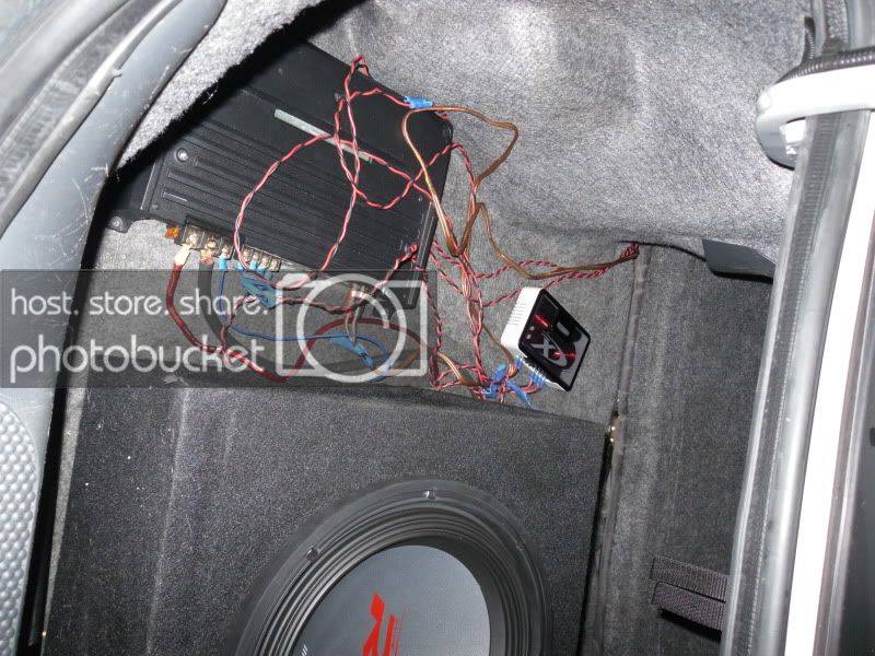

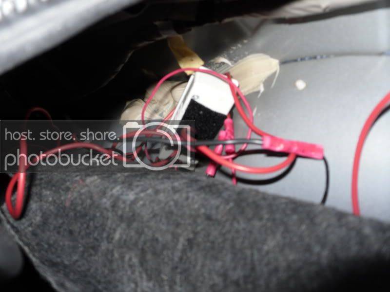

I have some cathodes i'll be using later on that i wired up and tucked behind the trunk carpet

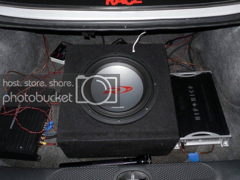

That's all for now, everything has been wired up and just tossed in.

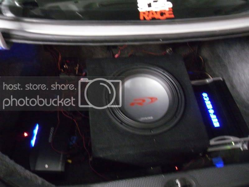

The sub is in that prefab box as a temp 2 day thing until my custom box is ready, the one andy is working on. 2.25cf @32hz.
I just wanted to see if the sub and amp worked so i tossed it in that prefab sealed box for now, that thing slams in that box so I can't wait until i put it in the good box.
Everything is working fine but one thing, i can't figure it out. when the volume on the deck is low, the speakers emit this whining noise it's really high pitched like the ringing you hear in your ears and really annoying, but you can only hear it if you press your ear against the pillar. I was thinking it might be from running both of the power wire down the same side of the car? I have no idea, but i figured i'll trouble shoot it another day, it doesnt bother me right now and i wont be running it a lot.

Nice little upgrade. Could definitely use some cleaning up, maybe on another rainy day? Or when you put your next box in. Is that type r a dual 2 ohm? Curious as to how the sub is handling the hifonics!
Your terminal that you snapped looks very similar to the ones I bought a while back and just couldn't get a good grip on the battery posts. Very annoying, and ended up buying something else that worked. It seems that style of terminals are junk, just don't grip for crap!
witch side did you run your rca's, could also be a bad ground, is your deck a pieneer?
The RCA's are run on both sides, Sub RCA runs on the passenger side and the fronts RCA runs on the driver side. A bad ground is very possible. And the deck is an Alpine iDA-x100.
Something I noticed is when the Hifonics is disconnected from the battery under the hood, the whine goes away. Very strange

holy rat nest
Yeah it's getting cleaned up tomorrow i finished at midnight and had to type a 5 page paper, so i just tossed everything in. The sub is dual 4ohm, wired to a 2ohm load, and it handles the hifonics without any trouble. the hifonics doesn't get remotely warm, and the sub doesnt get distorted or smell like burning coils. Throwing around 750rms to it right now. I'll probably bump it up to 850-900 rms once i put it in the new box.
The terminals are junk, i got them off of parts-express, it was $14 for the pair. complete junk, i had to crimp the one i had left together with a vice, then take off the battery lug, and beat it to death with a hammer to get it to go on. it's on there though, it's really on there lol

thats alot of wire just laying around in the trunk
You're telling me, it was a PITA to label all of that crap so I didn't forget what's what. it will look much cleaner by saturday, providing the box is done on time.
One of the biggst hack jobs of wiring Ive ever yet to see dude
Thats horrible, connections look like shit, bare exposed wire at alot of them, button this up, and make an amp rack to tidy it
For the money you spent, you coulda done alotta better on both equipment and install
lol, you must have not read the entire thing, it will be hidden within the next day or two. it's still under construction.
I finished at midnight and making it look neat at midnight was not on the top of my list. it will be cleaned up.
Even on my worst day just testing, I dont twist wires and have bare xposed connections and loose amps. Finishing at midnight is no excuse, if you cant do it proper and right, why do it at all
Do it right the first time, run wires neatly, use zipties and dont cut 1" of insulation when only 1/4" is going into the amp terminal, leaving the rest out to get shorted on
