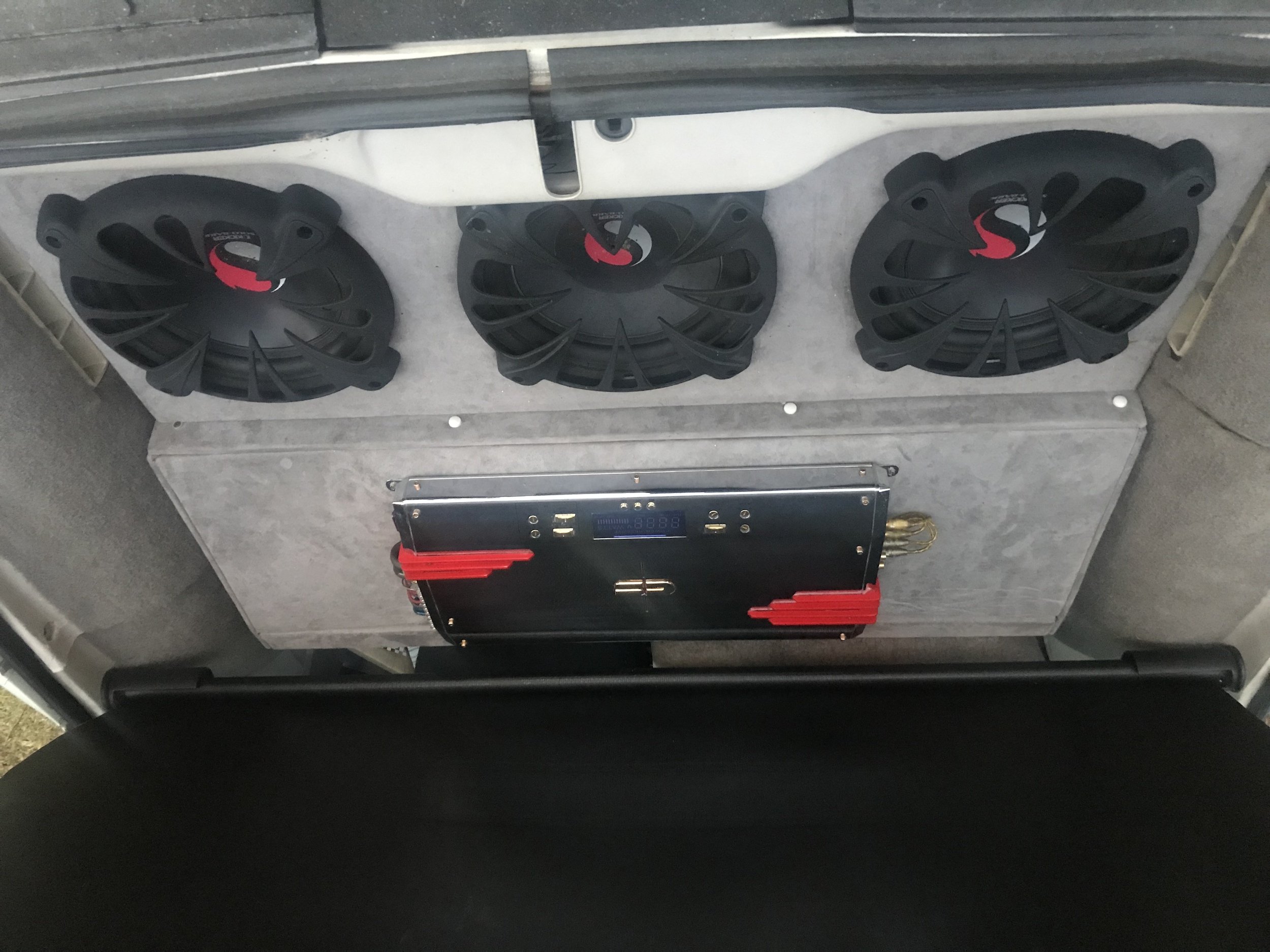

Hello. I recently picked up this little setup, the cadence 1000.2 with a skar 1200 12 inch and I want to know how to wire it best. The sub has DVC at 4ohms and the amp has a bridged 4 ohm output. How should I wire it? Thanks for your time. (Sorry but I’m a noob lol)
Your best option with the equipment you have is to wire the coils in series and bridge the amplifier at a 8 ohm load.
Unfortunately that is only going to get you 130 watts rms.
Awesome. Thanks. That might’ve been how it was when I got it but I’ll check. It performs pretty well for what it is in my opinion. Thanks again.
