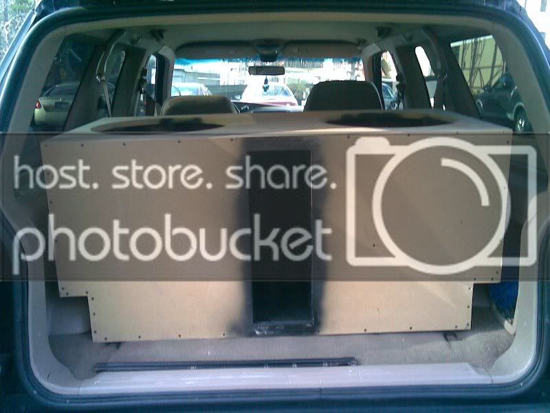

i calculated about 15 cubes if i build a part of the box between the wheel wells, and then another part of the box wider above the wheel wells. so i think im in luck. this is also assuming i have the box about 6" from the rear hatch.

heres what im talking about with the notch thing. this is 2 18" q's in an explorer sport that derrick linked me to.
