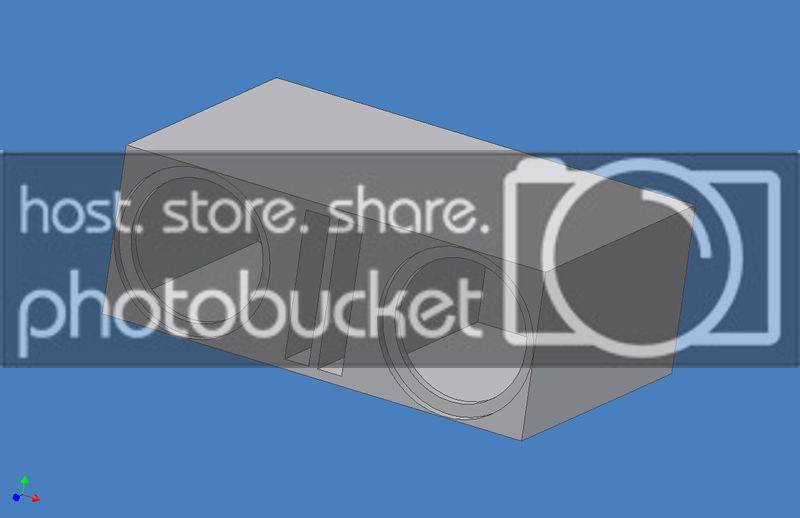

i got a set of plans from Mikey B on here for a box that will fit in my car. Thing is i want to *massage* it a bit if possible.
This i what i have:
The only thing i really want to do is make it maybe 1" to 2" taller and i either want the ports on each side, or i want to have one big port in the middle.
Also, what is the net vubes of this box? I'm looking for ~4cubes @ 30-32hz
ok, just finalized the amp deal, now this is the last part. can anyone look at this and see what can be done?
if i get nothing i may just flop the ports to the outside and build it the same. just need to be sure it's 4 cubes @ 30-32hz

I built this one from the box sticky:
4 cubes net at 30Hz
it'll be subs/port toward the cabin. the reason i want to go taller is (a) i want it to protrude less into my space in the trunk. i'd like to have some room for stuff back there (b) i want there to be more "meat" around the subs. the recessed part gets really close to the edge

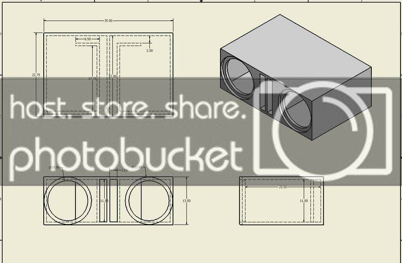

ok, i got a new idea.... i'm gonna come up with a box so that i can build an amp rack INTO it. i will try and roughly draw it out with some dimensions. if i do that, who can i get to actually take my idea and make a plan out of it? willing to drop some cash for a good plan. it won't be complicated, actually pretty basic IMO
meh, i'm super lazy. if i can get the box plan THAT will motivate me to get it done. but thats the only part i need help with //content.invisioncic.com/y282845/emoticons/crap.gif.7f4dd41e3e9b23fbd170a1ee6f65cecc.gif
ok. won't be back on until monday though. i should have it sketched by then.
BTW, my sketch will probably be MS paint, or a picture of a hand drawn sketch. i might be able to draw it up on my estimating program, but i doubt it... //content.invisioncic.com/y282845/emoticons/crap.gif.7f4dd41e3e9b23fbd170a1ee6f65cecc.gif
