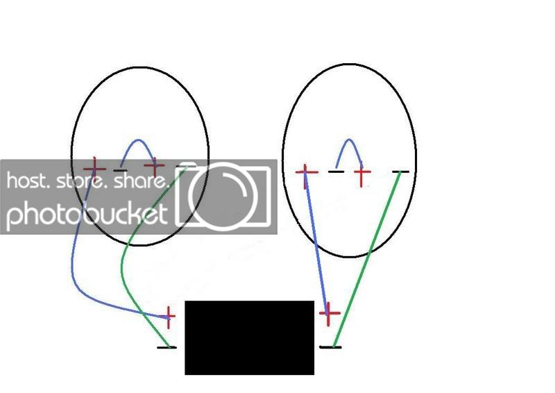

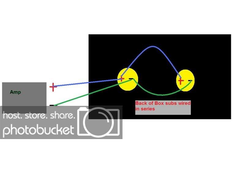

As said many times you cannot possibly run 2 DVC 4ohm coil subs at 8ohms.
For the pdx-1.1000 wire it at 4 ohms and you'll be sweet, it's underrated and should have plenty of power. Wire the coils in series and the subs in parallel.

when u say wire the subs in series and parallel, i think i got that done. lol heres wat i just drew to show u how my wiring looks like.
or shall i just do it like this?
