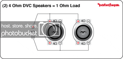

well thanks everyone for the input, i will look into getting a ported box. as well as rewiring my subs. this is how i currently have them hooked up.
now should i hook them up to this?
now will that make my subs into a 2 ohm load?

this will be a 1 ohm load wired like the second pic. check the specs on the amp and see if it is 1 ohm stable, if so then run your subs at a 1 ohm load. if not, stay w/ 4 ohm until you can get a 1 ohm stable amp.
