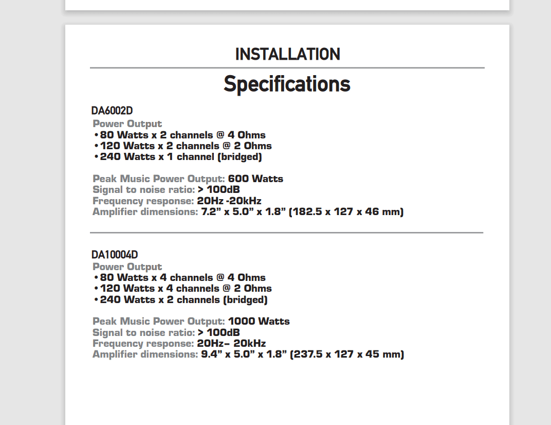

If you look on the first page
manual, and then go to page 10, you will see it is 240w x 2 (bridged), (unknown Ohms), but page 8 tells you it is 4 ohms. This doesn't seem right, and neither does their wiring.

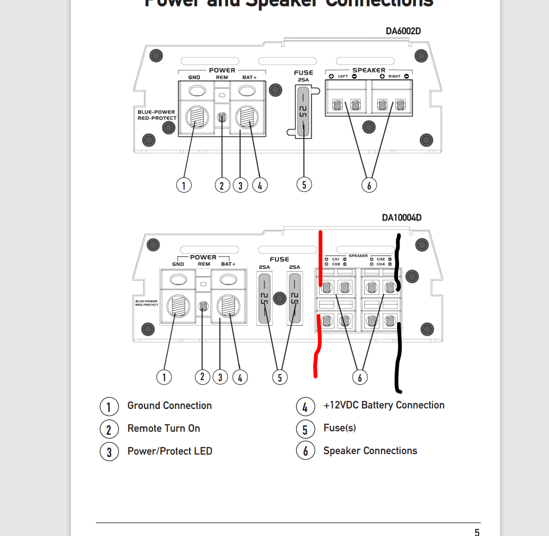

Here is how you wire the amp.
You're going to want to use the two kickers, and you're going to be a little light of what they can do at RMS.

You need a different amp. That amp puts out the following:
Power Output:
•80 Watts x 4 channels @ 4 Ohms
•120 Watts x 4 channels @ 2 Ohms
•240 Watts x 2 channels (bridged)
First, it's not designed for the demands of subwoofer use, more for 4 speaker full band, coaxial or component use.
Secondly, ignore the max output numbers, they are completely irrelevant here.
Last, it will likely be pushed to clipping and burn up the subs at half their RMS capability trying to give you any menaigfull output.
