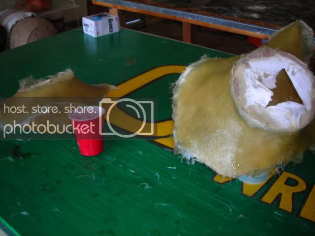

just a lil hint....on those pods where you have the mat over and it sticks up around the ring...in the future try to make that lay down as much as possible even if you have to put resin on it as you will end up with some nasty cuts and splinters and those sharp point will eat sanding pads to death..believe me...i dont went through that once...lol.

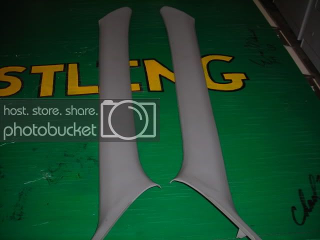

Time to start the a-pillars

Just a little tip
Ive done some weird shaped enclosures and I use a thick fleece so those "folds/overlaps" are pretty common on not being able to stretch the fleece perfect.
What you do is just get it as small as you can, glass your enclosure/pod but DONT glass that fold part, once the glass dries, you razorblade out that fold material, and put 1-2 layers of glass over that hole from the INSIDE, let it dry, then continue on with your other exterior layers. Youd never know the fold was there

Looks alright for a first tiem job, those air bubbles hurt strength alot, try an avoid that
Yea i had very few air bubbles. I learned that just going over the entire enclosure when its done and dabbing them out with your brush works well. I just figured that out when i was resin'ing the cloth
