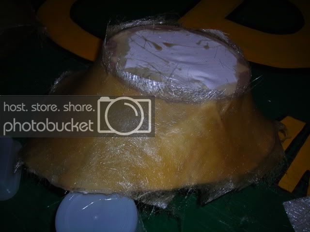

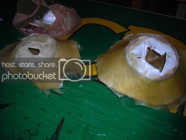

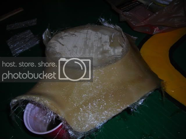

Ok so i got back from studying and layed a few layers of glass down. The f-ed up one doesn't look bad at all. One thing i learned when laying glass is that when its all down, go over it and tap out the bubbles and mat the stray hairs down it will save a ton of time in the long run.

wet:
dry:
Im going to bondo to kinda smooth everything out and be uniform. Then im going to stretch vinyl over it so it matched the interior of my car. I have spray painted pods/boxes, they look way to glossy
Not bad my man, not bad at all. You will probably need to ease some of those curves you have to vinyl them though. Vinyl on curvy arse kicks isn't fun lol //content.invisioncic.com/y282845/emoticons/smile.gif.1ebc41e1811405b213edfc4622c41e27.gif
textured satin paint would hide a lot of imperfections and not be shiny. I use that for sail panels when I glass in tweeters. Saves a lot of time on the finish sanding as it doesn't have to be perfect...
