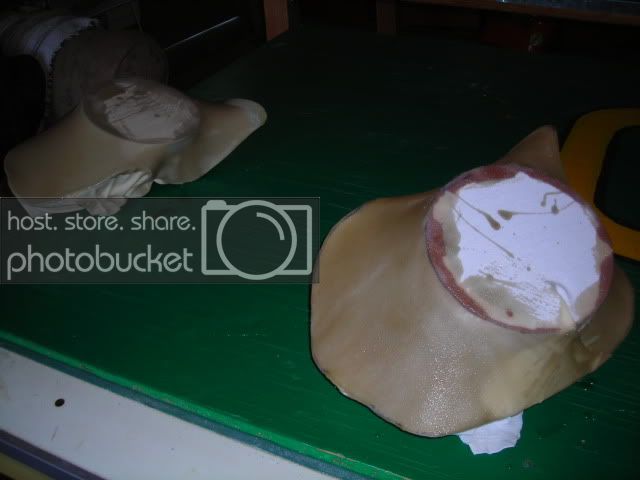

Holy lord man, are you building kicks or sub enclosures? Those things are huge //content.invisioncic.com/y282845/emoticons/smile.gif.1ebc41e1811405b213edfc4622c41e27.gif
Why thank you

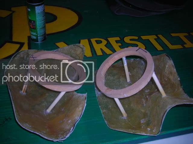

mock up the speaker pods first, then cut. use a die grinder, off of a compressor. i'm literally doing it right now lol. but u could use a dremel w/ a grinder wheel or somethin like that. look good though man, i'm buildin some now and u are on the right track. a little HUGE but yeah, keep it up
Yea thats a good idea. I just wanted a little headroom obviously theyre huge. Just didnt want to redo it again because glass and resin can get expensive.
Im wondering if i should recess the speakers to prevent tards from ruining them

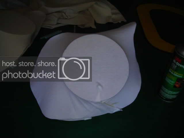

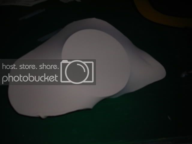

I was pulling the cloth over the panels and the white one was impossible to make perfect. For some reason the shape wouldnt allow it, i tried for seriously an hour but it would make it. so i have to fold it, im pissed. Ill just have to glass extra around it and just bondo the shit out of that panel to make it look nice.
YOu should have tried to wrapped the pods without having to fold what you're using to wrap:
Like that...
and X2 about the HUGE mold. Resin and cloth isn't cheap to be wasting like that. not bad for first time though.
I know i tried for over an hour wrapping a rewrapping but their was no angle and where the wrap would be perfect. I was using a material with spendex and for the messed up one i used a t-shirt which was helping the situation better than the spandex. But im just hoping after it hardens i can throw a ton of glass on that fold and hopefully the bondo will hide it.
and yea I know the molds where huge, it was my first time and i figured that making it extra big was better than starting over again. But now I know.
