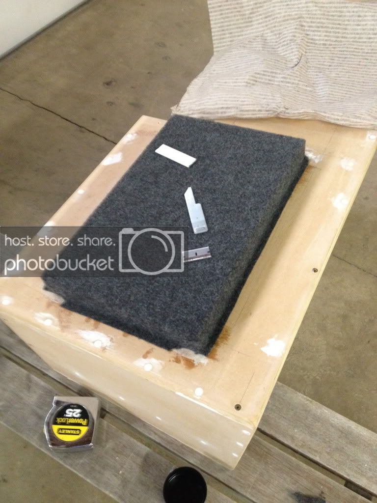

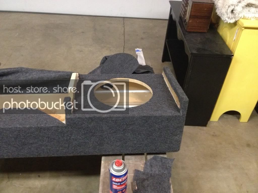

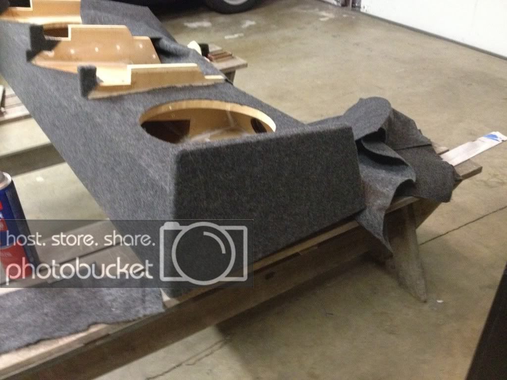

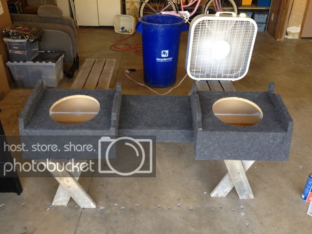

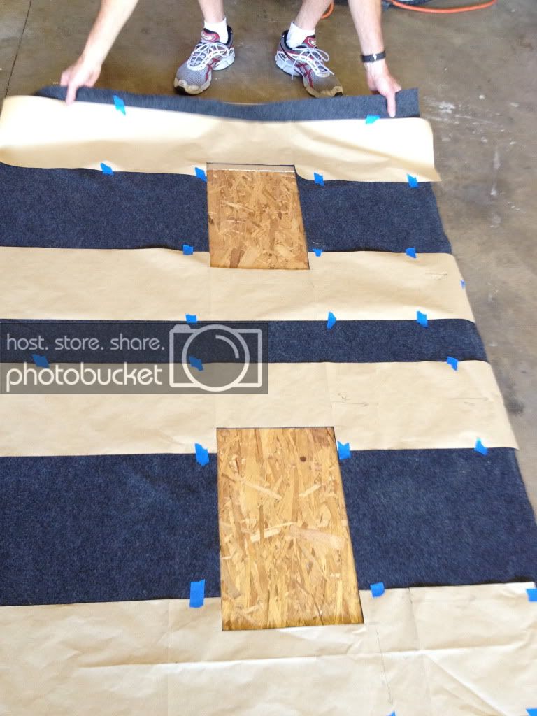

My box is really oddly shaped, and I've never carpeted a box before so I figured it would be best to do it in pieces. So here is the stages of it being carpted.
Started with the top, measured out the spots to cutout the pop-ups on the top
Top all glued down

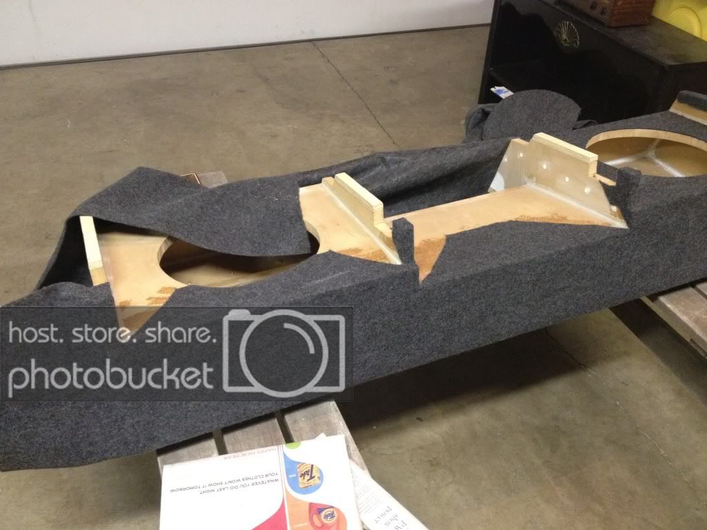

Then started on the front face
Here is the side that everyone would see with the door open, I tried to get it so you couldn't see any seems where people would look at the box. You can't see it in the pic, and you can barely see it in person, this side turned out great!

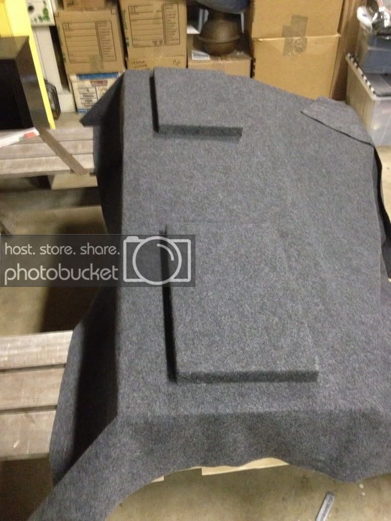

One side of the bottom all completed, you might be able to see the seems in the picture, you can see them in person, but I'm not too worried because you won't see anything except the top, front, and the one side of the box.
Working on other side

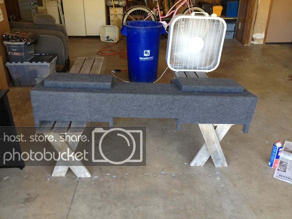

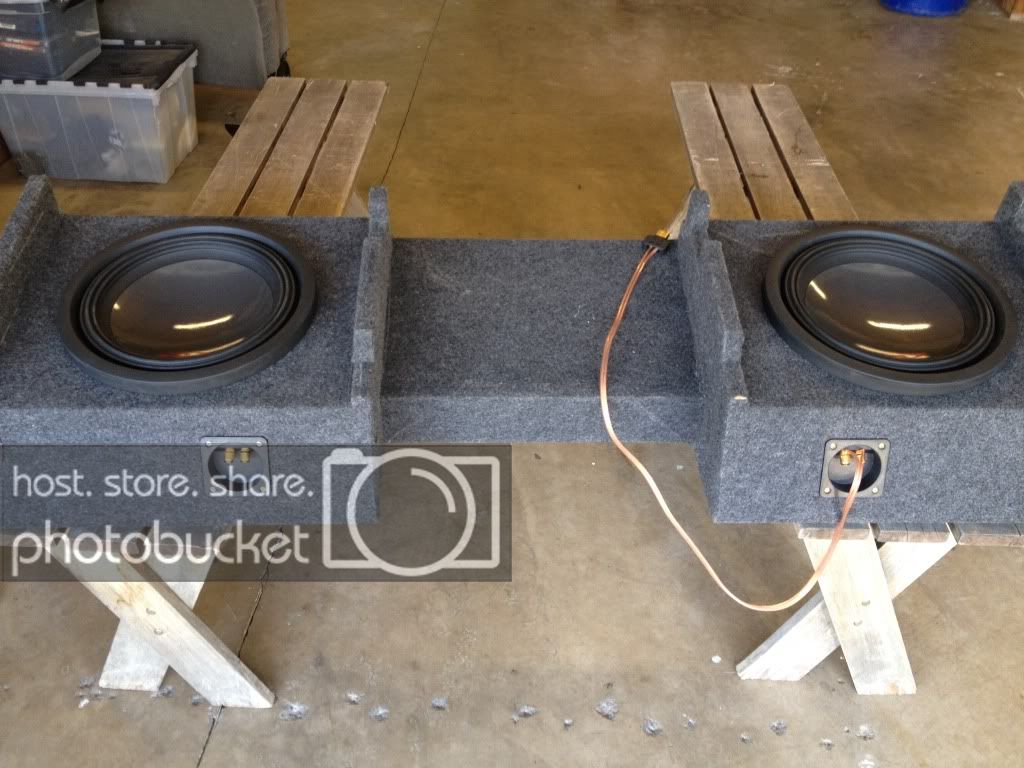

And the whole box done.
It may be one of the worst carpeting jobs, but it was my first time, and since I knew people would only see the front, top, and the one side I didn't worry about making it perfect everywhere else, nor do I think I would have been able to get it perfect everywhere.

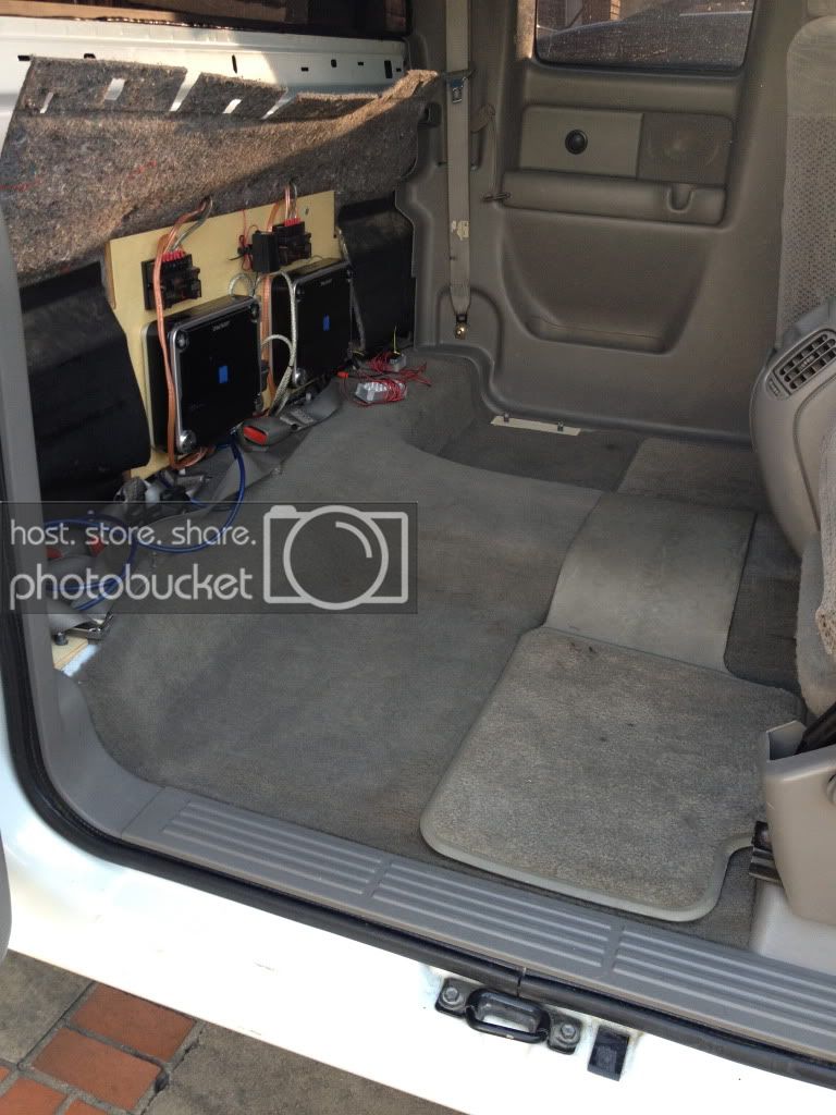

Before the subs go in minus the last minute wire change //content.invisioncic.com/y282845/emoticons/yumyum.gif.0556df42231b304b9c995aefd13928a8.gif

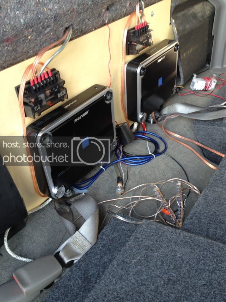

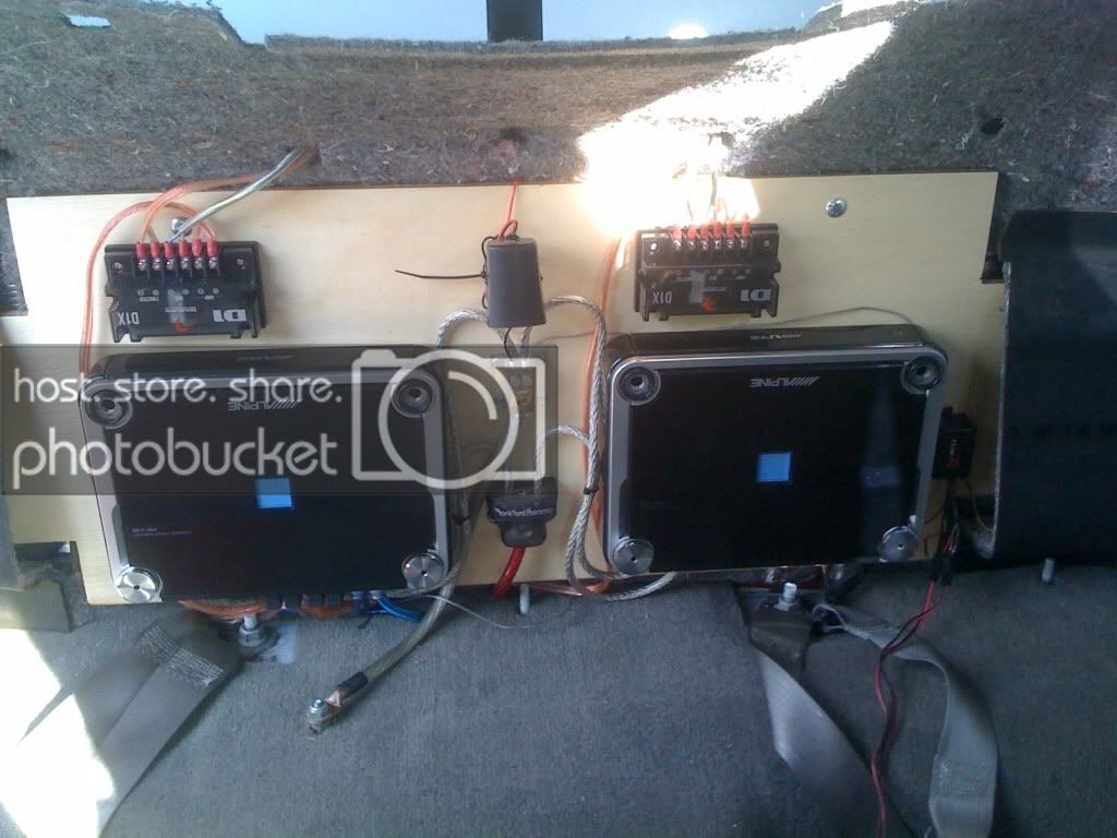

I decided to run a separate power wire to each amp instead of having set up running off the one 4 gauge like I did before. If you don't remember this is how it was
The power is distributed from 4 gauge to 8 gauge which then powers the amps. Now I ran an 8 gauge for the speaker amp, and the 4 gauge powers the subs, and got rid of the distributor blocks or whatever they are called. I also moved the piezo siren down closer to the floor so that it would be heard better inside the car. This is also a good comparison of iphone4s photos to the old 3g cameras. Top is iphone 3g, bottom is 4s. Now its not the best 4s photo I've taken but the clarity and light on it is a lot better than the 3g.

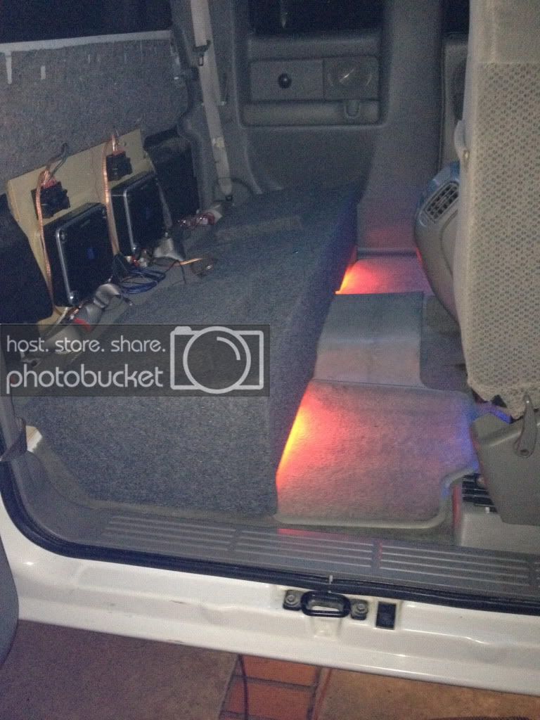

Each amp has its own ground. Here is a picture of it all installed, bolted down and everything. Sorry for the darkness, I will upload a couple photos of it in the daylight with the seat back in, as well as some videos.

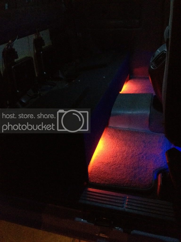

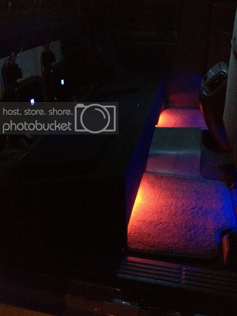

Now for some nice "ambiance" //content.invisioncic.com/y282845/emoticons/laugh.gif.48439b2acf2cfca21620f01e7f77d1e4.gif And in this picture you can barely see it, but there are two shiny things on top of the box, those are the bolts holding it down. It does not budge, nice and secure.
Thanks! As far as listening goes, its loud. It has clean crisp bass, and it does pretty well picking up the lows for a sealed enclosure. I really like the sound quality overall of the install, I was able to tune the amps so now the speakers aren't taking any of the lows, just the mids and highs, and the subs pick up all the low notes. Overall I'm very satisfied! On the whole carpeting thing, I was not a fan. It wasn't fun, nor was it easy to do on my box. I think I did alright for the first time, and would have done a lot better had my box been the conventional rectangular box.
