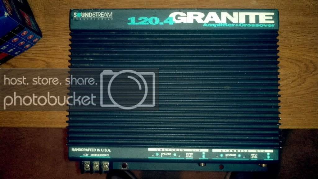

Headunit-
Alpine 9886

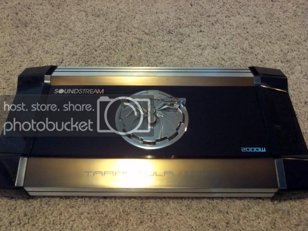

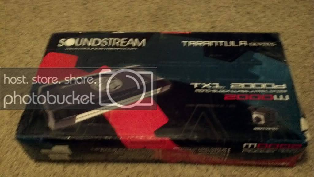

Amps-
Soundstream 120.4 Granite (old school)
Soundstream Tarantula TX1.2000D
Wanting a second Soundstream Tarantula TX1.2000D

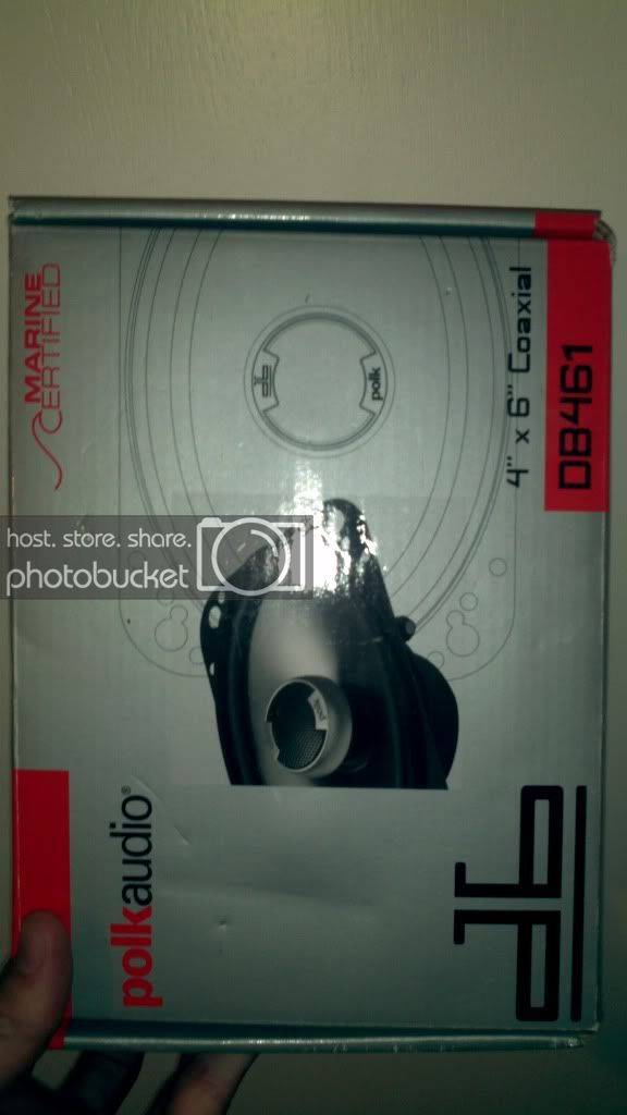

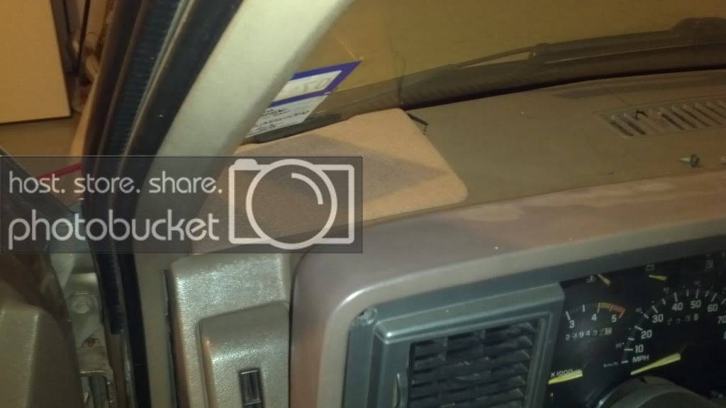

Speakers-
Front: Polk db461 -scratched due to mounting depth
Front: Infinity reference 4x6 6422cfp
Rear: MB Quart 6.5

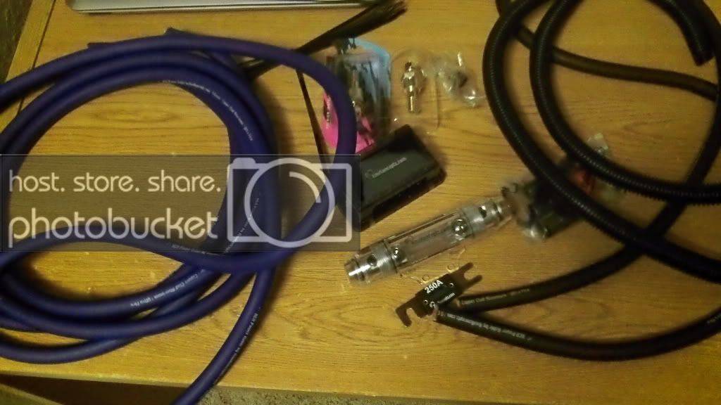

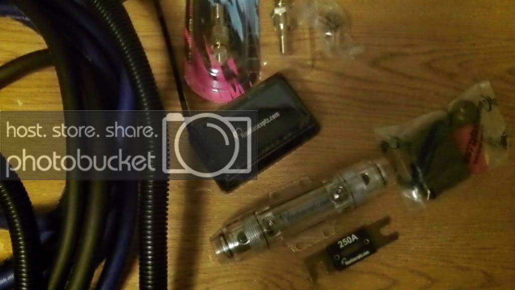

Wire-
Currently running one line true 4 gauge, looking to run 0 gauge to distribution or second battery (if needed or money allows) ANY SUGGESTIONS
Battery-
OPEN TO SUGGESTIONS
ALT-
Suggestions
BIG 3-
Wiring done

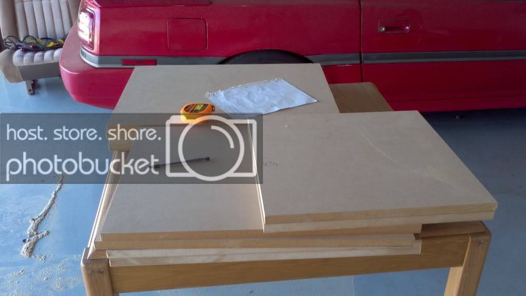

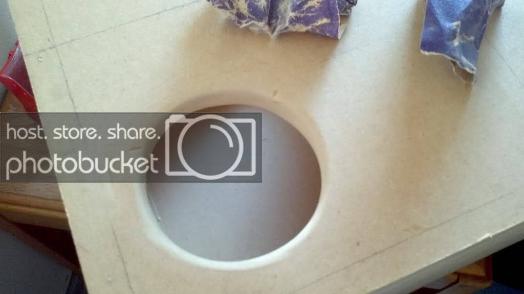

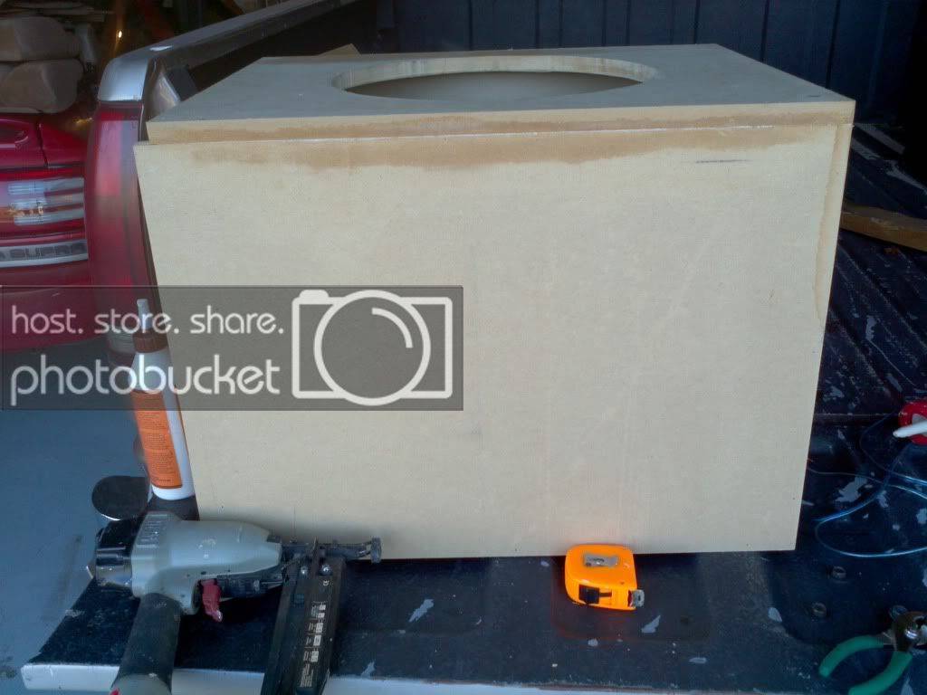

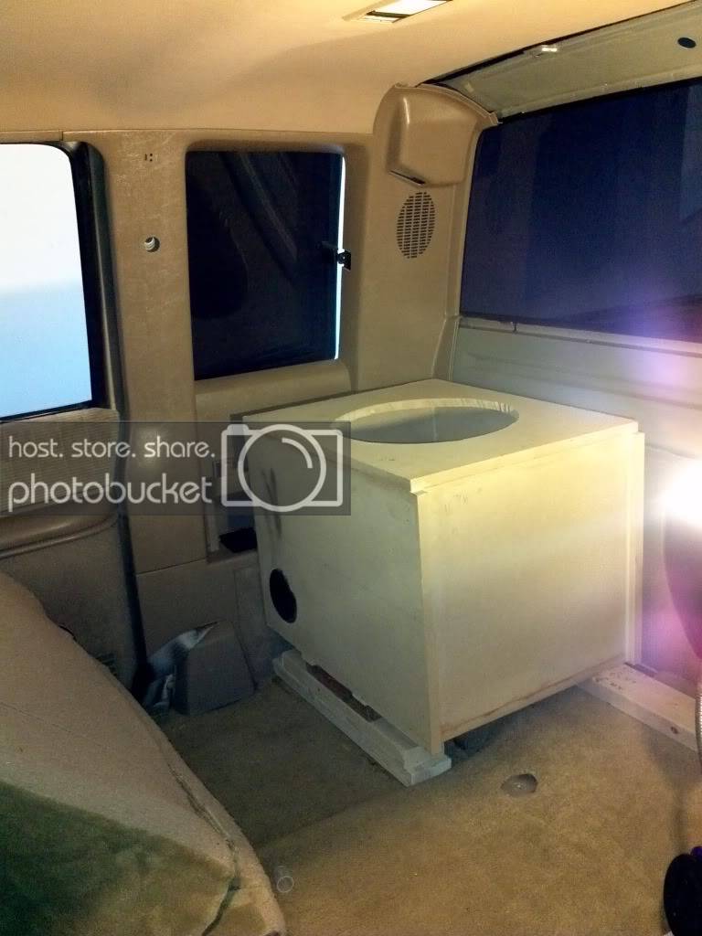

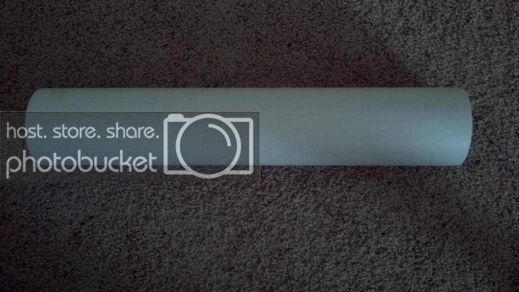

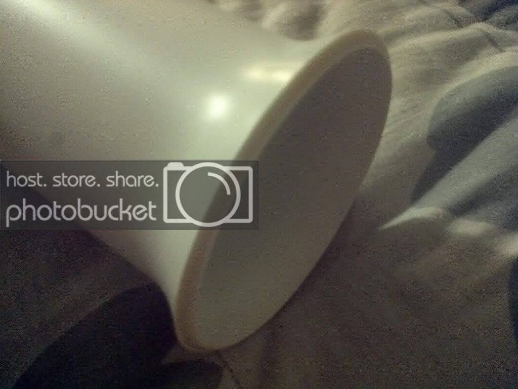

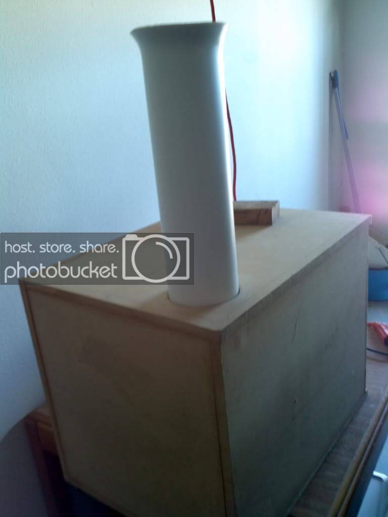

Box Dimensions-
Two separate boxes.
Width: 21.25
Depth: 17.5
Height: 16.75
V: 2.57477ft^3

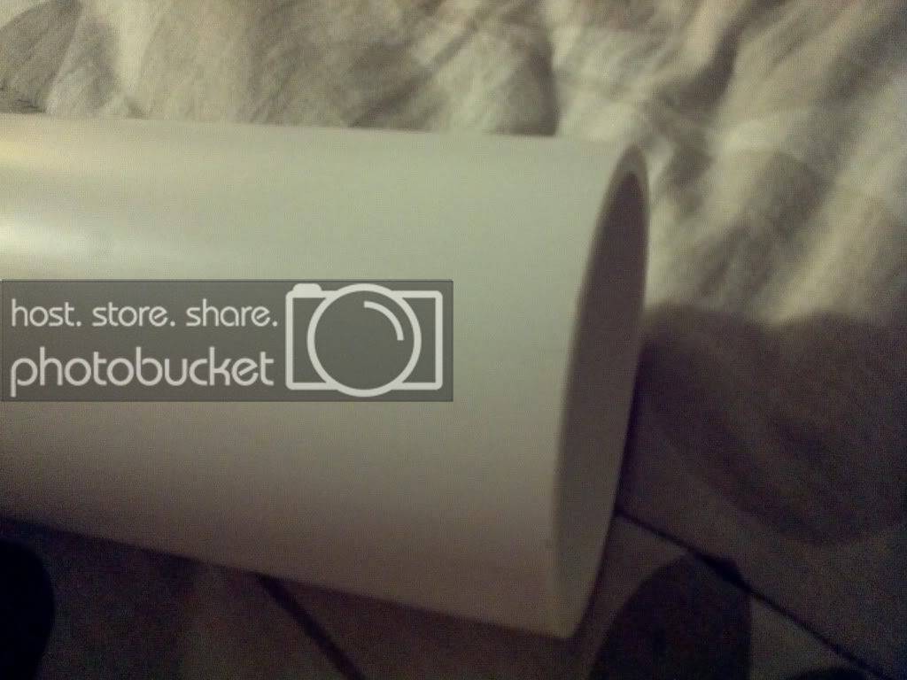

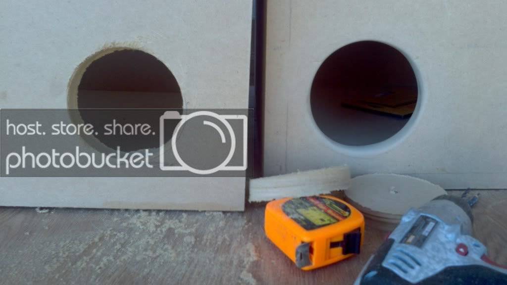

4" aero ports I forgot the exact length apprx. 7"
Tuning to 35Hz
I will post lots of pics!

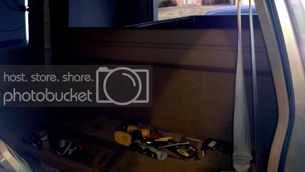

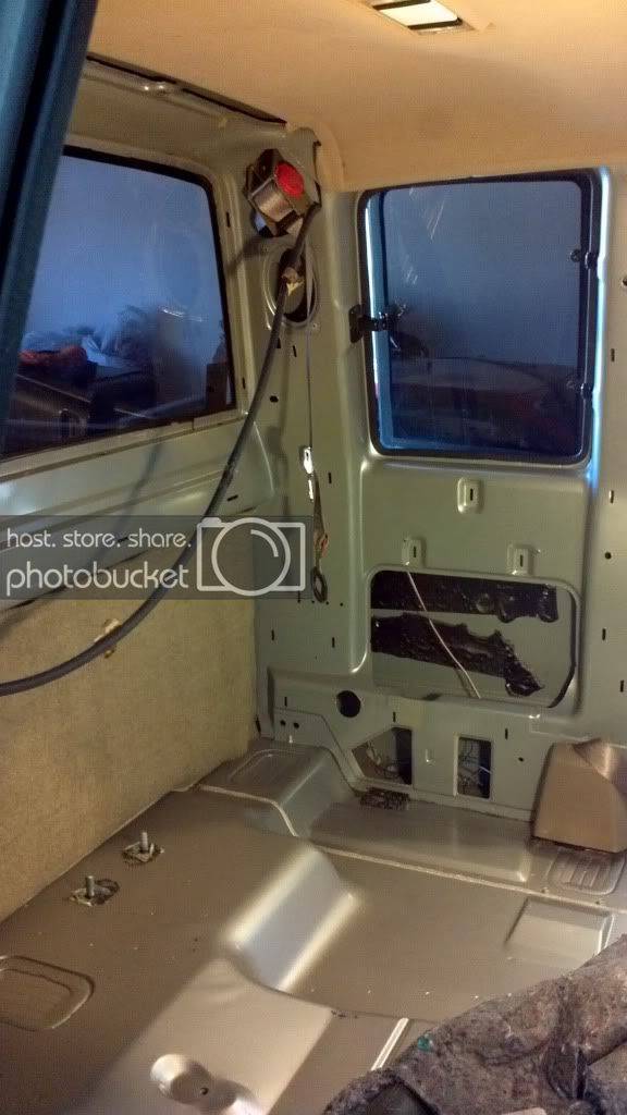

Due to time constraints I will devote saturday evenings to the build and try to get updates that night, currently I have spent a few hours over two weekends on the build.
