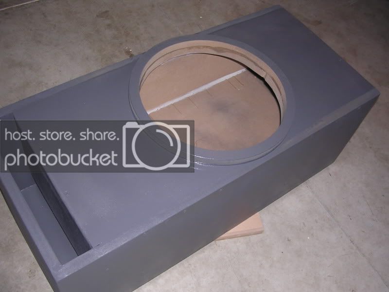

If I could say anything it would be the doors. I know I'm not there to personally listen to your system but I would bet deadening those front 2 doors would make those Hertz speakers sound even better. +1 for rockin the jigsaw for your cutout and not making it look like the state of texas. Would have been nice to see you design the box yourself rather than go to the good ol' re audio calculator though;)

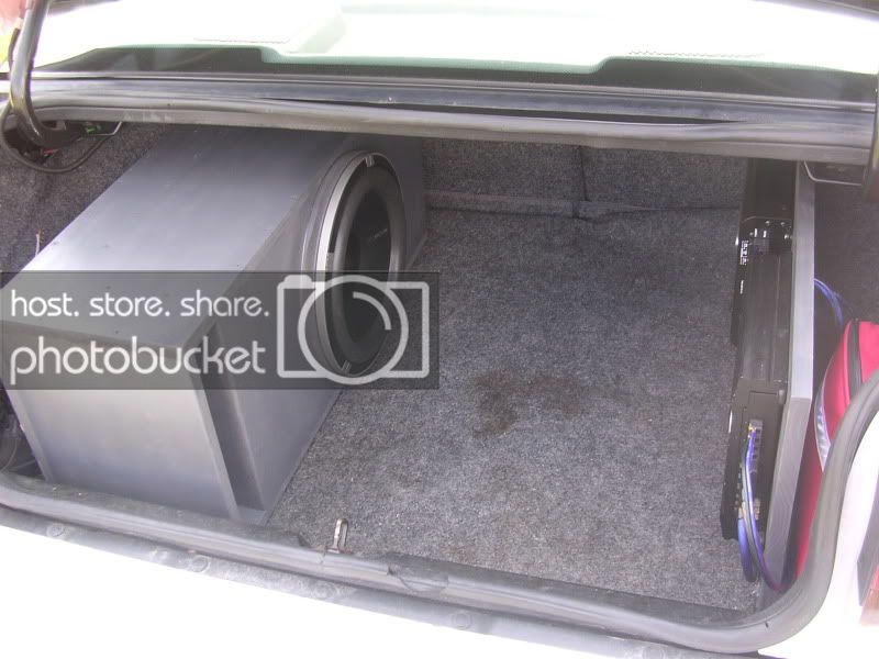

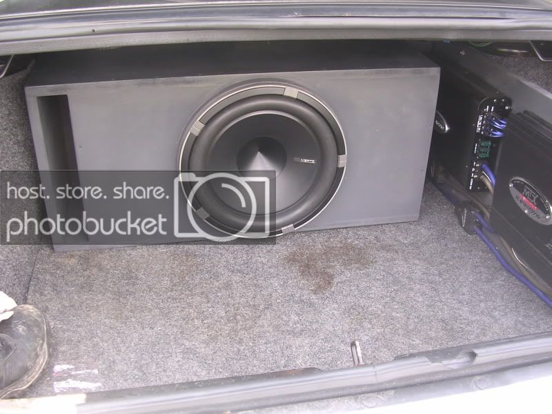

Finished painting the box, hopefully the sub is here by the end of the week. Just gotta get the wires soldered to the terminals and that secured and sealed. You can see I added another MDF ring to give the sub a little more clearance from the back wall.
Well my sub came last thursday while i was at camp, got home yesterday and got everything installed and tuned. It sounds really good. I'll get pics and vids up asap, but i'm leavin today til tomorrow, so after then.

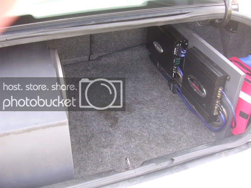

Well here's the rest of my system for now.
I played around with the sub facing the trunk, cabin, and right side. It seemed to be loudest facing the side, and second loudest facing the trunk.
Now none of my friends really have systems, so I really don't have anything to compare mine too since it's really the only one I've ever heard, but it seems to be pretty loud to me, especially for what it is and how much room the box takes up. I set the sub gains to around 700w with a dmm, and even at near full tilt I barely drop below 14v at the back, so that's a lot better than i was expecting. Here's a video, sorry it's not that great it's my first video but feel free to leave comments.
