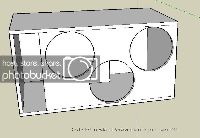

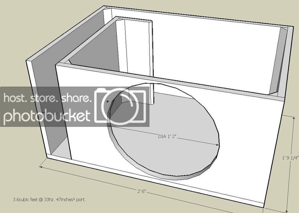

Box plans ( one for my box and the other was for 3 12" Type R's for a guy locally i thought i'd include that build too)
http://i250.photobucket.com/albums/gg255/dmoorezy/dunitsbox.jpg
http://i250.photobucket.com/albums/gg255/dmoorezy/finalboxforus.jpg

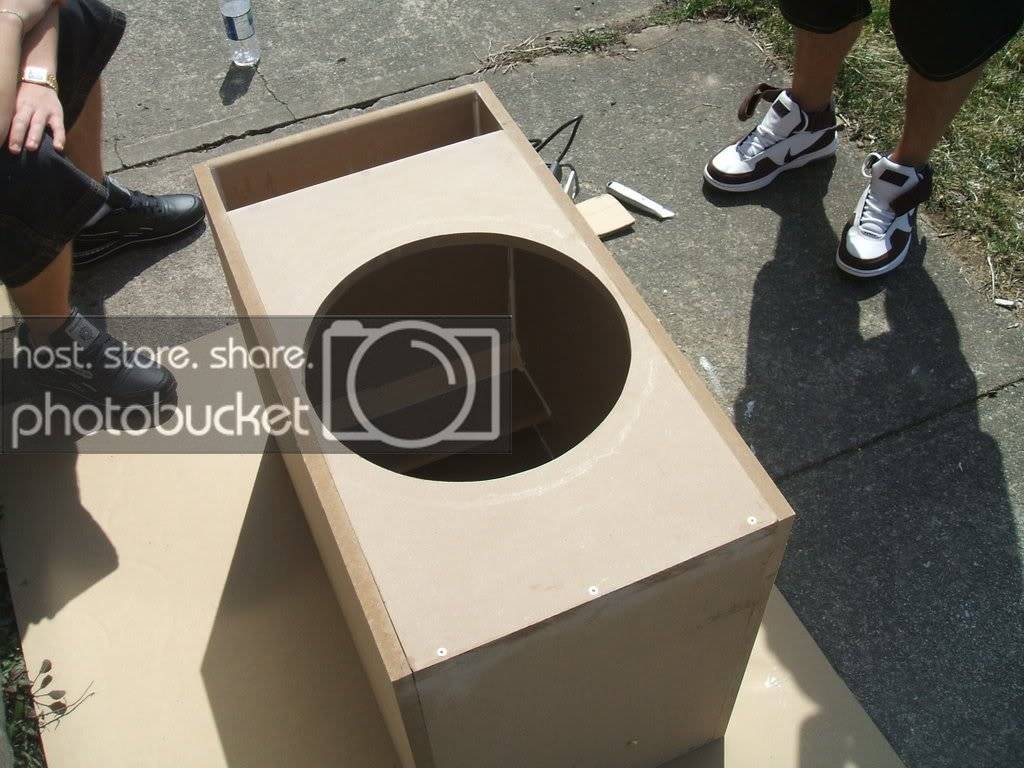

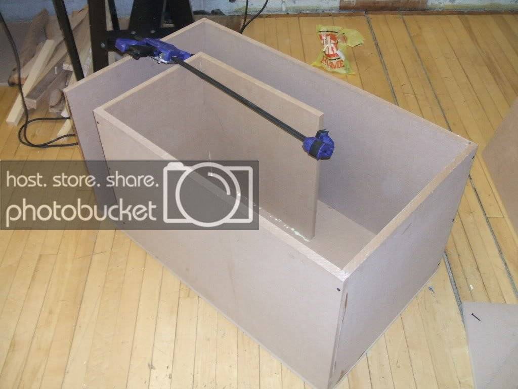

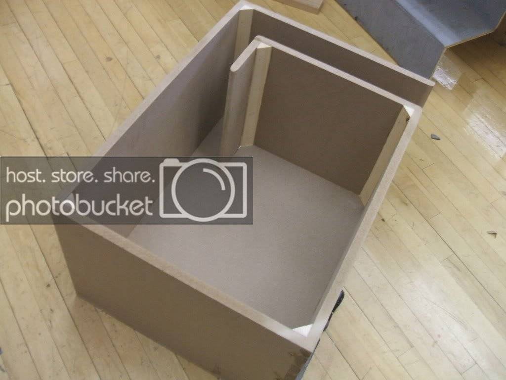

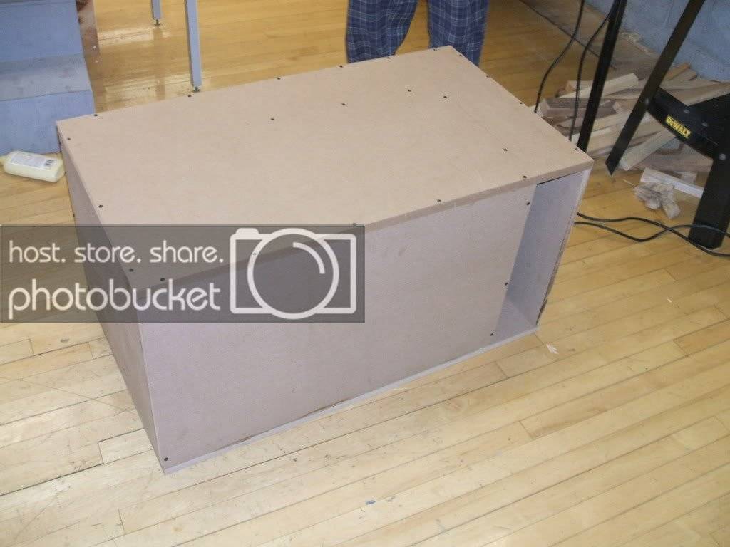

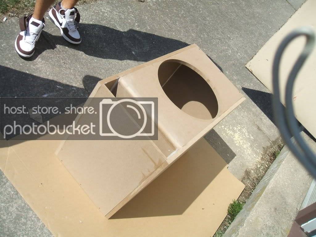

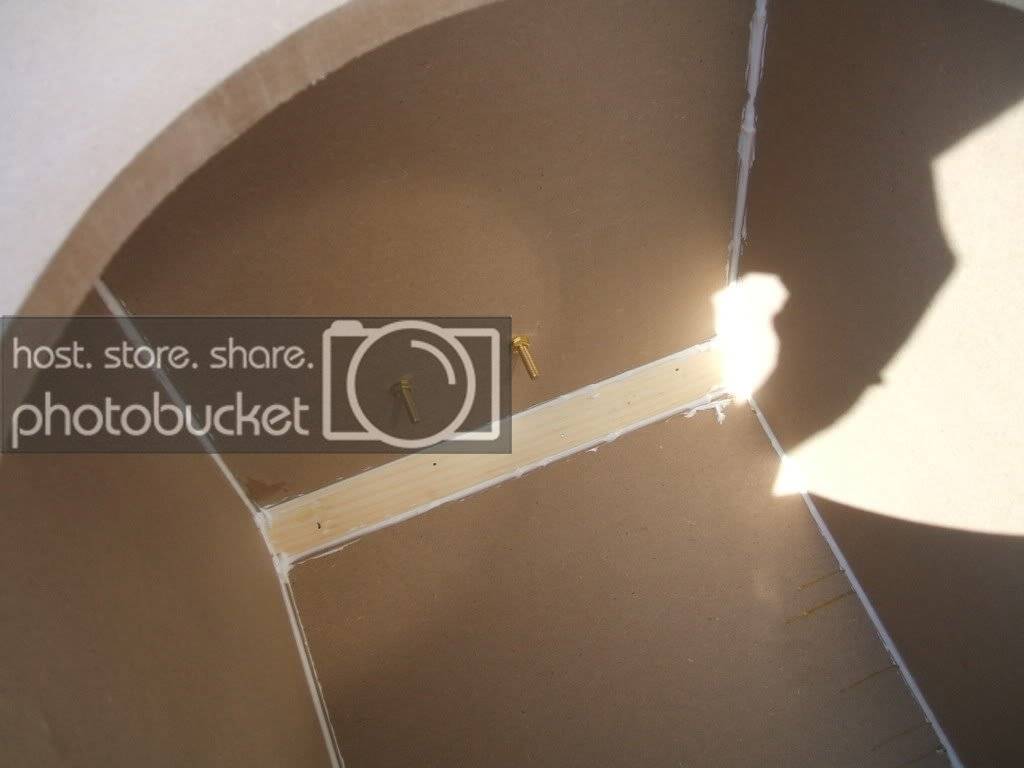

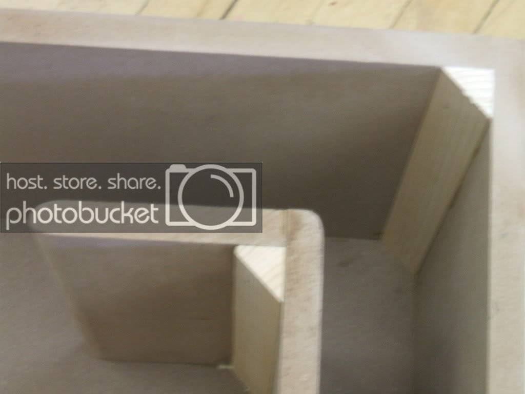

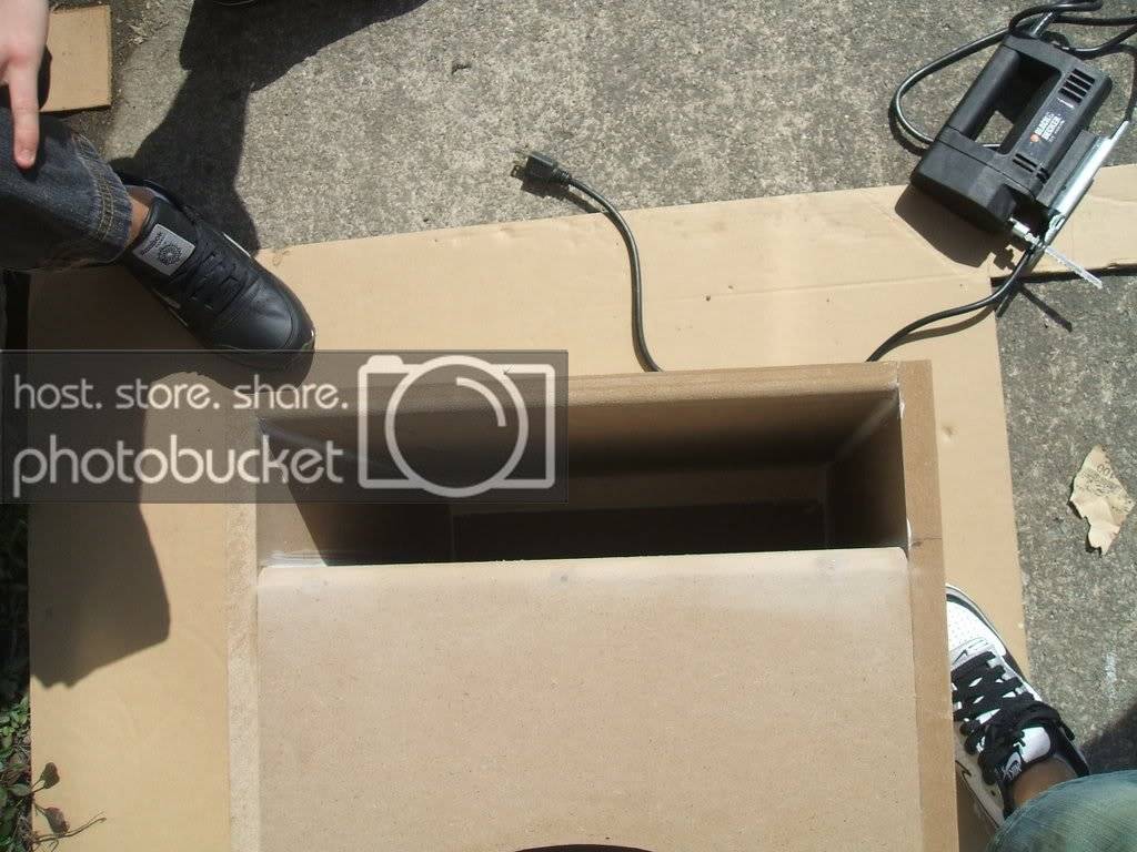

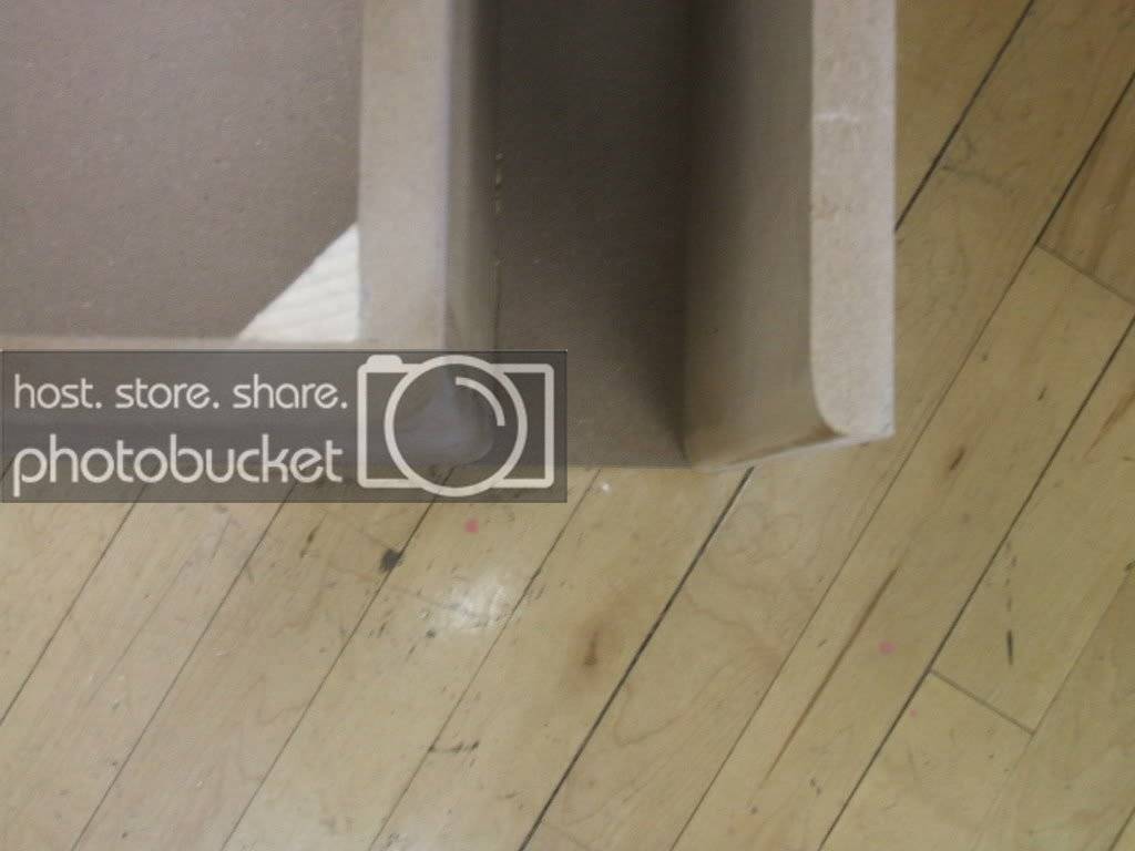

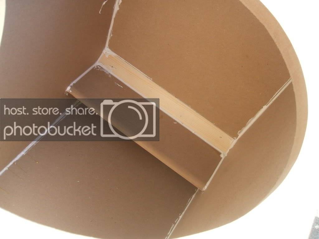

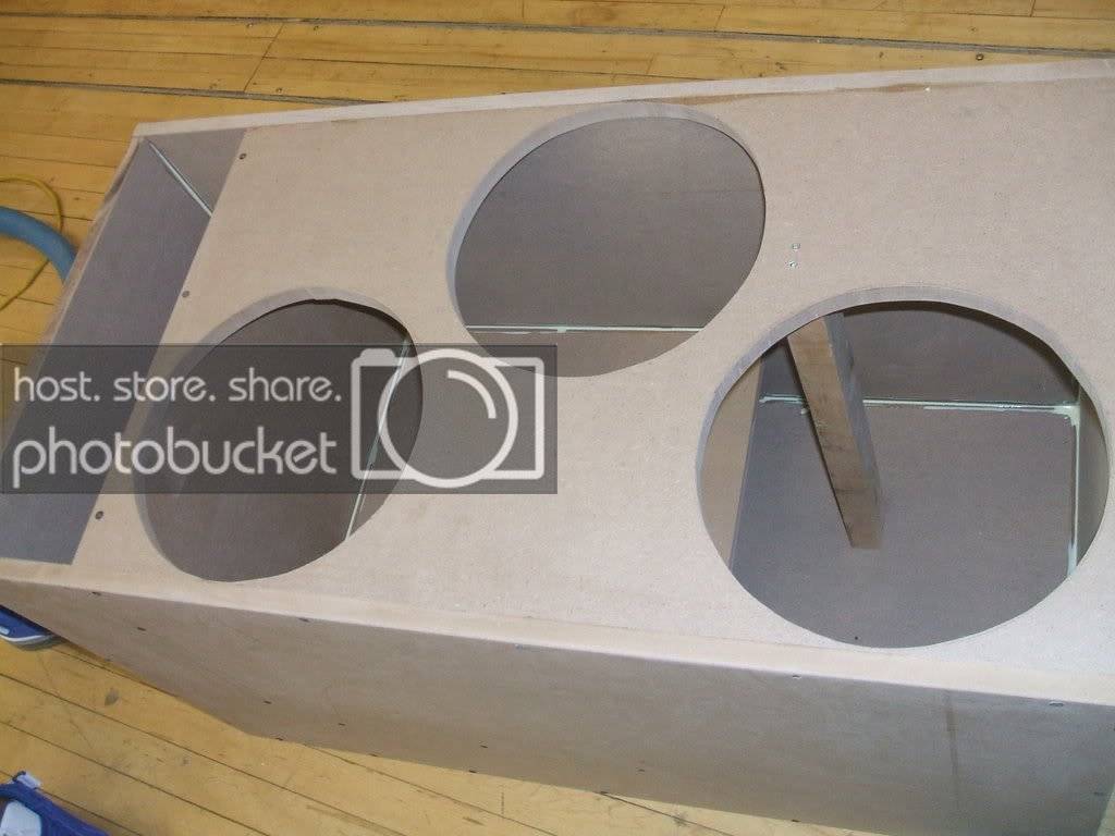

Box builds ( first one for 3 Type R's, second for the HDC315 )
http://i250.photobucket.com/albums/gg255/dmoorezy/DSCF0774.jpg
http://i250.photobucket.com/albums/gg255/dmoorezy/DSCF0775.jpg
http://i250.photobucket.com/albums/gg255/dmoorezy/DSCF0777.jpg
http://i250.photobucket.com/albums/gg255/dmoorezy/DSCF0779.jpg
http://i250.photobucket.com/albums/gg255/dmoorezy/DSCF0780.jpg
http://i250.photobucket.com/albums/gg255/dmoorezy/DSCF0781.jpg
http://i250.photobucket.com/albums/gg255/dmoorezy/DSCF0786.jpg
http://i250.photobucket.com/albums/gg255/dmoorezy/DSCF0788.jpg
http://i250.photobucket.com/albums/gg255/dmoorezy/DSCF0789.jpg
http://i250.photobucket.com/albums/gg255/dmoorezy/DSCF0787.jpg
http://i250.photobucket.com/albums/gg255/dmoorezy/DSCF0790.jpg

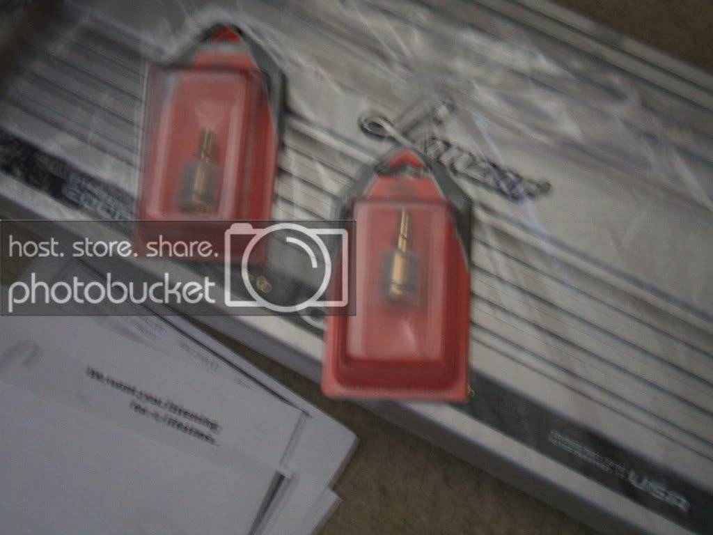

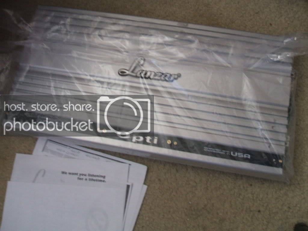

Lanzar Opti2000d w/ reducers ( paid 270 shipped for the amp )
http://i250.photobucket.com/albums/gg255/dmoorezy/DSCF0791.jpg
http://i250.photobucket.com/albums/gg255/dmoorezy/DSCF0792.jpg

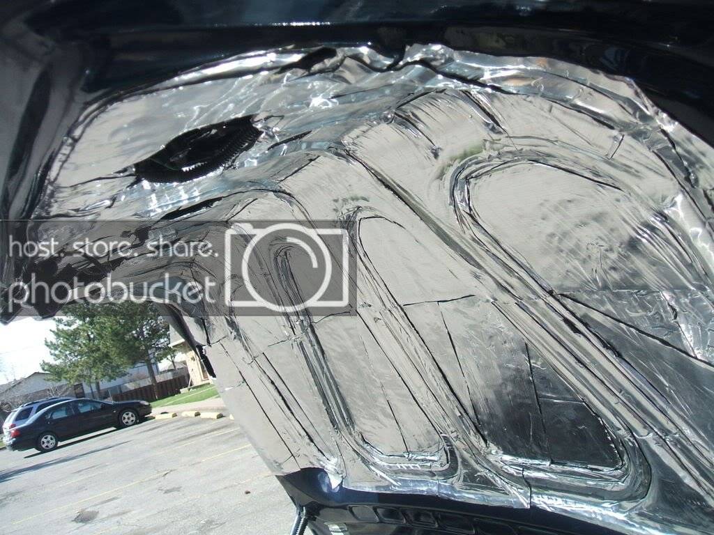

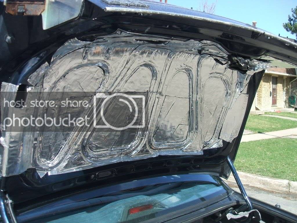

20sq feet of Damplifier ( did 3 layers on trunk lid, whatever was left I put where i could in the trunk )
http://i250.photobucket.com/albums/gg255/dmoorezy/DSCF0794.jpg
http://i250.photobucket.com/albums/gg255/dmoorezy/DSCF0793.jpg

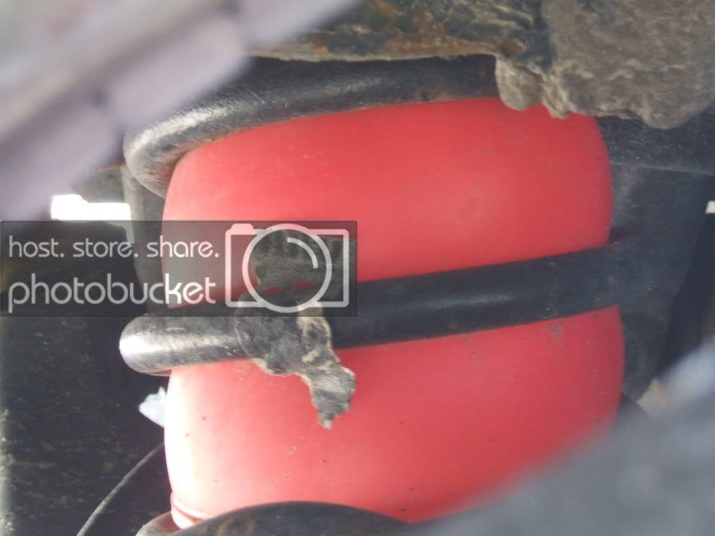

Here are pics of my whip and the Air Lift 1000 air leveling kit i just installed. For 84.99 its a great solution to sag in the rear suspension, especially when your putting a trunk full of car audio. Excellent product.

My car has 175,000 km so roughly 110,000miles its running well actually i have had it almost a year now. I bought with 165,000 km and haven't had to replace anything yet. Runs very well. I bought for 2200 CDN. The paint is nice. There is some rusting in the rear wheel wells but the car is 16 years old. I have no complaints. About the rattling, I hope that it doesn't rattle as bad. Without the mat only the license plate and seal area rattled. The actual trunk was not that bad to my surprise. I really hope that mat makes a difference. I still have to get something for the license plate but i am interested the difference it makes at keeping more bass inside my car. I will get vids when the rest of my gear gets in. Hope that answered some questions. Also i have carpeted the box black.

i put some damplifier on my trunk lid. worked really nice. now i just need something to fix the rattle of the license plate and i'll be good to go.//content.invisioncic.com/y282845/emoticons/smile.gif.1ebc41e1811405b213edfc4622c41e27.gif
yeah something, looks like the taillights are gonna pop out now, crap rattles a little too much. Not even so much the trunk lid( I mean it rattles a bit) but the back support where the taillights are is the thing rattling more then the rest
