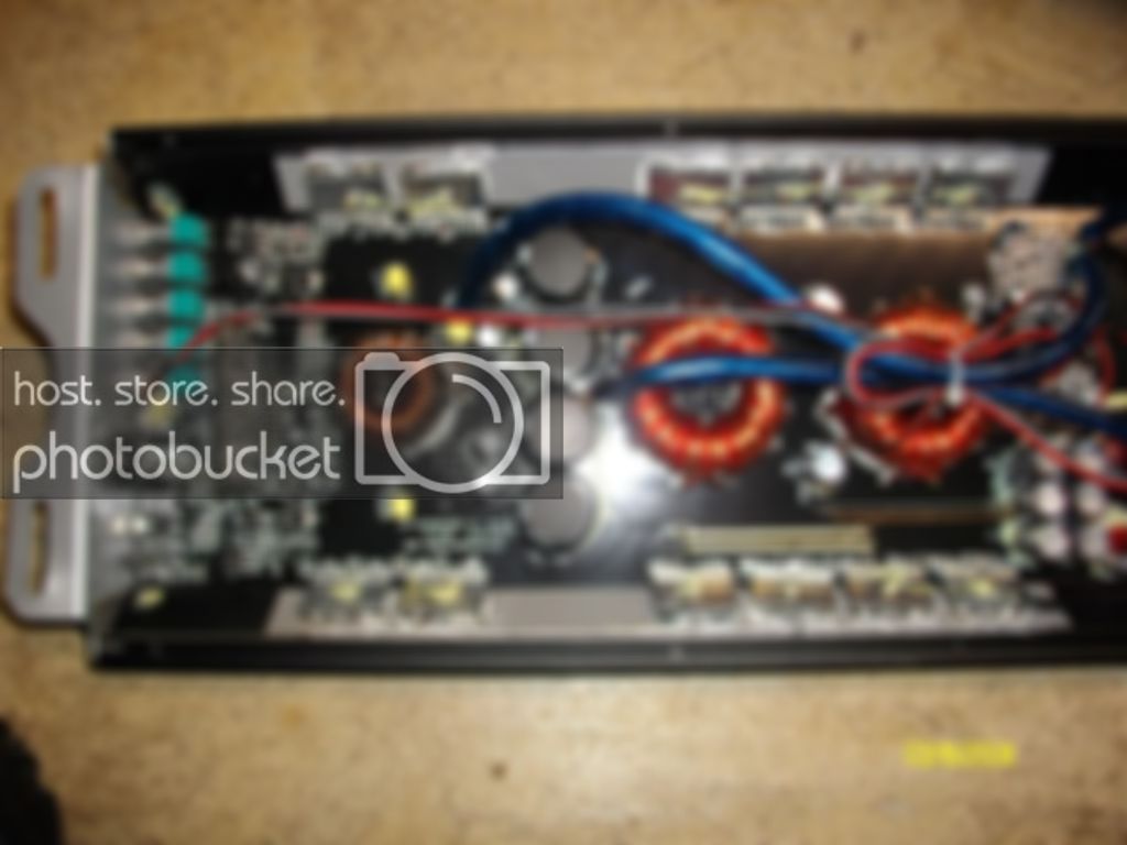

Audiopipe is solid at 1/2 ohm, with proper electrical. Reasoning, the AP-30001d is 2 of these strapped (check amp guts) and is 1 ohm stable. Many others on the forum have had success too. I believe around 2k @ 1/2 ohm.
Guts of the 6000:
Opinions, experiences, etc. are welcome, as always.

the OLD AP amps were solidly built and looked identical to my 20.1 That Solid Audio amp on here would be a good choice.
People have been saying that AP will run 1/2 ohm with no trouble, but the internals are DEFINITELY not the same as an Incriminator Audio 20.1.
AP uses big thick parts, plenty of power supply, and no frills.
AudioPipe Internals
IA uses 4 different types of FETS, and seems to have alot more control circuitry. Definitely an elegant product. It oozes efficiency and stability.

the OLD AudioPipe amps meaning older than that pic. this is closer..not IDENTICAL, but similar...and flipped.
Thanks Doug,
I've seen that amp before, just not the internals. Besides the input caps and the wire winding, it's an identical amp.
I'm guessing that the IA 20.1 has the stronger power supply, but it's hard to tell from the view alone.
Nice find though.
