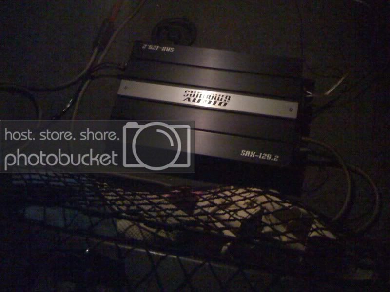

Well i just bought a bnib sundown 125.2 off a member here on the forum and it got here yesterday and just hooked it up today.
its running at 2 ohms on each channel to two pairs of orion hcca 1" silk domes.
i have the gain set only to about 1/4 and they are very loud.
however after hooking them up and rolling around for about 15-20 minutes i got back home and popped the trunk the amp was so hot i could bearly touch it.
any input?

its just mounted right in the middle of the trunk, im still waiting on my 40.1 to get here to make a amp rack for both of them...
