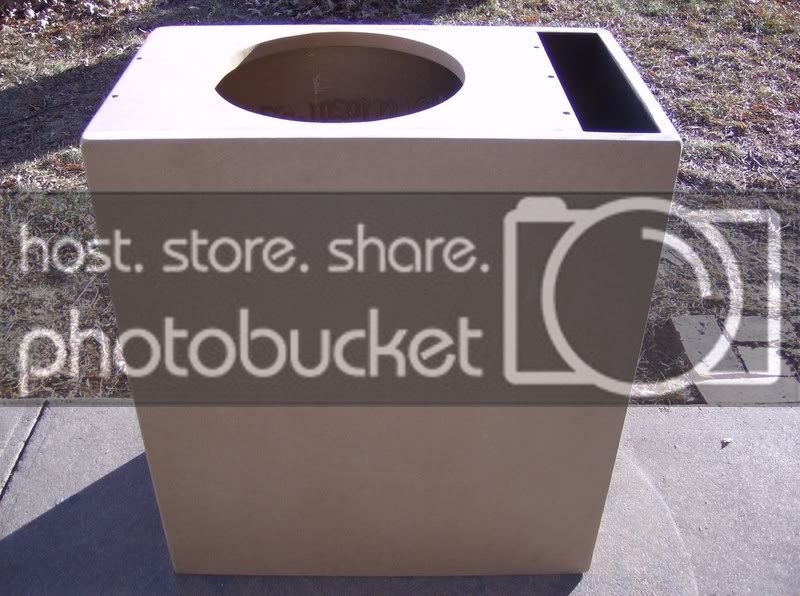

Here is the box build for my fi q. Sorry I didn't take any pics while building, as I left my camera at home while building at a friends house. I haven't loaded the sub yet since it is sitting under the Christmas tree taunting me.
Specs on box:
2.5 cubes net
Tuned to 30hz
36 sqin of port

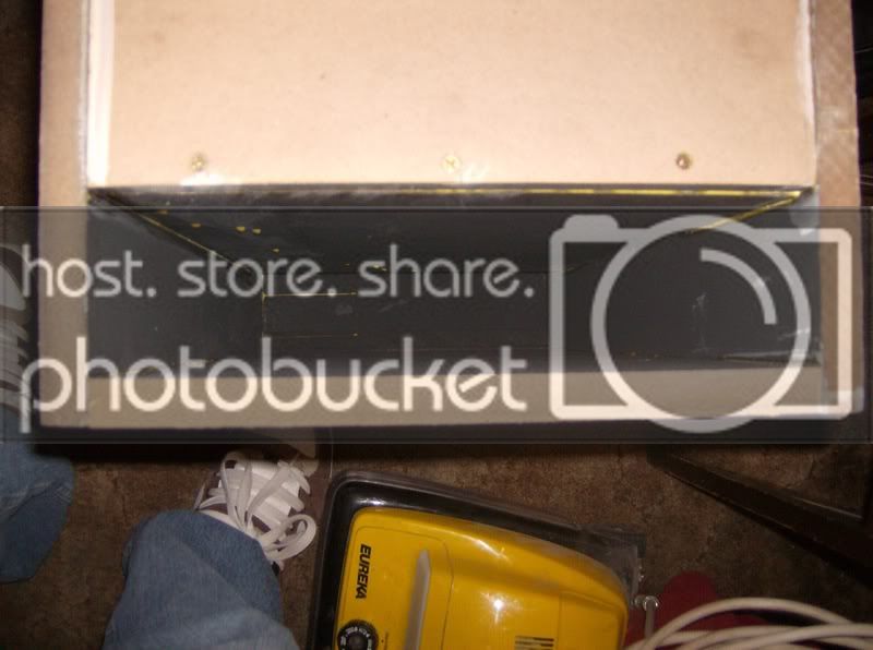

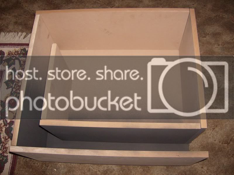

Dry fit of pieces. The inside corner wall of the port was also rounded, but I did not have it done at the time of the pic. There is also a 45 degree corner piece on the outside corner of the port.
Rounded port piece

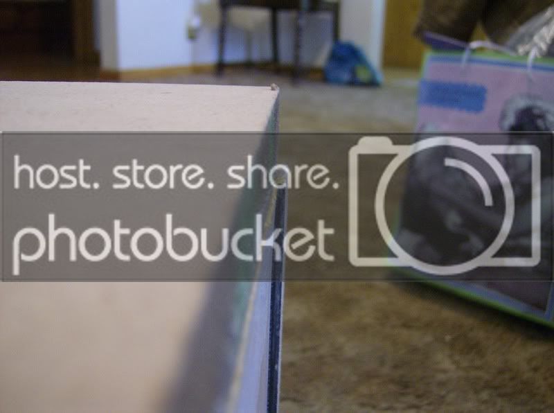

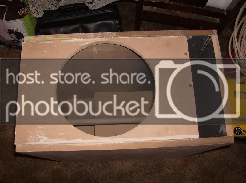

Dry fit of top

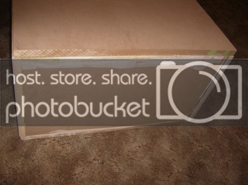

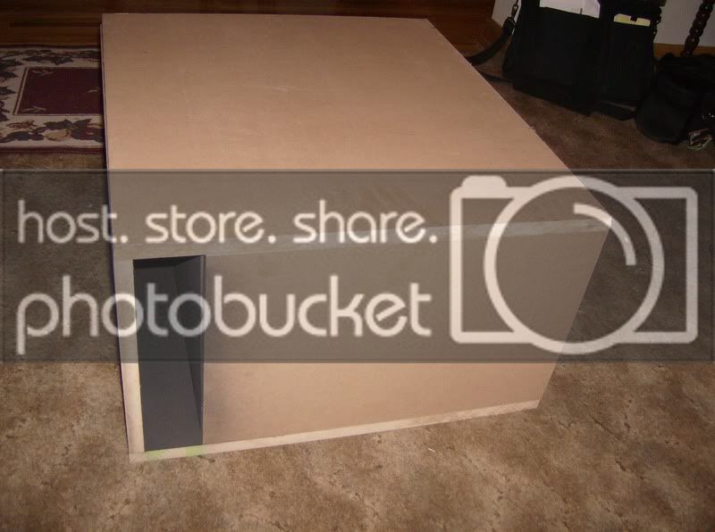

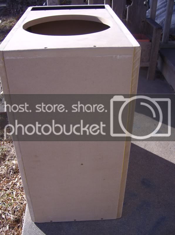

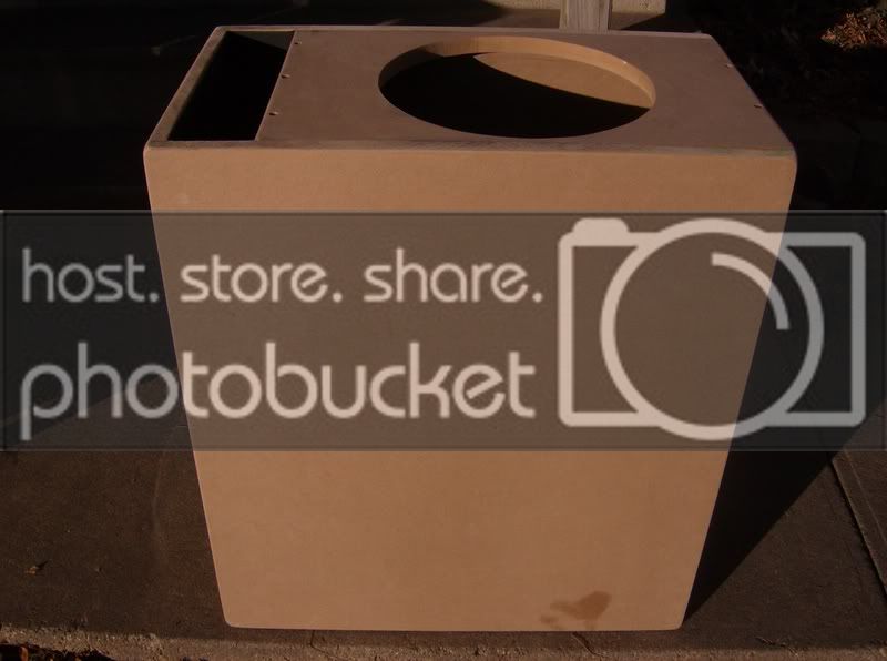

This is what the box looked like just after construction. UGLY.
Home depot cut my wood so this piece ended up being about 1/8" too long. Not to worry as it was cut off later as you will see.

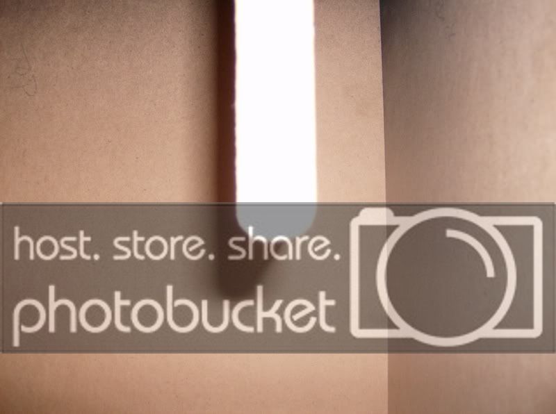

Port before finishing.

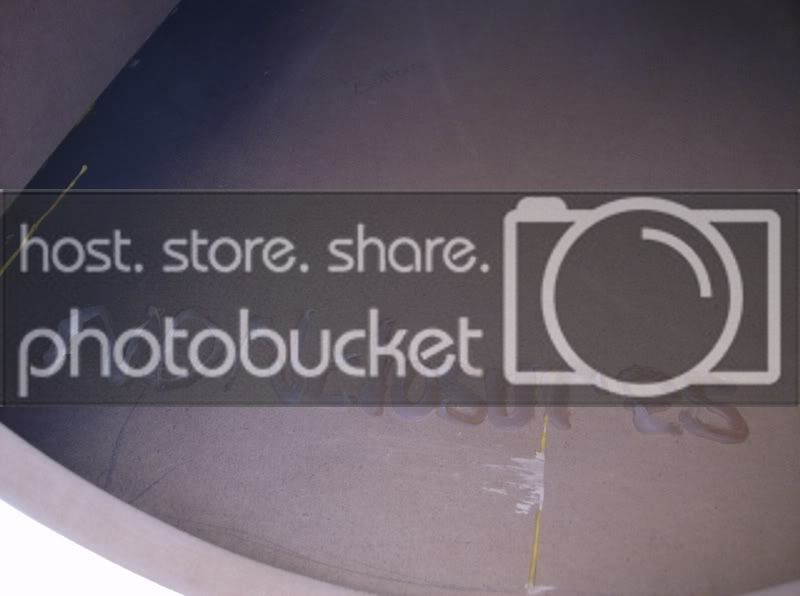

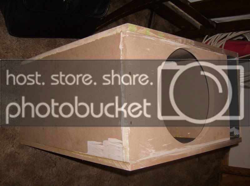

Another pic of the box unfinished.
Excess glue FTL.

Pics of after the port was re-painted and all the excess glue was sanded down.

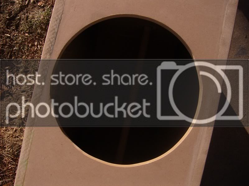

Almost perfect cutout done with a jigsaw.

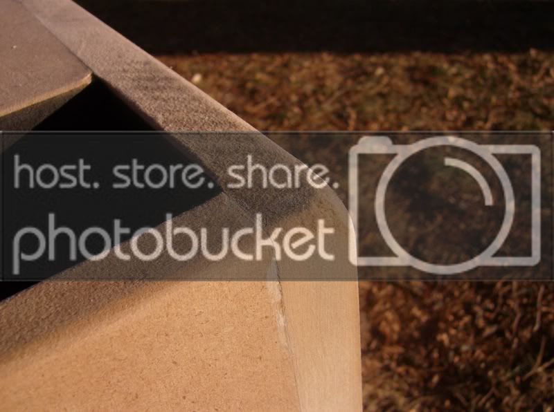

Rounded corners and outside edges of the box

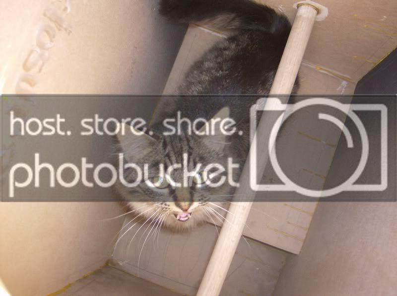

Cat pwnage
1" wooden dowel bracing

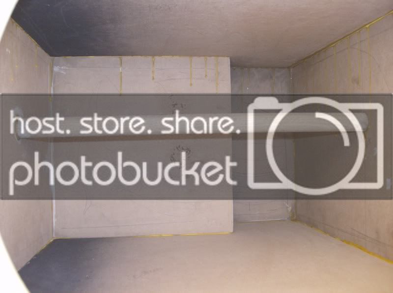

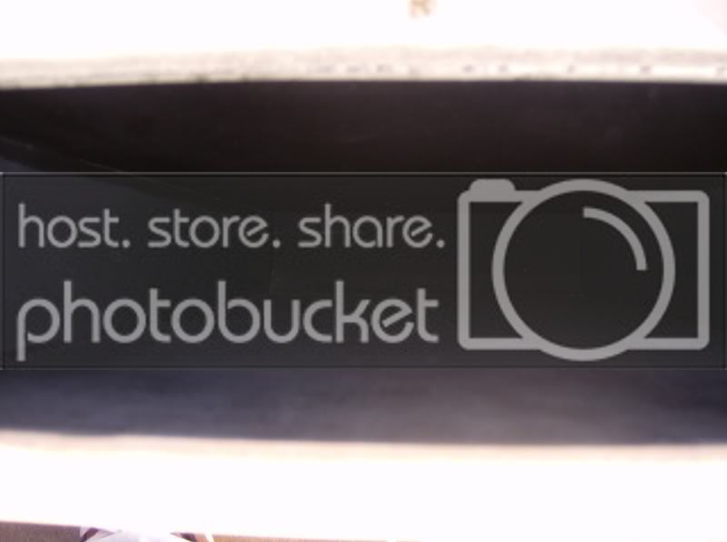

A look inside the finished port.

That looks great. Should be louder than poop. Oh leave the cat in there, I think large ones can account for gains up to 2dB!
We have about 10 cats running around our acreage, should I throw a couple more in for good measure? And how loud is poop exactly?
