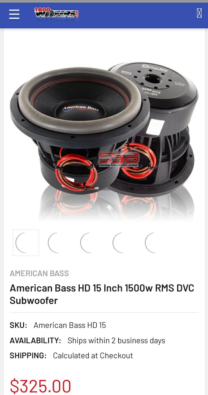

Well now you are changing you parameters. 4-AB HD15's could get you close to 160 if built right. The Hippo XLR's are no joke either. The 8's are still hittin'. We did a 148.9 @ 31 hz. last week. I'm upgrading from an 18 ah bank of Lishen lithium to a 40 ah bank of XS Power this week. We're also installing a new mids/highs amp (Crescendo S4) and some new Deaf Bonce 6-½" mids in the doors that will be replacing the 6-½" Infinity Kappa coaxials.

I've seen and felt 4 AB HD15's top 160. $1,300.
